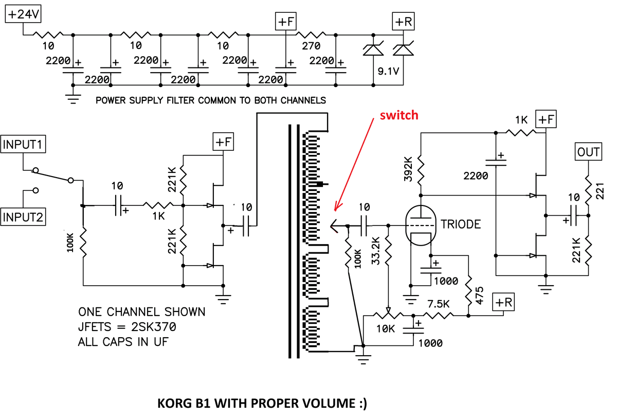

I will get my head around these a little more to help with any decisions to be made when I finally have my own model produced.
I posted this before ..........
if you take a peek at my Iron Pumpkins - there is a buffer in front of AVC, nothing after, so - AVC on output is regular thing
though, in case of KB1 - as I drew that (in post #4939) everything is as it need to be - AVC is having buffer in front, attenuator is in front of weeny toob and buffer is on output
toob must have attenuator in front, whatever sort, or it will be instantly overloaded

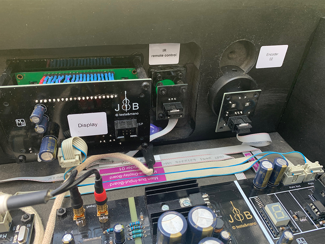

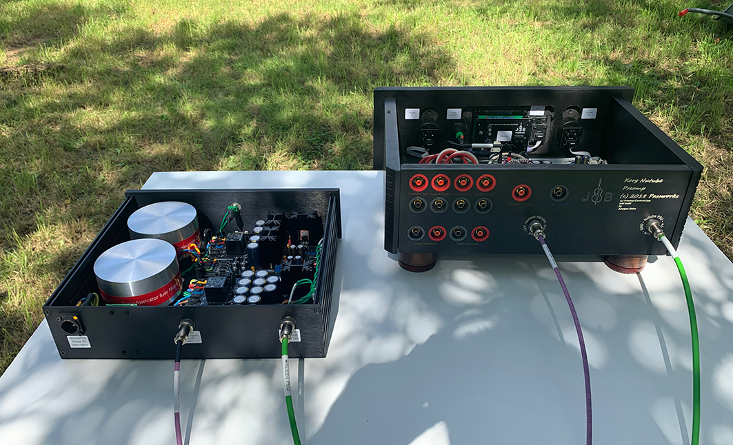

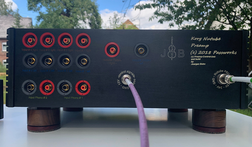

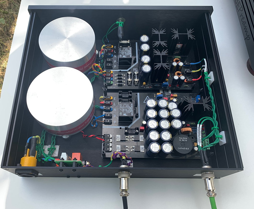

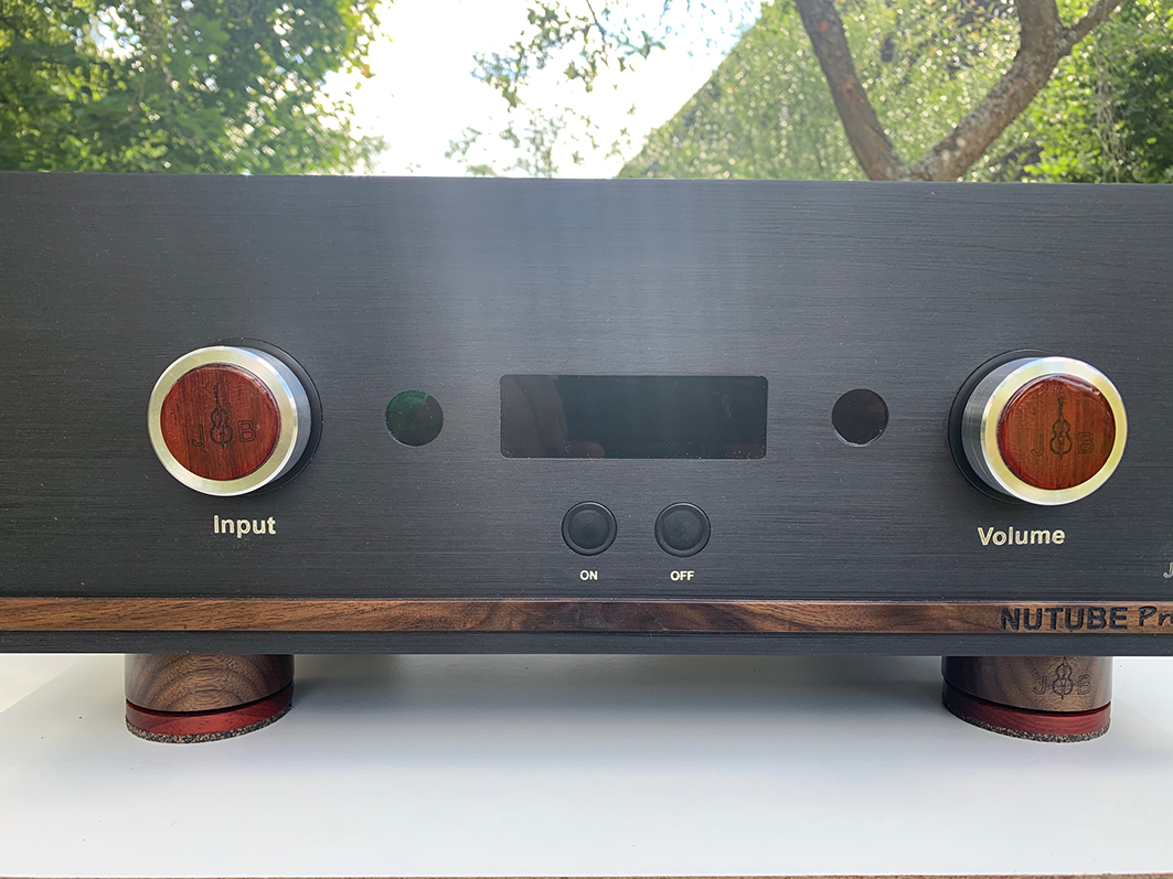

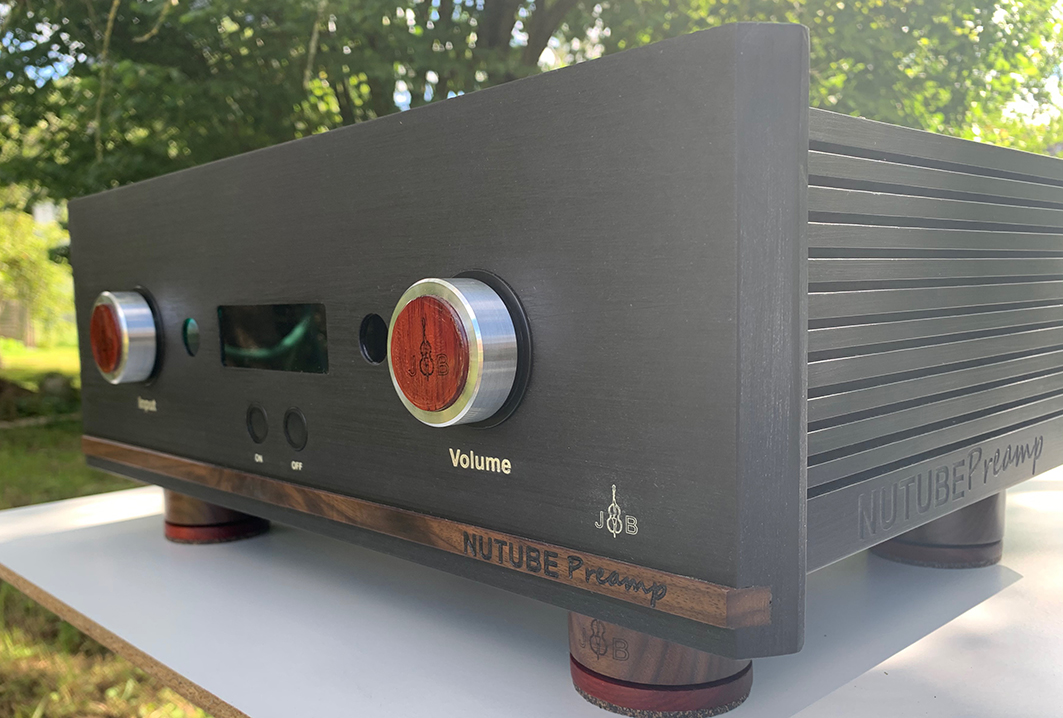

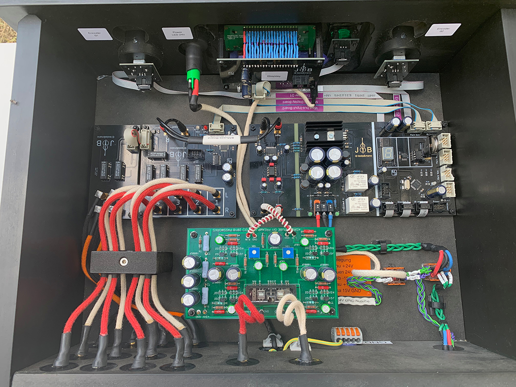

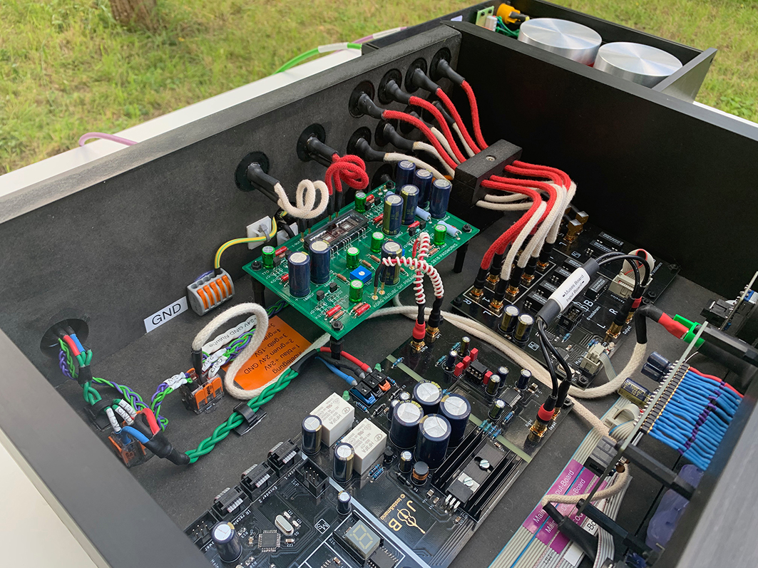

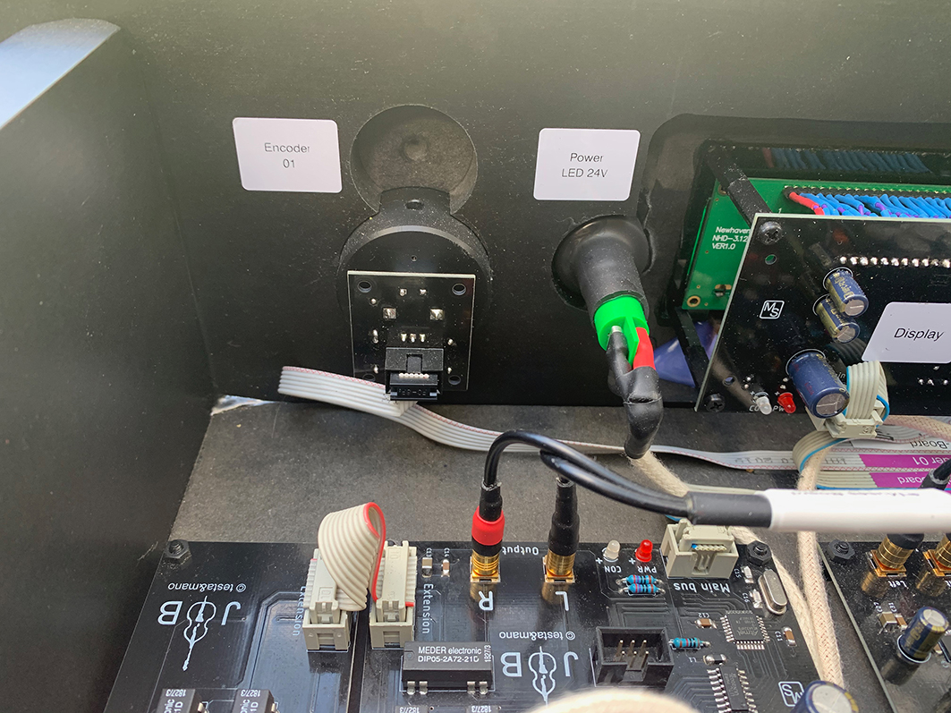

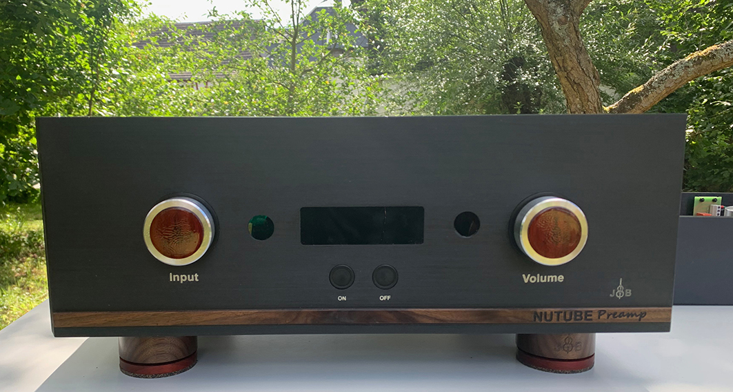

nutube preamp is ready
on the last weekend,
what belongs together finally came together.
I had finished the feet for the preamp, the control knobs and the rest of the chassis parts,
the encoderboards as well as the display!
the assembly went quickly, and everything was right.
here I have some pictures of the complete preamp,
with the external power supply.

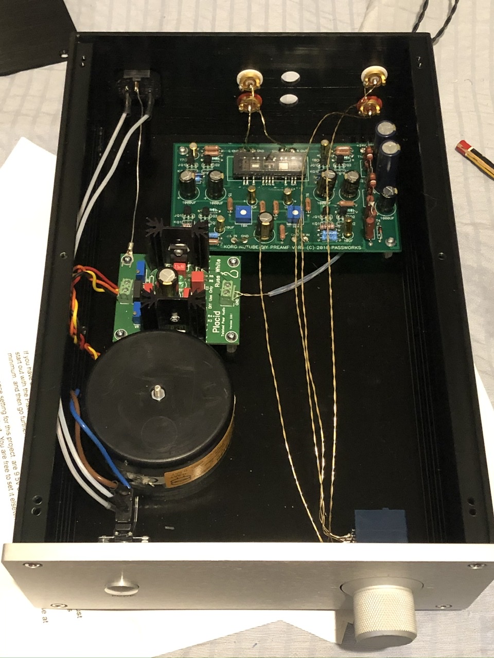

I am interested in this build, awaiting the full kit from the store:
