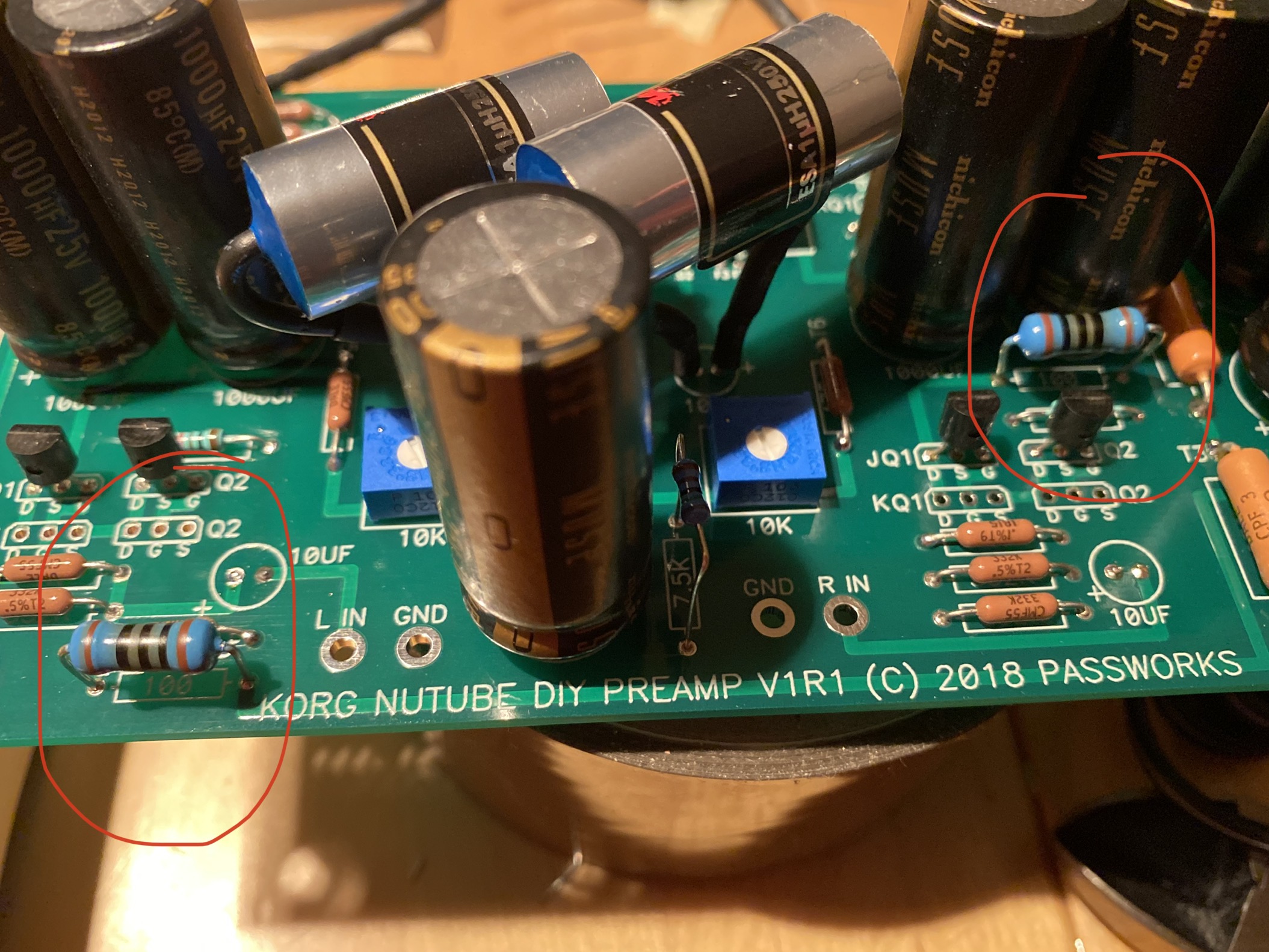

Hello to the forum! In the Moment I’m trying to build this nice little machine. Today I finished the Power section of the board. My problem is that I now tried two NEW wall wart power supplies, but they deliver 24,9 and 25,1 Volts so I get 9,8 and 10 Volts at T4. Is this a problem? Should I search for a better one?

Dear Mr Pass, thank you very much for your answer. I’m Shure I used the correct Values, a Vishay CMF55 270Ohms 3W and a Zener Diodes 9.1V 1W Zener Diode.
I will now build the rest of the board and test again. Maybe the values will change a bit when the power source gets a real load. If it does not work I will get back to the forum for sure. If it works too
Now I really need your help. I now completed the board but I can’t get it to work properly. The Triode does not glow. My measurements are:
T1: 25,5
T3: 18
T4: 8,7
T5: 0,6
T6: 0,6
T7: 1
T8: 1
I have no clue what is wrong. The only thing that bothers me is, that the two 100Ohm resistors get really hot:
attachment.phpattachmentid=859928&stc=1&d=1594503574
What’s wrong? Could anybody help!
Best regards, Seb
