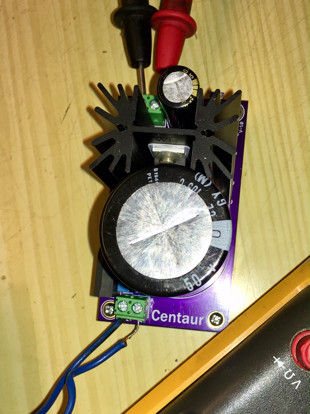

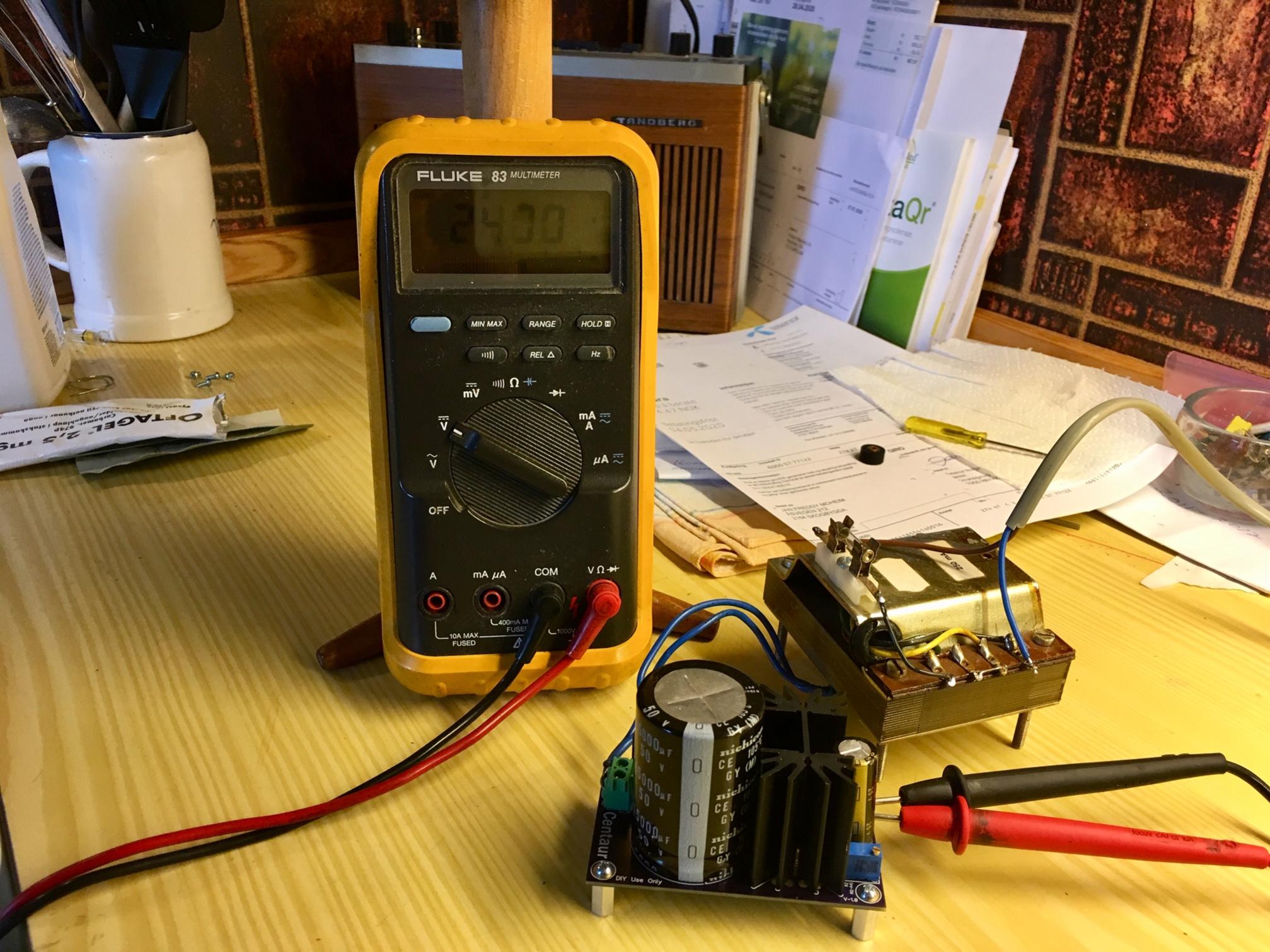

Powersupply.
Hi, we have tested the regulated powersupply from Twisted Pears + 23vac transformator ( Radionette from the 1960s ).
It is spot on 24.00vdc.
Hear that people have getting their printboard and Nutube.
When is the complett kit ready for us customers?
Frank
