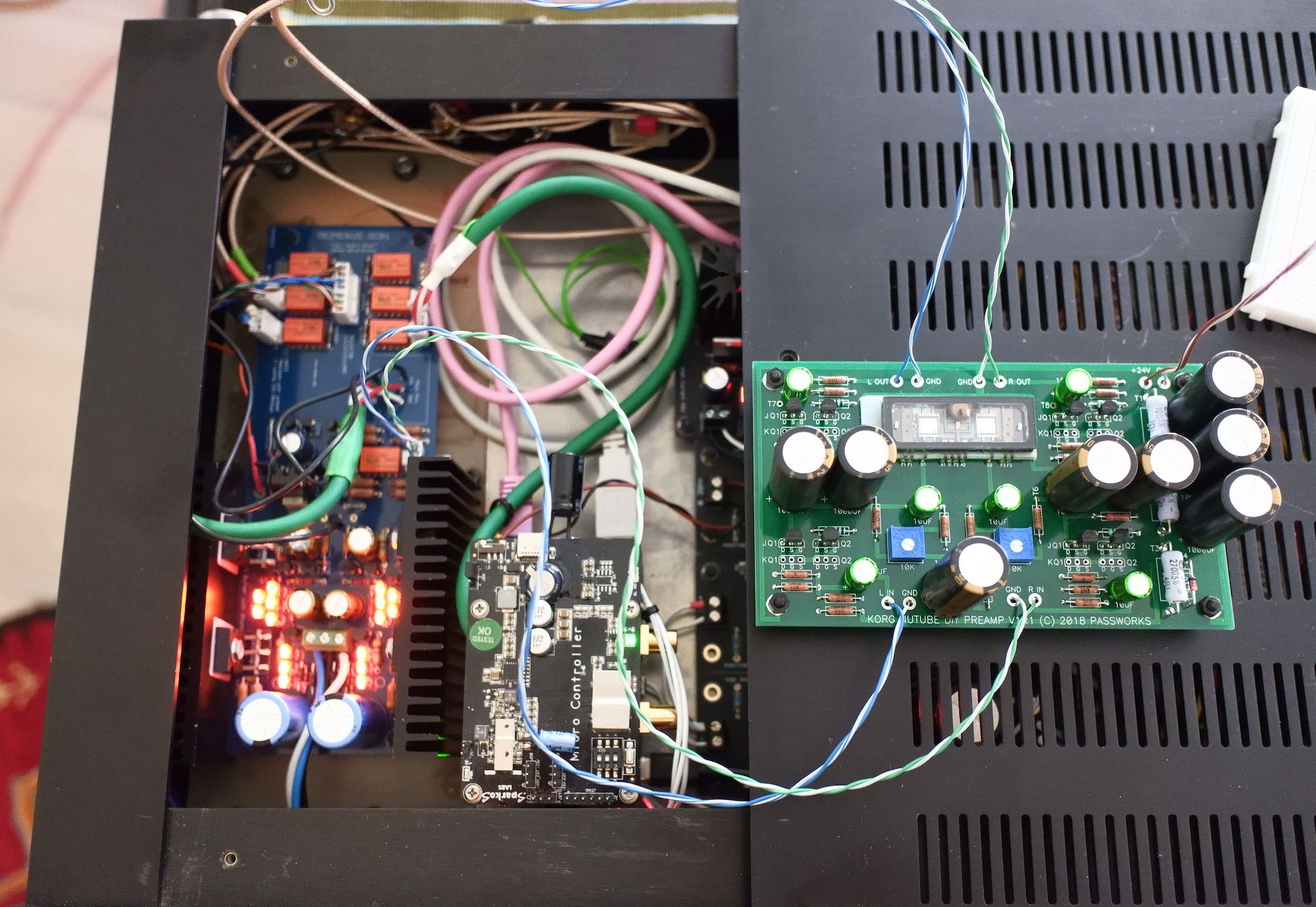

Just finished my B1 Korg Triode!
Sound is great, fed from my Allo Katana DAC (powered by Salas UBiB shunt regs), through my Salas Mesmerize DCB1 as input selector/buffer, and the B1 Korg serving as input buffer for my F6.
