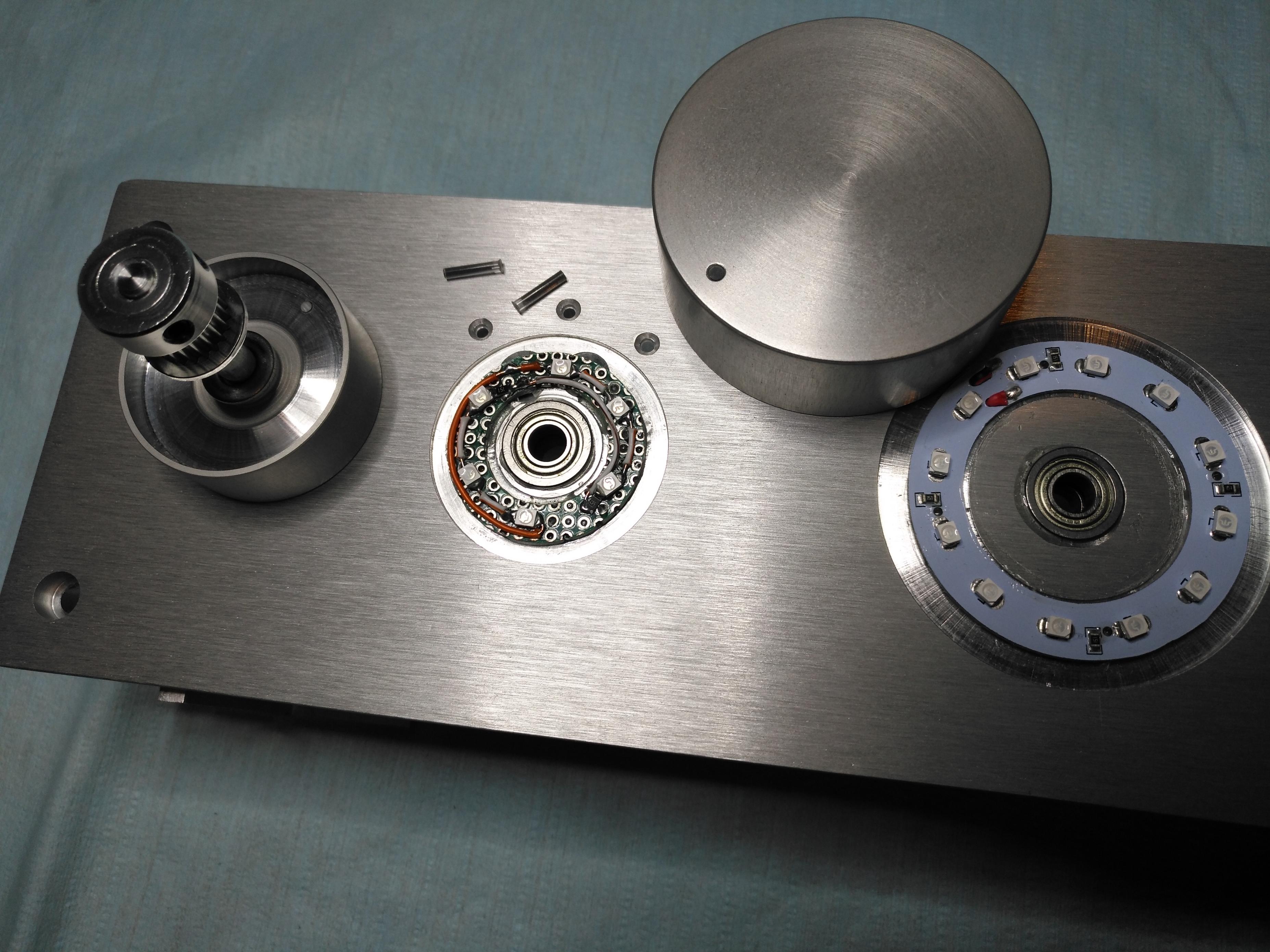

Is that from a kit or something you created?
Hi brian92fs,
I bought a kit for 3d printers on Amazon, consisting of 8 pulleys and 5 meters of timing belt.
Then I had to rework it on the lathe, threading and boring the holes on the pulleys for the 6mm shafts and to adjust the fixing of the knobs on the bearings of the front panel, so as not to have off-axis movements. Then cut and join the timing belt.

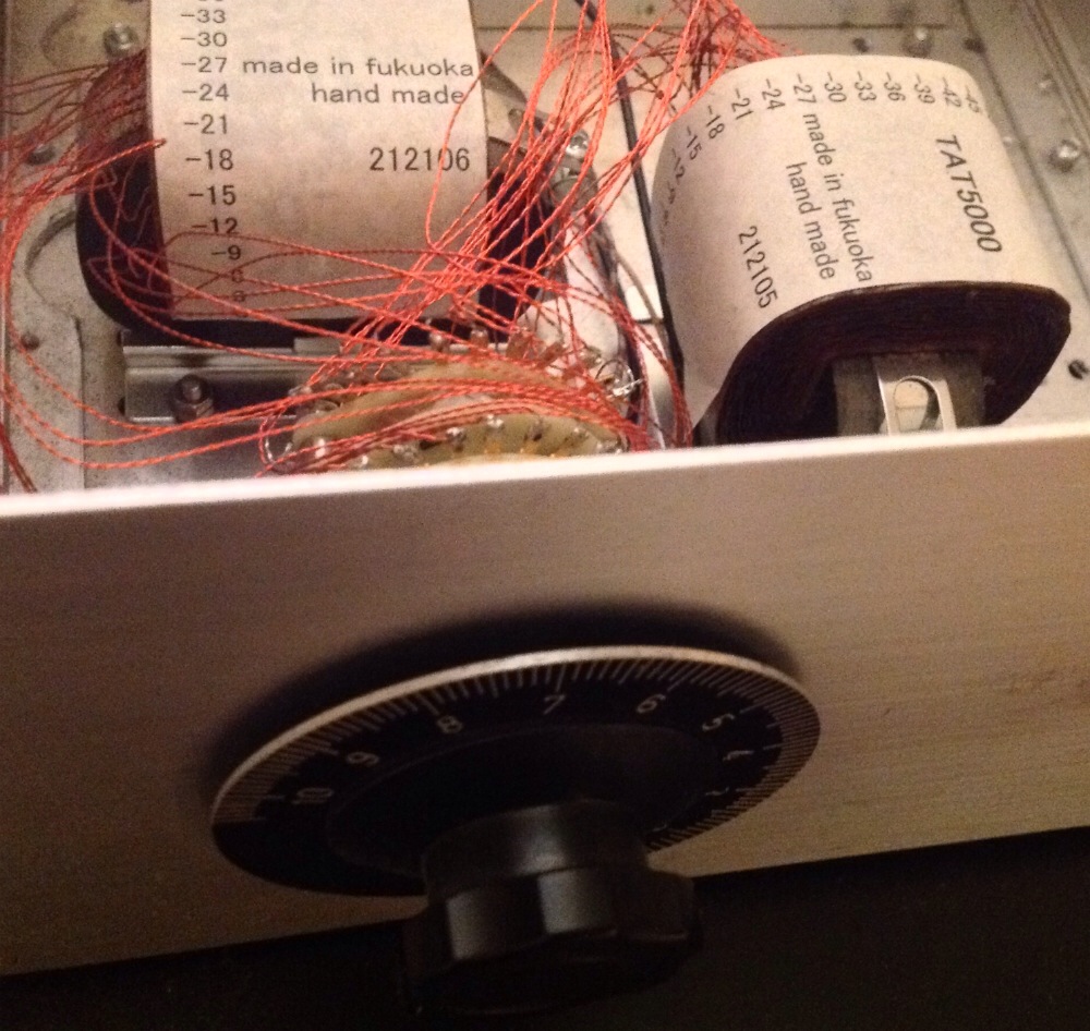

Interesting compact alternative to autoformer volume control I use in the other gear.

TVC always intriguing me, not just because of Luxman, should also give it a try one day... so many things to try ;-)
Soundhappy, looks like your treasured B1 Korg will be kept in... a safe 🙂)
😀 Yes B1K is a treasure :treasure:
My AVC + Elma etc. total cost ~ 500$.
Need jfet buffer as well..
TVC of good quality is hard to make and can be x2~3 times price of
