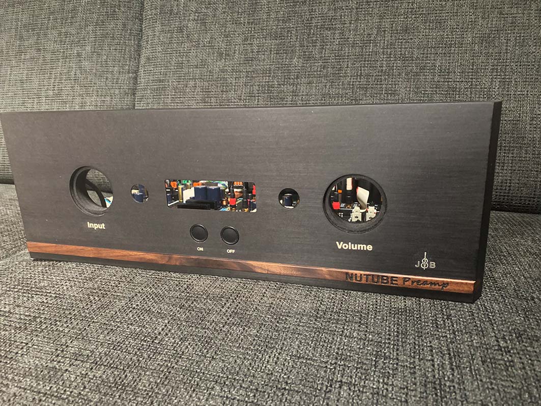

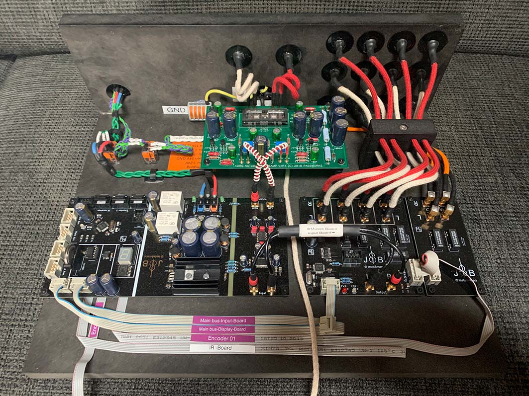

I developed a Muses Volume and Input selection module
and build it into my Korg Nutube Preamp.
I called the whole module „PCU“ Preamp-Control-Unit.
In the photos you can see the structure of the preamp.
On the left the muses and digital board. On the right the input module with four inputs and next to it an input-expansion-board with two inputs. The PCU Modul is controlled via two encoders, alternatively with an Apple remote control, in the future also with an IOS app. I’ll make a description of the „PCU“ and post it here. I think I need a day to do that, so I could post the description here tomorrow, Sunday.
