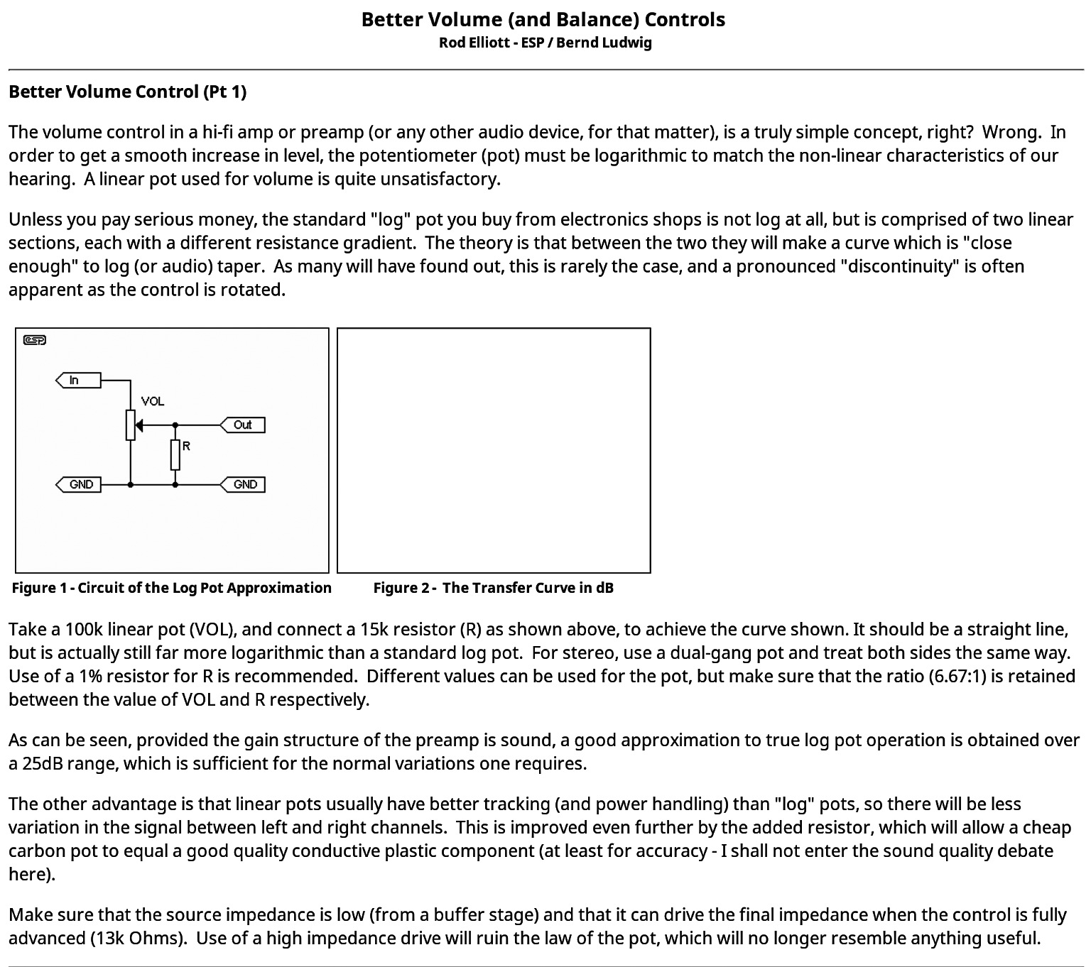

Linear and logarythmic pot don't follow the same attenuation curve hence one sounding louder than the other and angular progression from the operator leading also to different volume progression.
Log pots are prefered in audio because human beings perceive sound loundness more in a log way... why did you go for a linear pot?

To add to this, audio taper can be different than logarithmic taper. An audio taper tends follow the log taper until you get close to the "mute" point. Then the rate of attenuation increases faster than a strict log taper. I believe the implementation of this can vary between manufacturers.
I installed Tocos potentiometers RV 30 YN B 50K (linear),why is the sound so high at the beginning ?Alps blue 50K (log) voice is much lower.
With two resitors you can make stereo linear potentiometer react in more logarithmic way.
You need experiment and find resistor value..~ 7K5 ?
but is simple parallel connection between point 1 and 2 of the potentiometer.
See in Rod Elliott article extract Have fun
Douglas Self also discusses this in his Small Signal book. He seems to be less enthusiastic about it than Rod Elliott. He indicates that the range over which it simulates a log taper is small (20 dB or so).
But, it's simple to try out if you already have the linear pot.
