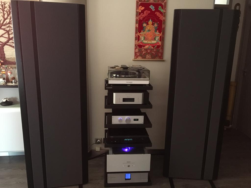

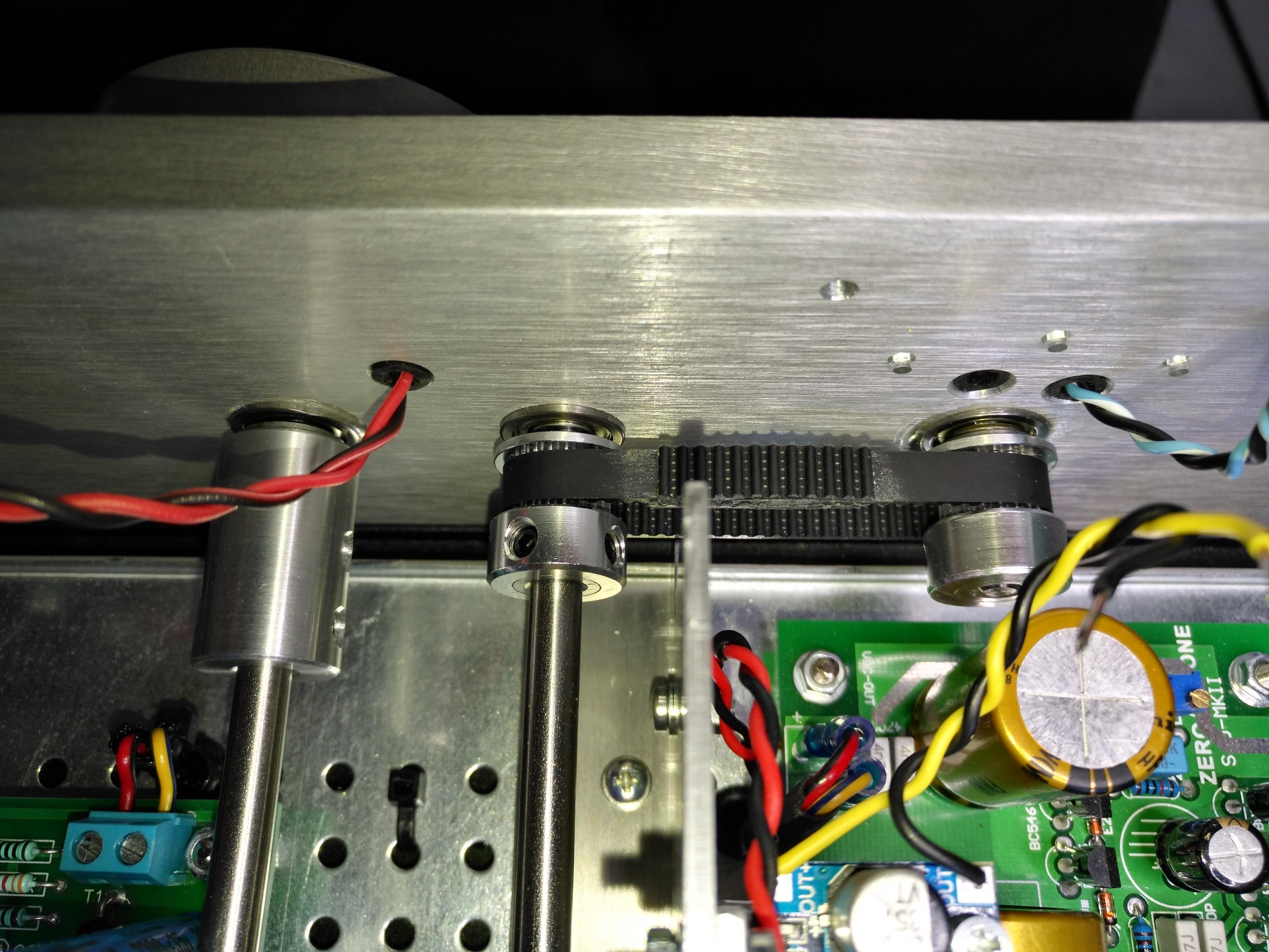

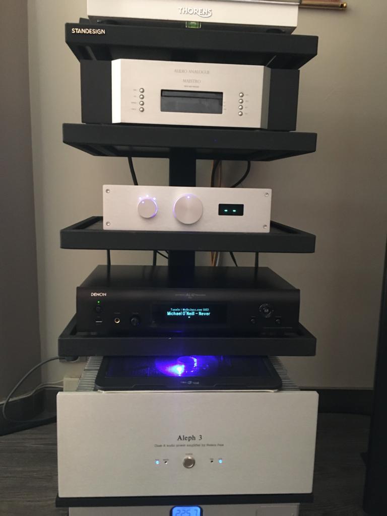

B1 with Korg Triode
Congratulazioni, Mauro! You convinced me that I could have been able to build this lovely device, so much that I did it twice! But your build really looks seriously great, way better than mine (even if I'm still working on it)!
Complimentoni, davvero un ottimo lavoro!
Gaetano.
P.S.: anche se non dovrei dirlo, forse un pochino devo ringraziare Conte e il suo lock down...
B1 Korg final configuration
Many thanks guys,
I'm very excited for your comments, I've never received so many compliments in my whole life:eek: ... not even from my wife ... maybe it's normal, maybe there's a reason ?? Ok, ask to my wife ... or maybe it's better not ...
Have good music!!:)
Mauro
