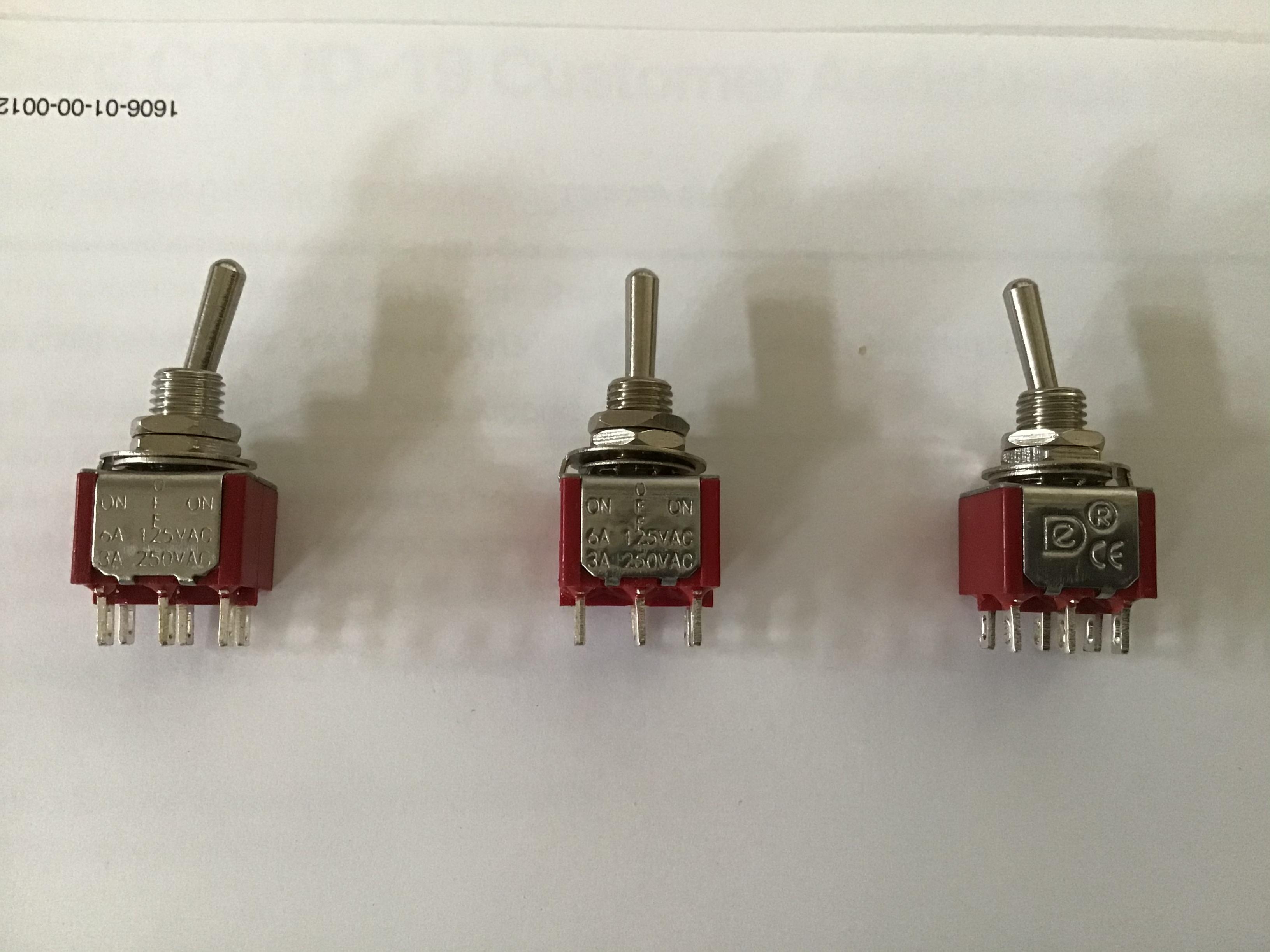

Switch - search for;
DPDT, on-on, solder lug, panel mount.
I stand corrected. I used an ( on off switch ) for my Korg just like the one at the back of the ACA 1.6.
But I have three DPDT bought recently from eBay.

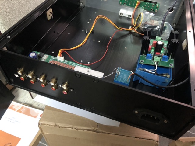

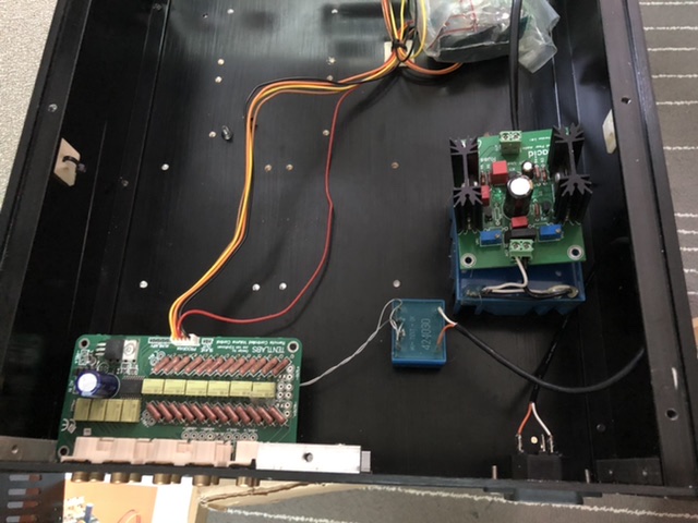

Ordered Nutube,JFet and PCB is time, Going to reuse old projectsleftover like tentlabs remote 64 steps volume control and selector and TPA shunt PSU, the case left after disassembled a dual mono headphone amplifier.
Hopefully this one will be Neat and high quality combo with minimal extra cost with what I have right now, any suggestions and advise?
