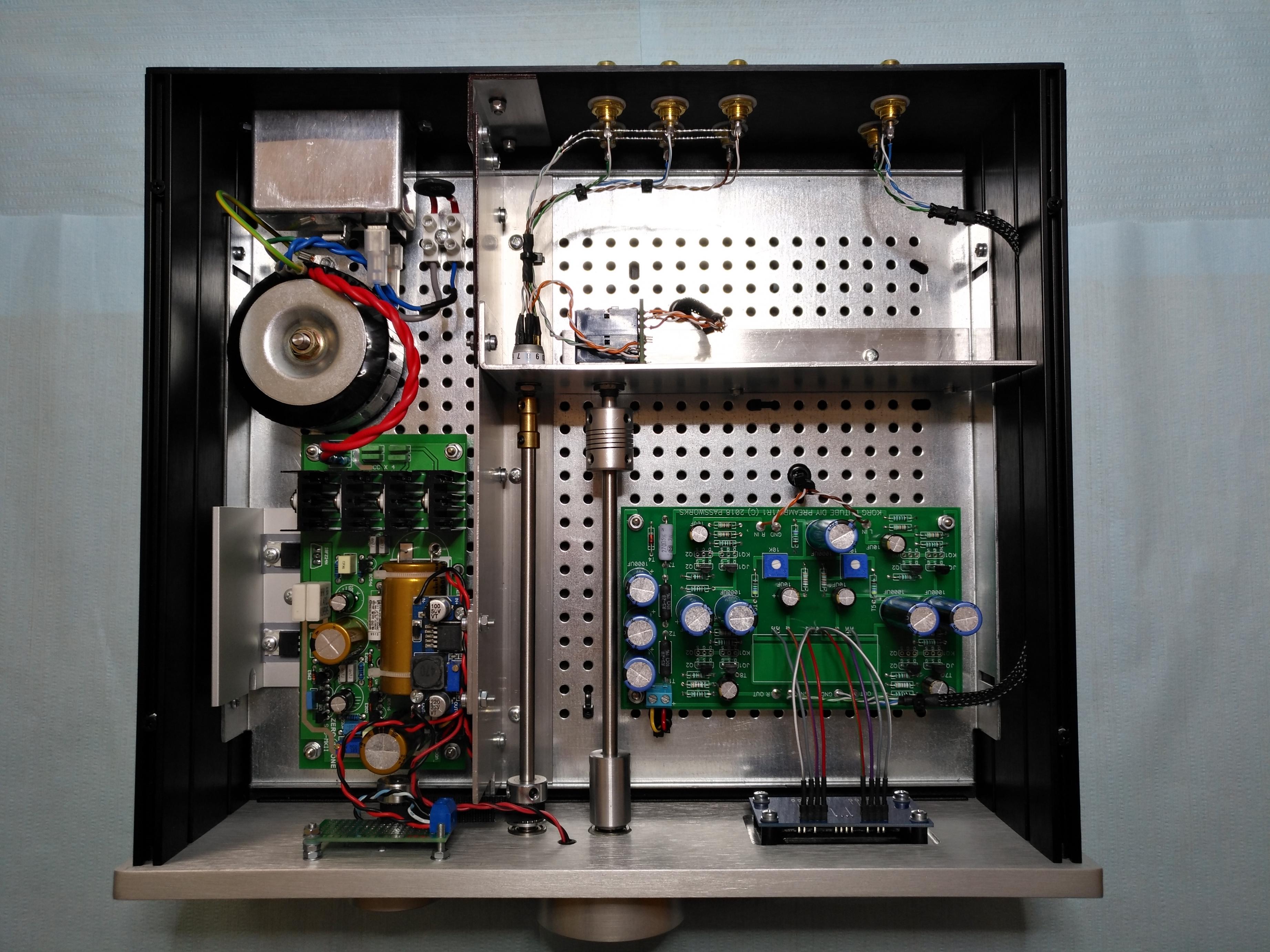

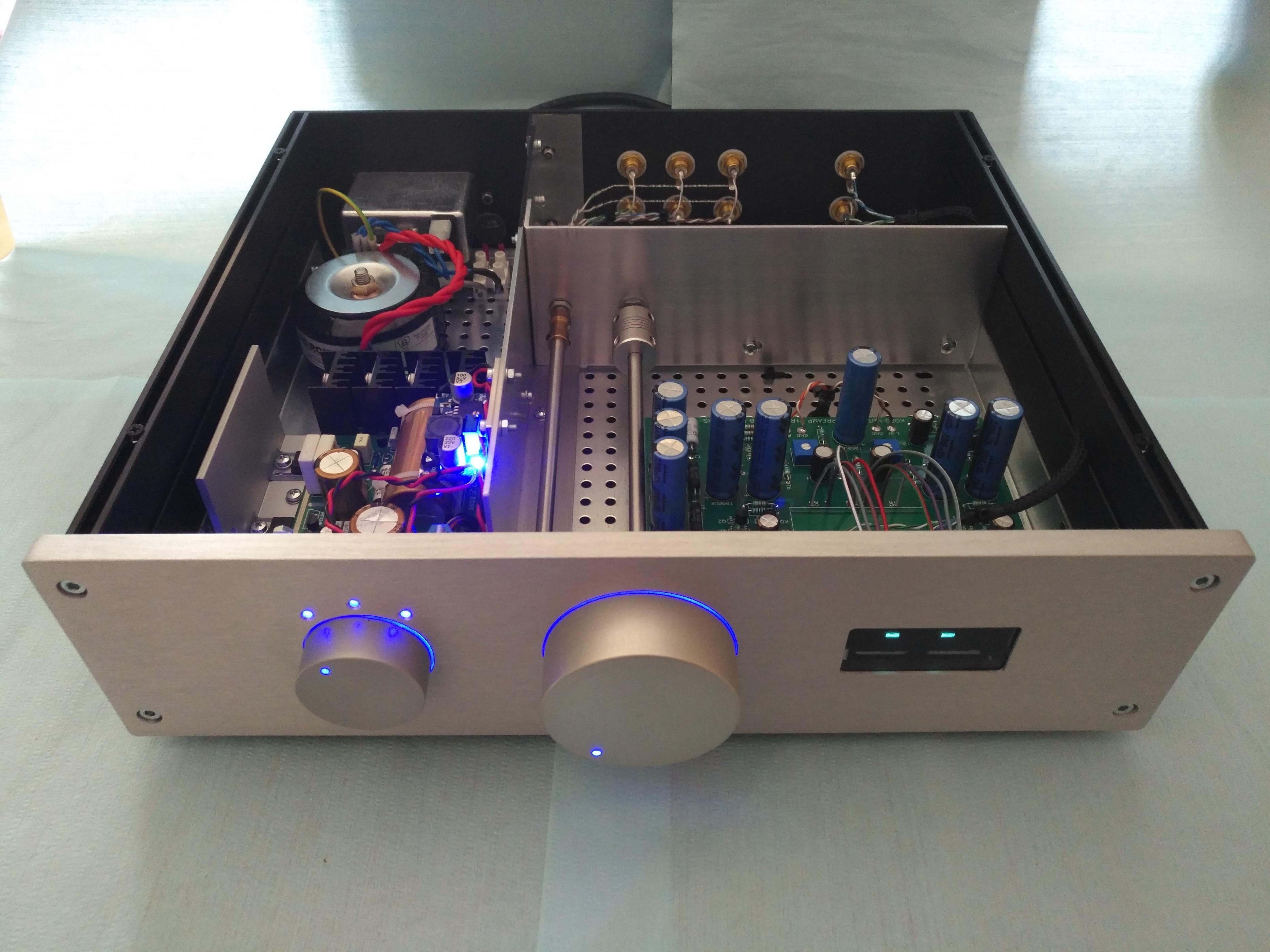

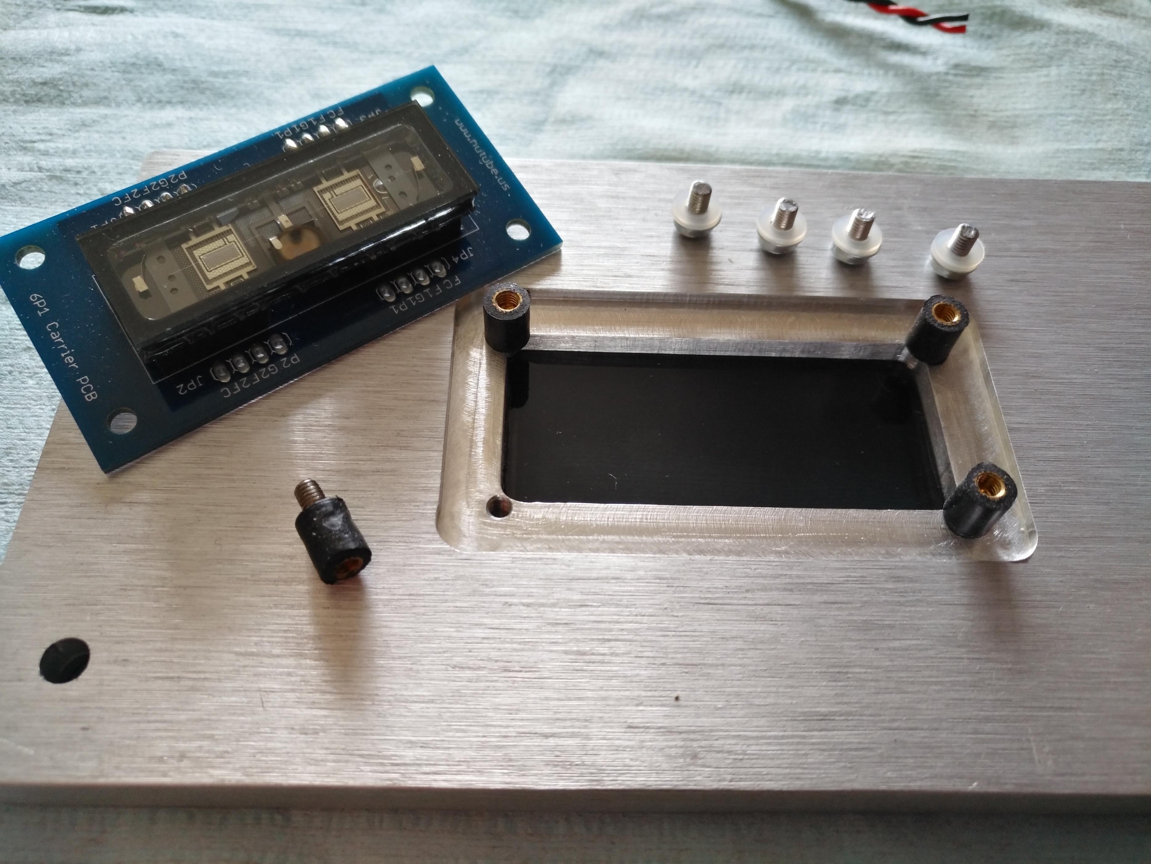

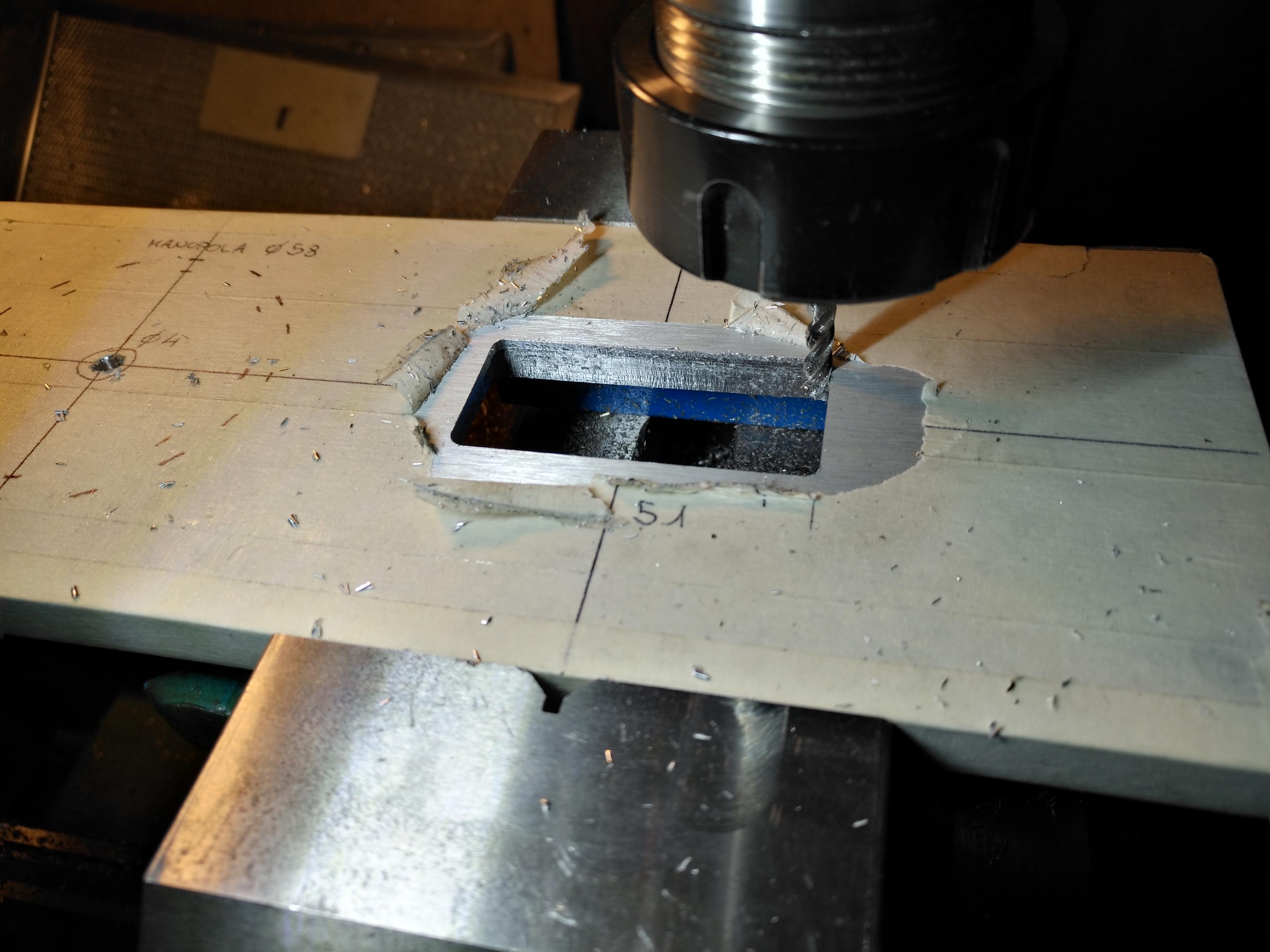

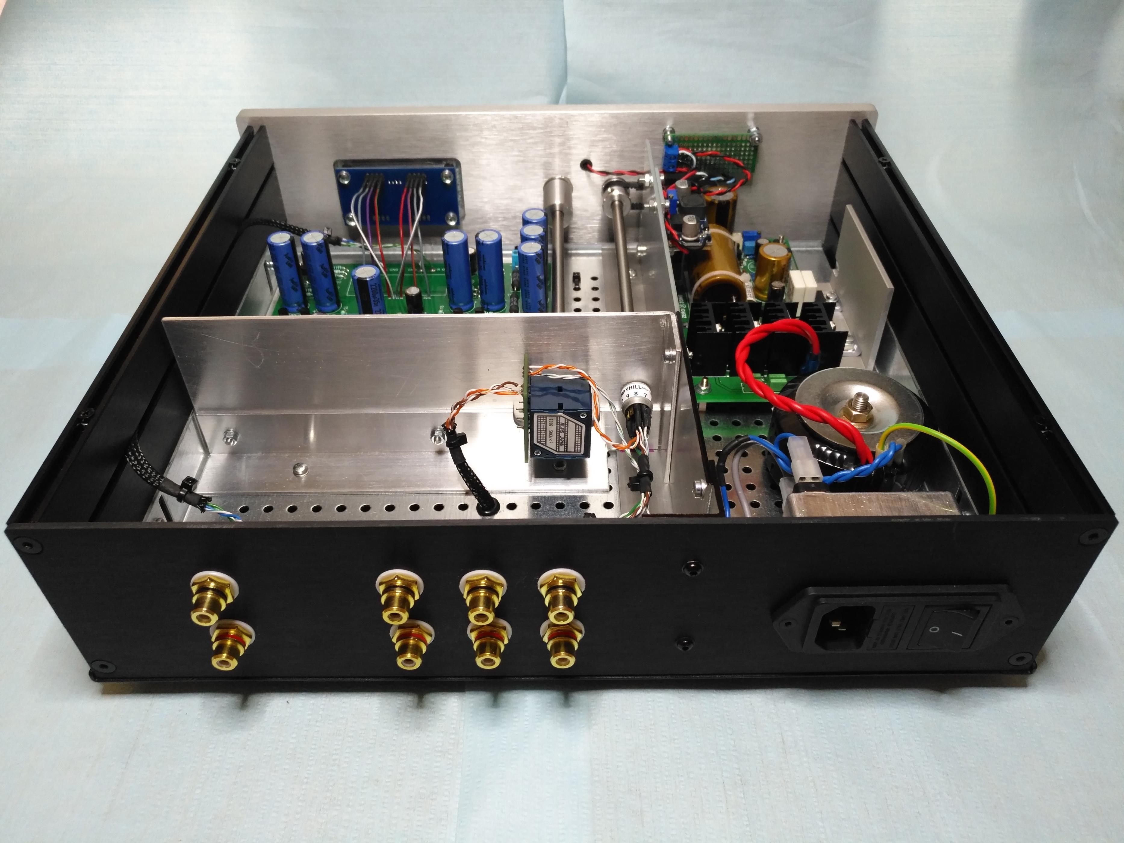

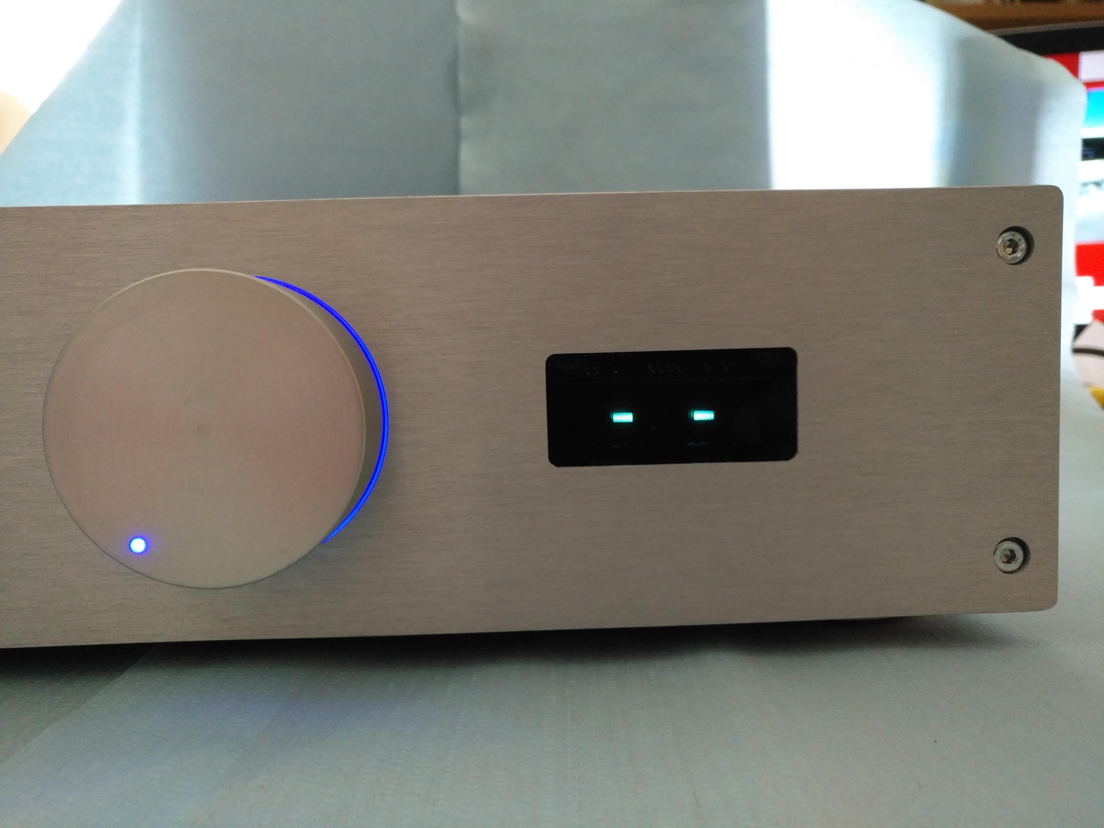

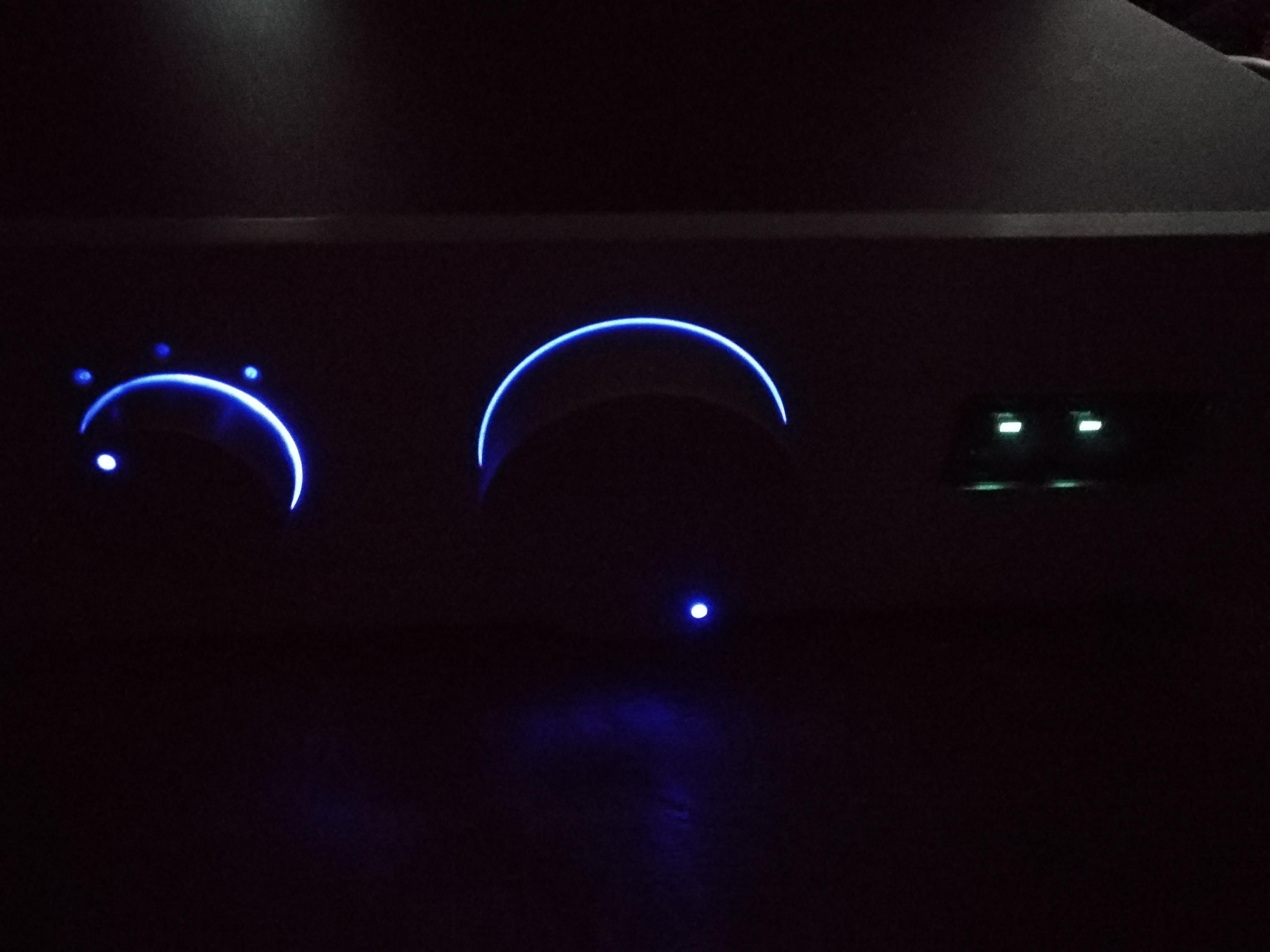

Hi guys,
two months after the first test (# 4103), my first realization is finally complete! I am really very happy with the result.
For the input selector I used the Grayhill suggested by 6L6 (it was a really good exercise with the welding iron!),
I copied the window on the front from Cubicincher (a really good exercise with the vertical milling machine!).
Many Thanks to Mr. Pass and you all for the support you have given me!
Mauro

Hi guys,
Mauro
Very nice build! 👏🏻
