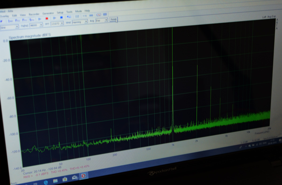

I checked my distortion measurements for my Korg implementation. It seems only 2nd and 3rd harmonic (4th is very low) has some significance with 2nd to be the very dominant. A 4A switching brick is used as PSU with some additional filtering. I don't find my Korg as "bright" in my system.
It is a more or less standard implementation of the Korg.

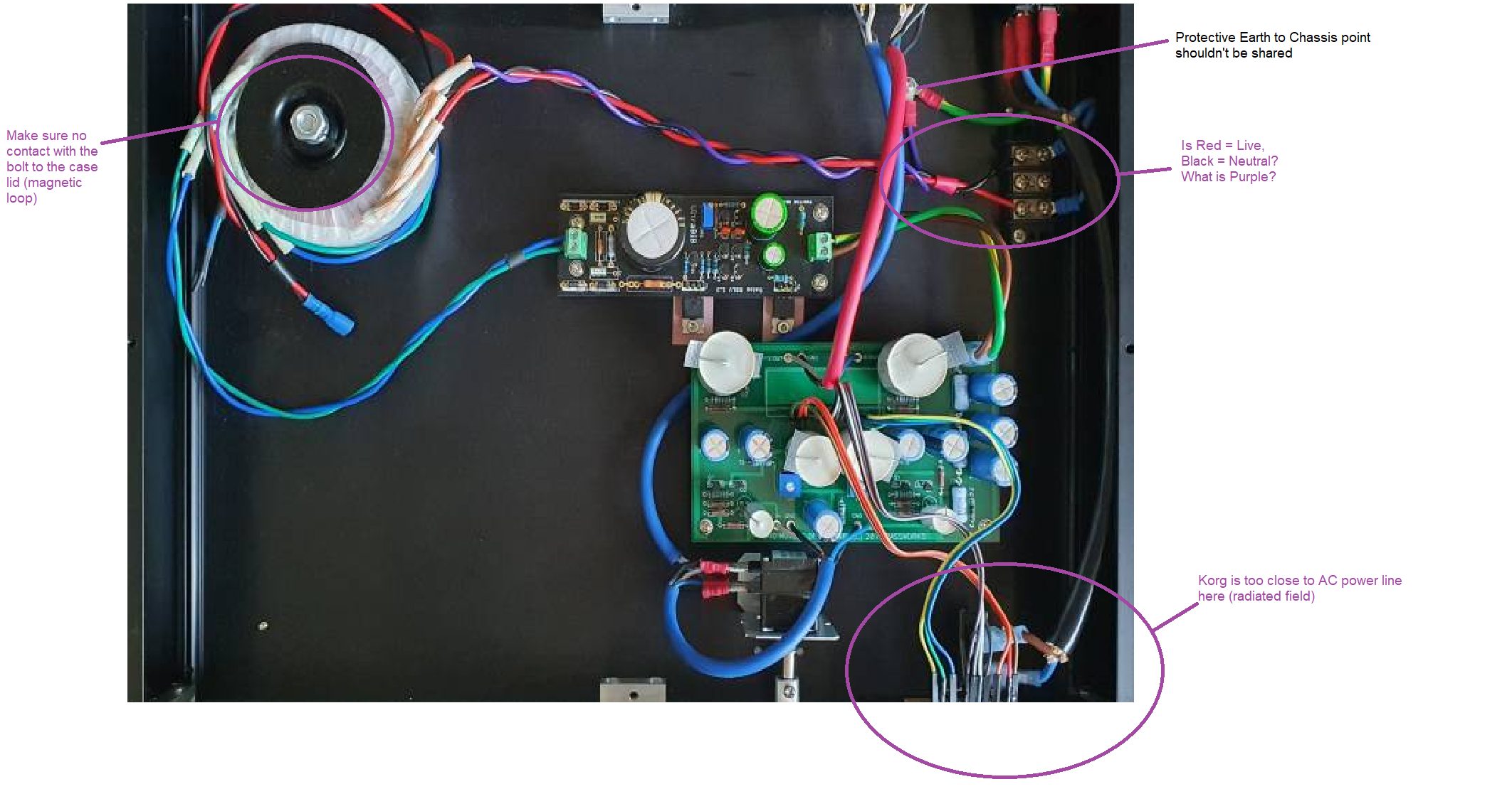

You have placed the toroid in the far corner which is fine but your 230 VAC wires runs across and close to the signal wires. I would have placed the 230 VAC connector in the same corner as the toroid. Then your 230 VAC will be very short.
Also check that your PCB screws have "galvanic" contact with chassis as Korg gets its chassis connection via these screws. And also check that your chassis parts all has "galvanic (electrical)" connection to each other. It can be hard work with these kind of chassis to achieve this but is quite important (screws has to be "worked" a lot). Check it with a "bip tester" or ohm setting at lowest range.
Also I just noticed that you don't have the Nutube on PCB but connection with long wires to a window in chassis? …...Nutube is very high impedance so doing this you don't want any AC wires close to Nutube wires. I think this is main reason for hum.
I would solder Nutube to PCB. I have never understood why people compromise sound quality vs "fun" by mounting Nutube with long wires just to be able to see the blue lights 🙂

I have an issue with my Korg B1, it hums but I can't seem to find the cause. I used a Salas UBib shunt regulator for the PSU and wired the NuTube to the front.
Can someone take a look at my build and advise? TIAView attachment 821065
Your photo was a bit small on the screen but here are a few comments:
attachment.php
It appears that you have the primary side of your transformer connected to the chassis at the centre tap (dual primary) and I can't see a fuse. It might not be the case because the photo isn't very clear when zoomed and maybe the fuse is in the IEC housing.

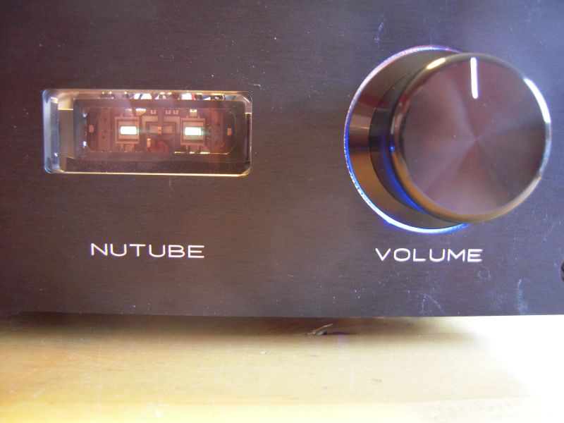

B1 NUTUBE-pre experience
Hello B1-NUTUBE- builders,
I have built my B1-NUTUBE-pre circa one year ago.
I made a little 'show-amp' by putting the NUTUBE behind an acrylglass-window in the frontplate. Yes, this is not necessary - but you can do it.
My NUTUBE is mounted on an aluminum-plate (with damping foam) and then
the aluminum carrier is mounted with rubber grommets to the 10mm frontplate.
I also used rubber feet under the case.
I never ever had any 'ringing' or kind of oscillation appearing.
I also tried a few different caps (Mundorf, Intertechnik Audyn,..) and came back to the Nichicon non -polar greensleves. For me the differences were so subtle.
This preamp sounds wonderful.

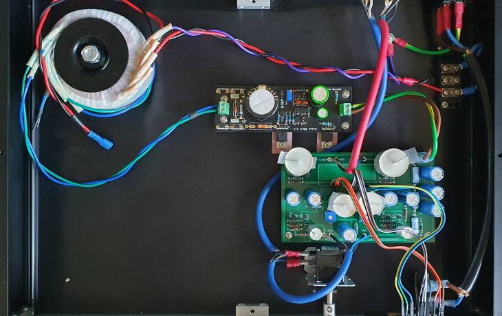

IMO Unless you are prepared to ditch the original case entirely for one that enables better positioning the next easiest fix without leaving ugly holes in your new case would be to buy a new small case for the power supply and move all the AC stuff into that and run the DC from a couple jack connections in each box.
That way you could keep the position of the Nutube in the existing case and retain the switch on the front for DC use and keep the RCA connectors at the back.
AC hum seems to be a frequent problem on the forum whenever people put power supplies in the same case as the DC sections. Given the impact on sound quality it has to be better to go for seperate boxes every time.

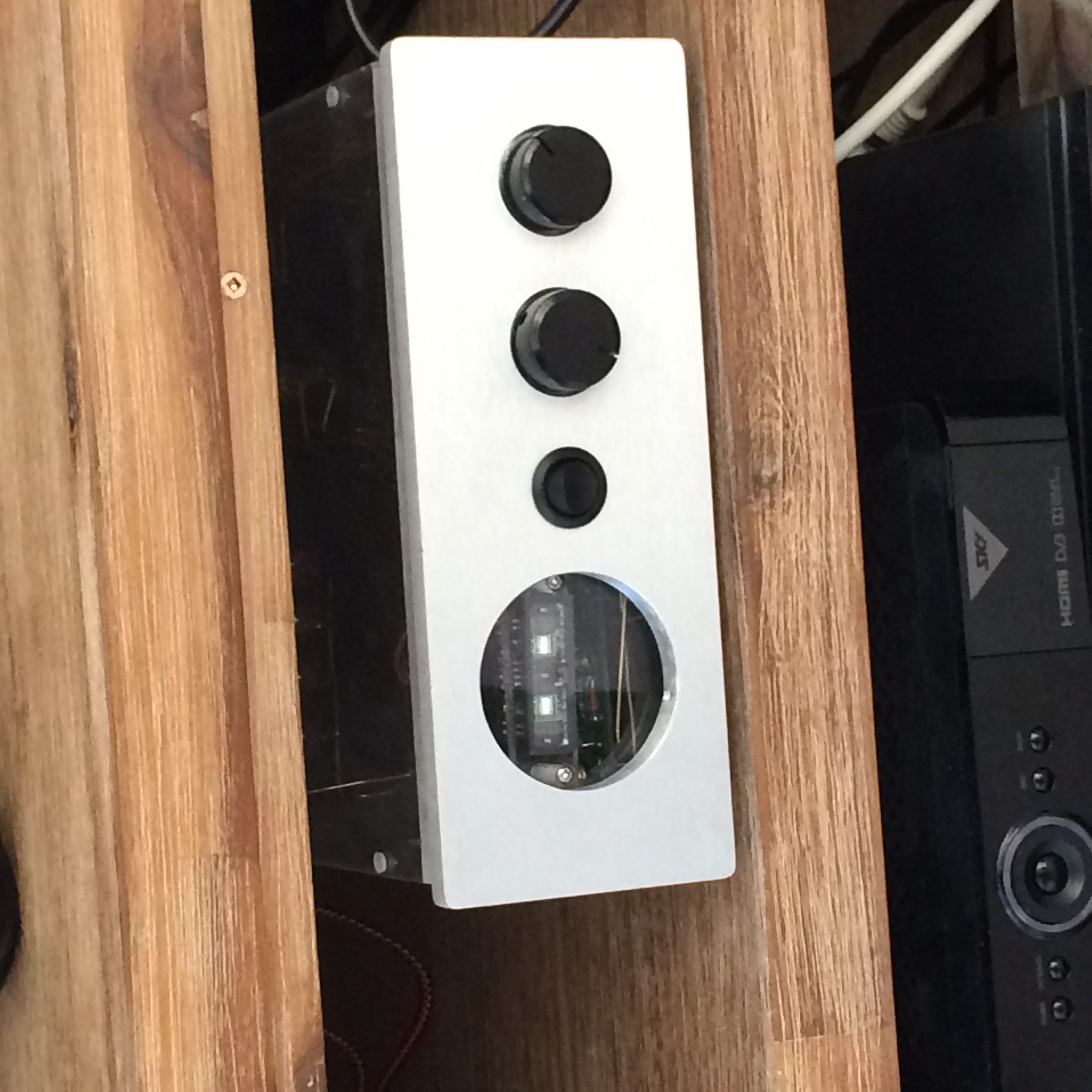

I have my Nutube on display on the front of my case suitably isolated no ringing unless I tap the case with a screwdriver. If you've had valve amps then you want the Valves on display - even if they are small and blue!!
