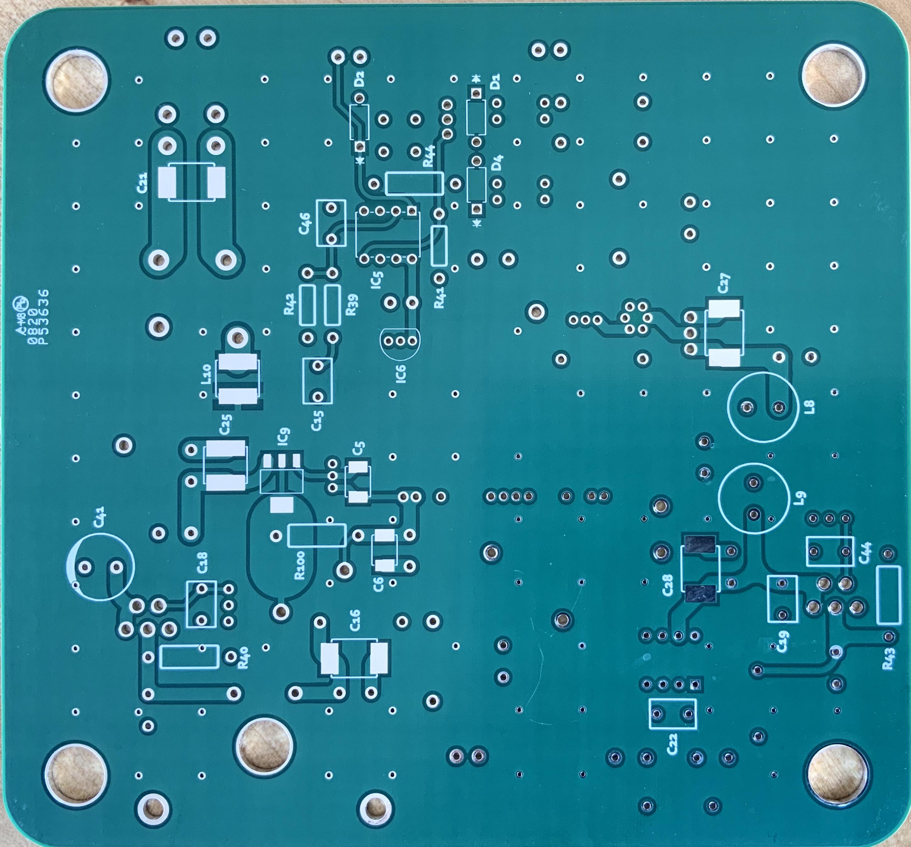

Finished PCB’s from the image posted on page 430. These are 4 layer FR4 1oz. A mixture of smd and thru hole. ~ 4 hrs to build a pair. :wrench: Input / Output signals routed on top. The plate , filament , & grid supplies are located on the bottom. The inner layers contain the ground plane and the power distribution plane.
