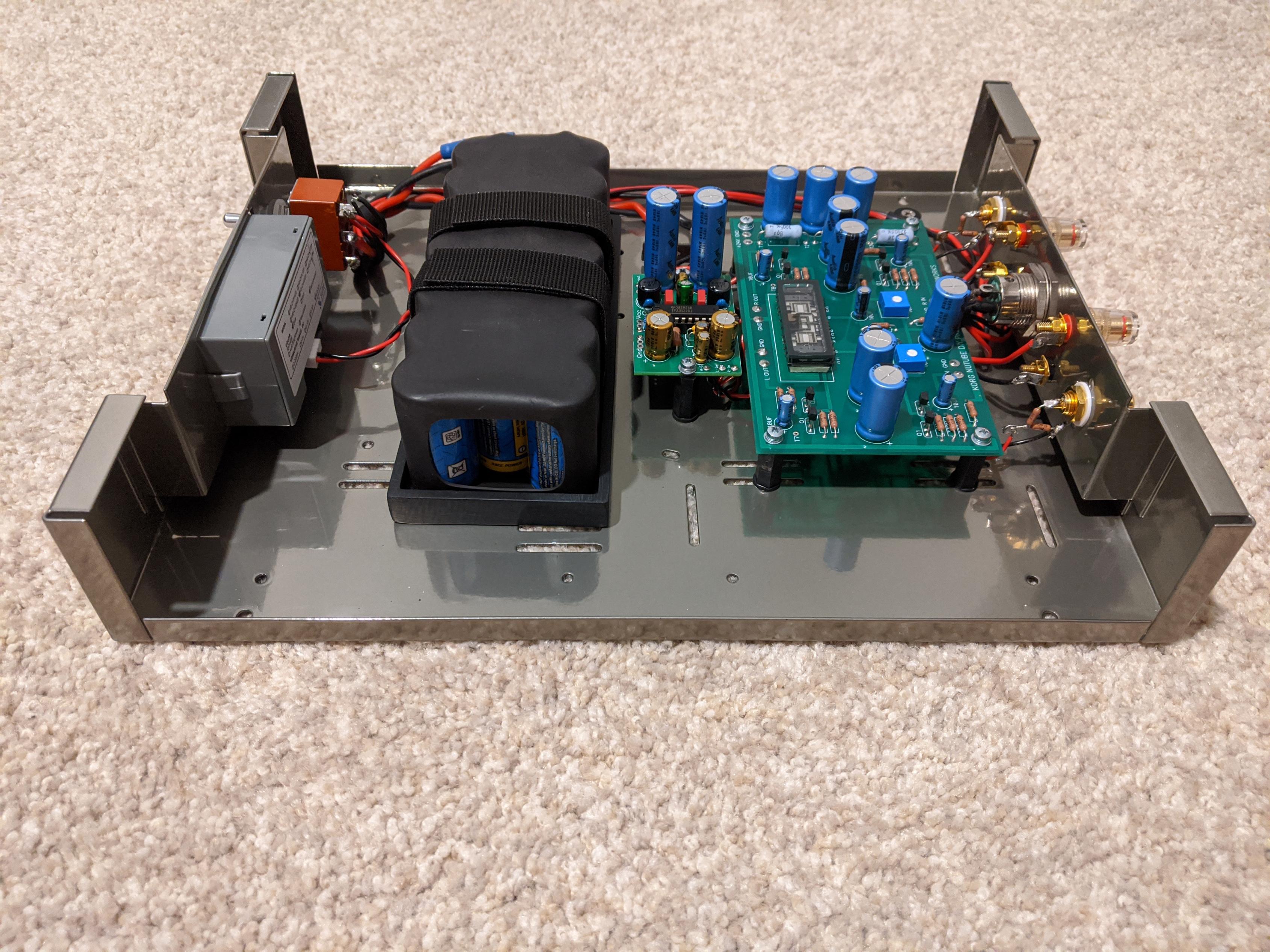

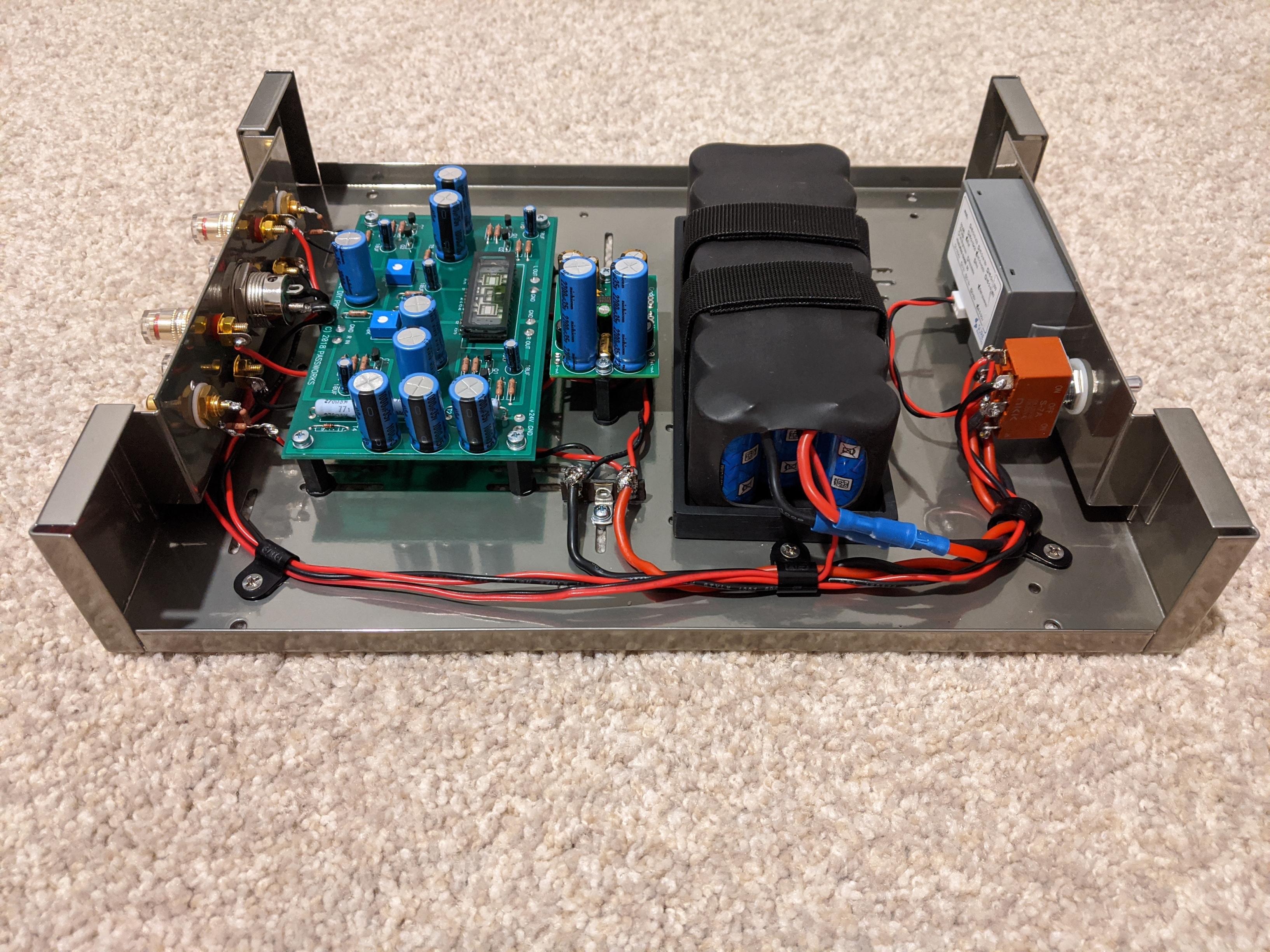

It hasn't changed a ton since the old pictures. I've posted 2 new ones that should showcase changes. There are two grotesque joints; they are functional but cosmetically undesirable, I will fix later.
I should correct my last post. Ringing is still an issue. The tube will go microphonic if I simply blow across it. As I mentioned in a previous post, I wasn't gentle with anything, including the new tube. Maybe I paid a significant price for my stupidity. The cover seemed to stop the ringing one time, but that won't solve problem entirely. I've either got to cover the Nutube itself or replace the Nutube. Desoldering and soldering in a new Nutube is not something that I look forward to.

I decided to try another Nutube. This solved two problems:
1. I can now get acceptably close to equal gain in both channels.
2: Ringing is much less of an issue with the new Nutube.
I guess there is quite some production variation and my first one was a worst case.

This is typically the filament ringing at 5 - 6 KHz. Of the 6 tubes I've used in various circuit builds, I've only had one that rang when tapping lightly on the glass and the ringing would die out quickly. I used this to dampen it (sticks really well):
https://www.amazon.com/Duck-Reusable-Removable-Mounting-1436912/dp/B000BQMFEC
It seems if ringing is so bad it is self sustaining, it would be best to replace the tube.

Occasionally it will starting ringing and just continues to get louder and louder; putting the lid on solved it one time. Unfortunately, my design is hybrid power amplifier. So I have no volume pot, meaning the ringing is at full amplification no matter what my source is set at.
Like I said, I wasn't gentle with the Nutube. If I am desoldering and re-installing, I will opt for the socket this time around.
