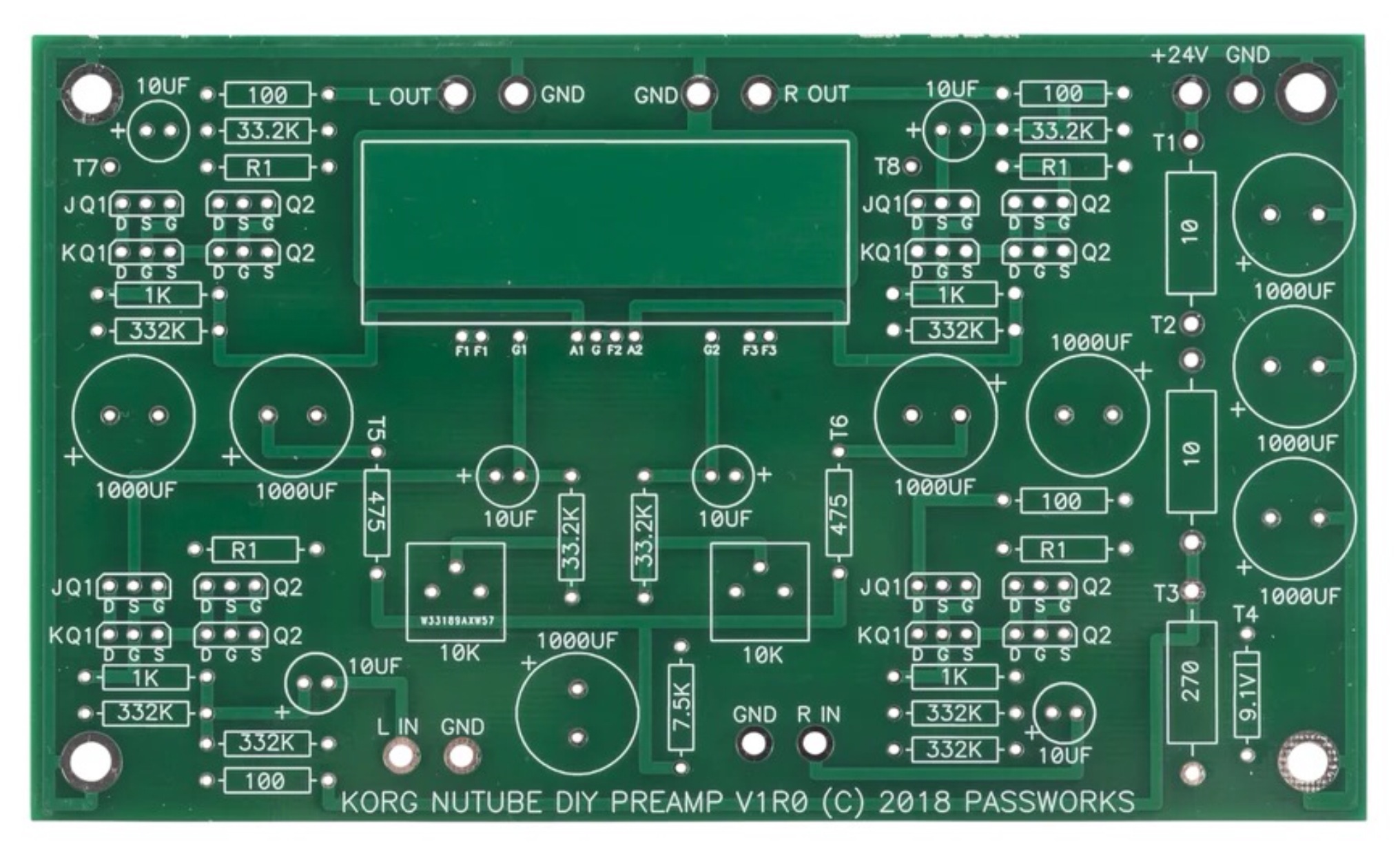

I mean the voltages T7 and T8 and ground. Never measured as I bought a set of jfets and resistors.You mean voltages between ground and T7, T8 test points on the pcb ?
We can change this voltage with two 10K trimmers.
....or You mean something else...jfet's Idss are 6.45mA ?
This I do not understand. Power is on. 24.4 volt after my regulator.Ah OK Do You try with power on get more voltage at T7, T8 ?

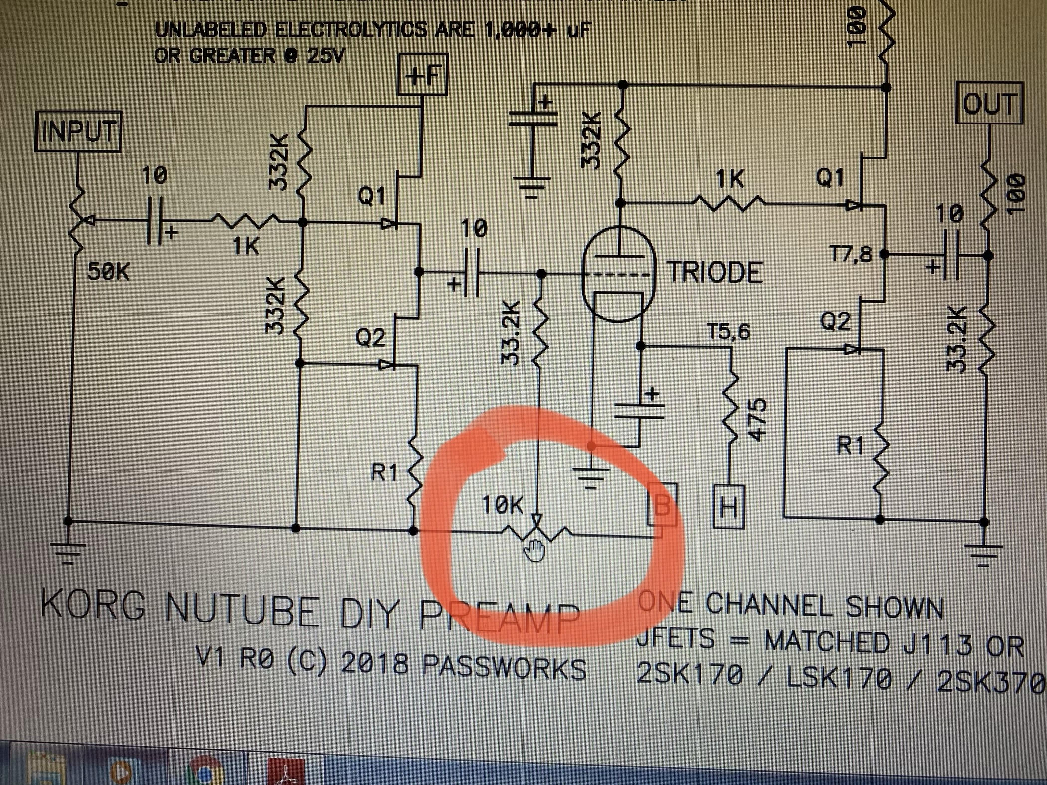

Where shall I place those 10 kohm trimmers?
The trimmers do not adjust the 24V DC voltage but the bias for the tubes. Here is where it is on the schematic of one channel.

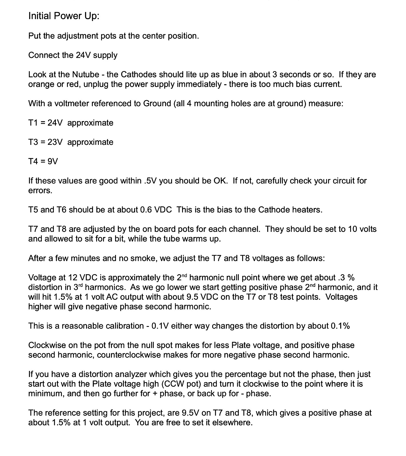

Great! Now just do step by step test musurements of DC voltages from points T1 to T8 like in Mr.Pass article. Source : http://www.firstwatt.com/pdf/art_diy_nutube_preamp.pdf
Oh my god how could I be so foolish. I thought those pots where for distortion regulation and I have placed a stereo pot on the front. I have adjusted to. 9.5 v now. I played around with that pots in our hifi club in Copenhagen. To bright sounding in all positions. There was only little differences.
Yes is for distortion with his phase at specific voltage
This trimmers is easy to play for precise desired voltage

9.5V sound is on the wet side H2
12.5V is on the dry or bright side H3

Hello Erlend,
I would say it is the most important possibility to play with the voltage at
T7/8 in the B1-NUTUBE-preamp.
Adjusting positive - negative 2nd- harmonic (adjustment over the 10Kohm trimpots) as well as to try to reverse the speaker-polarity.
The differences are subtle but for me clearly audible.
Test it! And have fun....

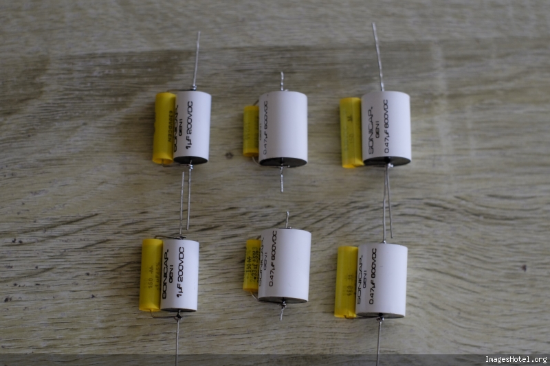

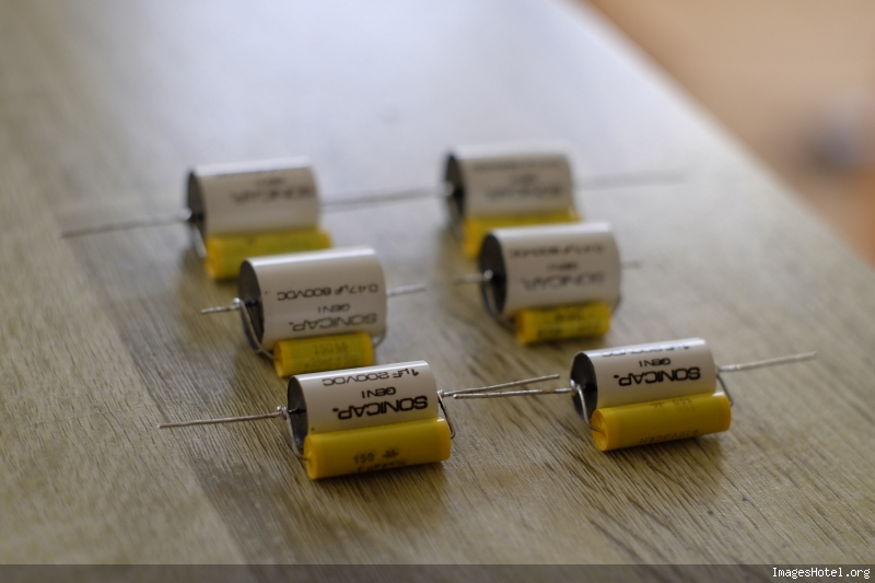

Forgot write about this upgrade FN9222S1B-3-06 Schaffner | Mouser France
I will change the Silmic 10 uf to Black Gate 47 uf Nx 6.3 v.
Allowd me... even if BG are wonderful, (wich they are), I would use PPPs. Without a doubt.
