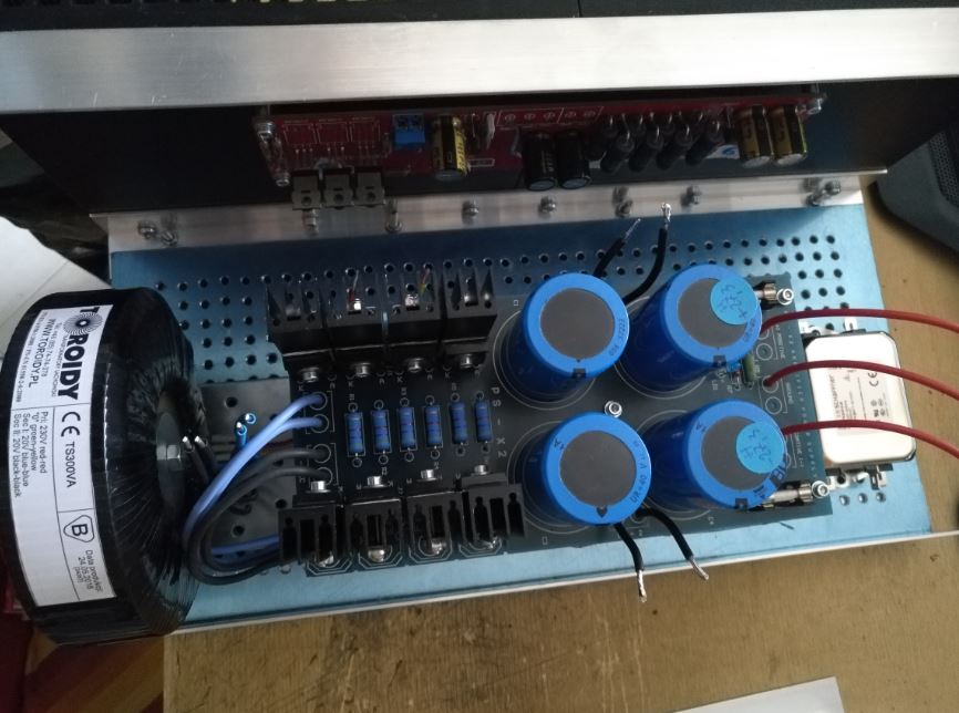

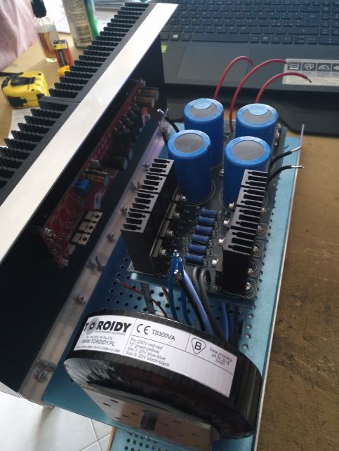

Sorry about 4107#, maybe before I translated incorrectly:eek:... I wanted to mention that the Mr. Pass project is very nice, certainly not the one I assembled! ... damn google translator... and my english language:) ... I keep working on completing the Korg B1 preamp and Aleph 3 amplifier, when I have free time. From the test performed about 10 days ago, I really think that the paired Pass preamp + Pass amp is excellent!
The attached images are certainly out of topics, but allow me that I am really very excited about my first project, that I want to share it with all of you.
Thanks and good music to all of you!
