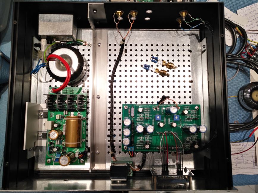

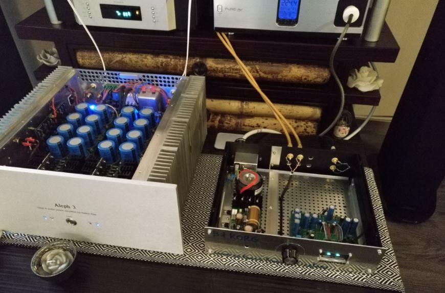

First test
Hello everyone,
I'll want to share my first audio diy experience with you all.
Thanks to mine friend, yesterday afternoon we tested for the first time musically on his Aleph 3 clone (very well built!), The B1 Korg built by me with the basic kit.
My emotion was a lot and my heart was beating fast, raising for the first time in my life the volume of something electronic assembled with my own hands. Ok, I wait again, I check the test points for the umpteenth time: everything ok except T5 and T6 which are both at 0.68V ... in Mr. Pass manual, he wrote 0.6v ... about 12% in more will be a problem😱😕? Wait, I'm still looking for information on the forum ... after 10 minutes of reading I think everything is ok, I proceed, I turn up the volume.
No Umm well🙂, we hear it coming from absolute silence, Mark Knopfler's fingers plucking the strings of his Gibson guitar, after the voice present in the center in front of everything, everything else is perfectly balanced.
Listening proceeds from jazz to pure percussion, up to female voices ... what's better than Diana Krall ?? Nothing to say, excellent.
We are both very happy and satisfied with the result, we uncork a beer to celebrate the event
I apologize to everyone but this is my first realization and I thank Mr. Pass and all of you members for the help you have given me, to read more than 400 pages (many times ... almost always ... with the help of google translator 😱...) it wasn't easy for a person like me who remembered only Ohm's law from school about 33 years ago😱 ...
This was the first test, now I have to complete the construction with the input selector, move the potentiometer to the back of the case and mill the front panel.
I will keep you updated (if this may be of interest) until the end of the construction.
Again thank you very much to all of you!
Mauro

Well done Mauro, congrats!
Looks very clean to me, much much cleaner than my first built
Thanks for sharing and enjoy music
Claude
Claude

Congratulations on your build! Enjoy the music!
Hello Mauro,
enjoy your Korg Nutube Preamp - it is a beautiful soundmachine!
'bella macchina di musica' (I hope it is correct?) 😀
Greets
Dirk
Greets
Dirk
Really many Thanks ClaudeG, JSA1971 and cubicincher,
correct is "VERY bella macchina ..."
for now I listen to my system with integrated vacum tubes amplifier class A Calypso 120 with Tungsol KT120 tubes, waiting to complete the Aleph 3 finals ... started building about 2 years ago and not finished yet 😱...
Sorry for the off topics but can someone point me to a thread on the creation of Aleph3? it's a matter of life or death for my new B1 Korg at my house !!
It's late now here, tomorrow morning ... this morning the alarm rings at 6:00 to go to work, good night.
Thank you very much to all,
Mauro
