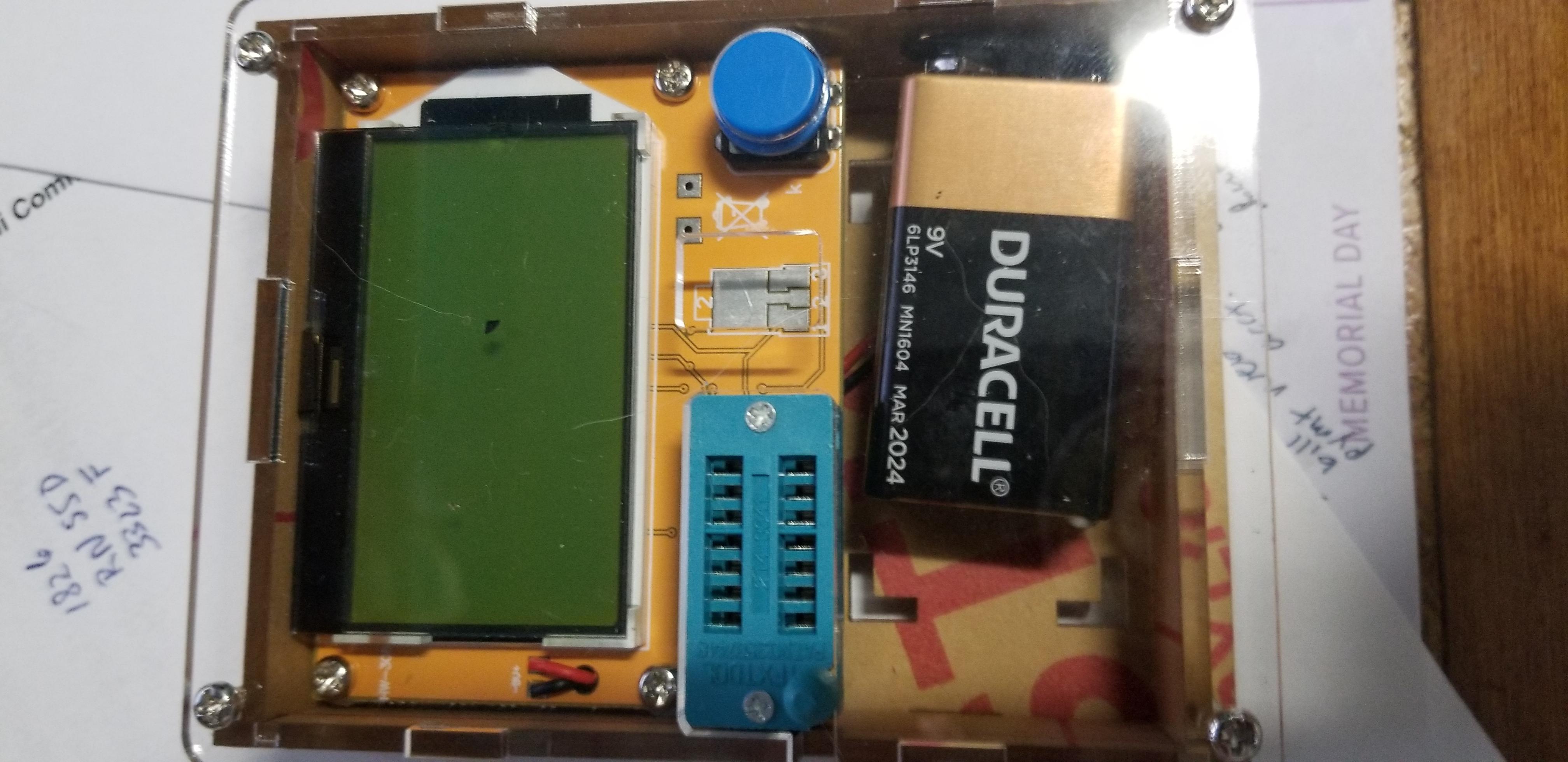

Thank you for the good advice. I did check them all with my tester from Ebay it was only $11.95 what a deal! It tests transitors, diodes, and resistors. I was reading on the forum how important it is to test before soldering.
I put everything on the board just for you guys to check for me. I'm going to remove the larger components and solder the small resistors first.

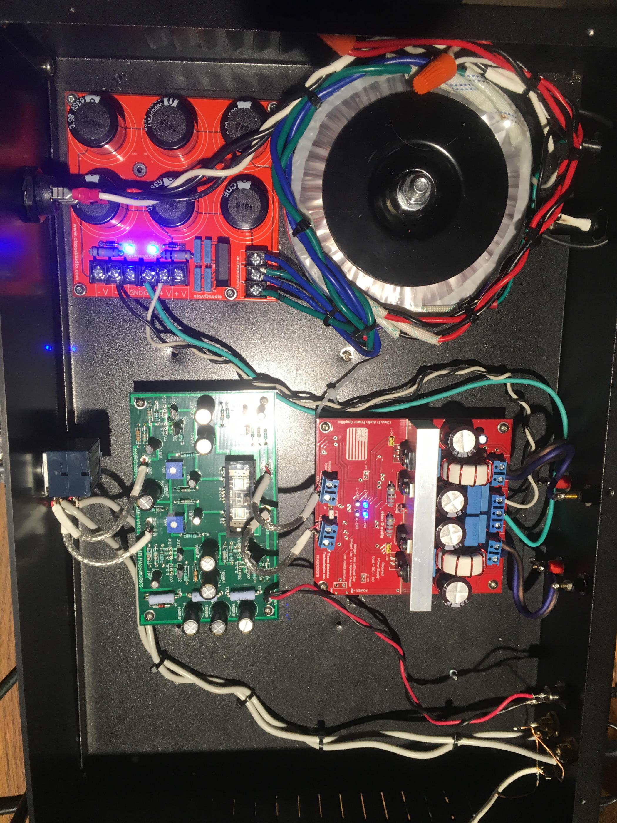

I put the Korg Nutube amp into a samll enclosure inside the large amp chassis. I put caps on the rca input jack shields to ground (0.01uF). I used shielded wire for all of the signal cabling right from the input jacks to the input of the power amp. I have done a bunch more testing and found that the power amp is creating 50mV of noise (weirdly shaped square waves of high frequency) on to ground (chassis, DC -, everywhere.). The power amp has some residual hiss even when the audio inputs are shorted. The preamp then picks up the noise and amplifies it creating an audible hiss at the speakers. Unfortunately I think the preamp will need to be moved to a separate enclosure unless the noise from the power amp can be mitigated. This can't be normal for a power amp to create so much noise. Maybe it's defective.
It would be helpful to know what power amp you are talking about and even more helpful if you can add a picture or two to see the exact layout.

Nelson is right on with his assessment. The power amp is a ClassDAudio CDA-120 60W/ch Class D amp. THe power supply for the power amp is a linear supply. The photo attached is before I put the Korg Nutube in the enclosure and rerouted the 24VDC power wires. The signal wiring and DC supplies are all isolated from ground. Next I'm looking at ensuring the power amp grounds are isolated from the chassis. I'm also looking at installing the Korg Nutube preamp in its own physically separate enclosure. Realistically I could live with the hiss but I really don't want to. I want a quiet amp. Achievable? I would hope that is not too much to expect.

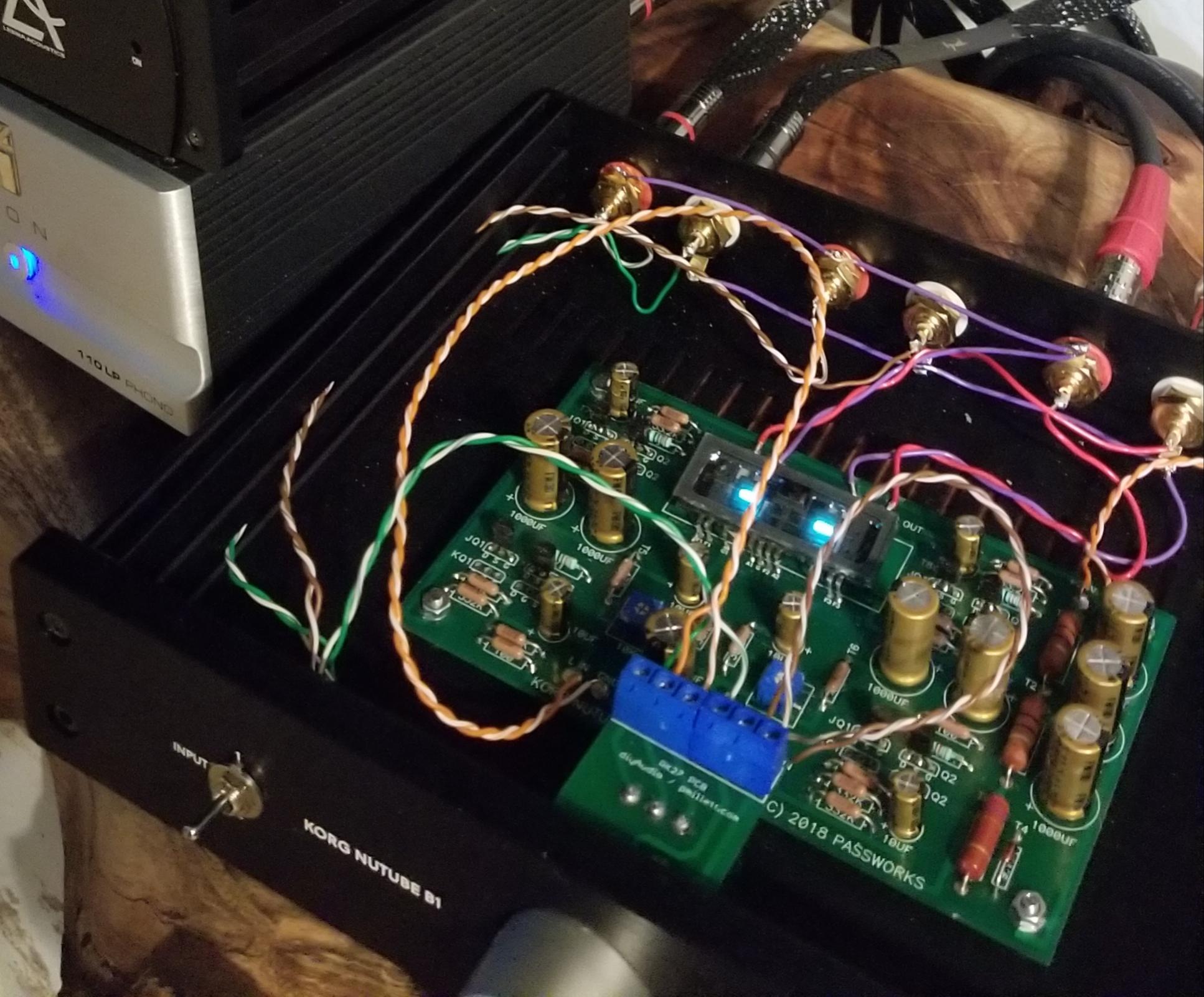

Alive..It's alive, it's alive!! I've been listening to music for just under an hour now. I'm so impressed. Even with my lousy ears! I can hear a clarity that hasn't been there with out the B1 Korg. No ringing either baby!
Thank you Mr. Pass. What a great design. How you do dat? (As some say in Hawaii). Of course, thank all you guys on the forum too. It's been fun reading all your posts. I really couldn't have done it with out your help. I had a couple of learning curves that slowed my progress. Geez cleaning the board? Like an earlier post I really thought I screwed my self using Ace Hardware flux. What a relief to find it's normal to be a PIA to clean. But I sloshed on, beer in hand No smoke, just awesome music.
I'm going to enjoy the music for a while, no adjustments just yet, I want to hear it longer.

Very nice post fun to celebrate other success stories. No ringing strange isn't it how some people suffer and others do not!
LOL... so is it a boy or a girl ;-)
On a more serious note : Congrats! Really well done, looks clean, great learning curve on your side, bravo!
