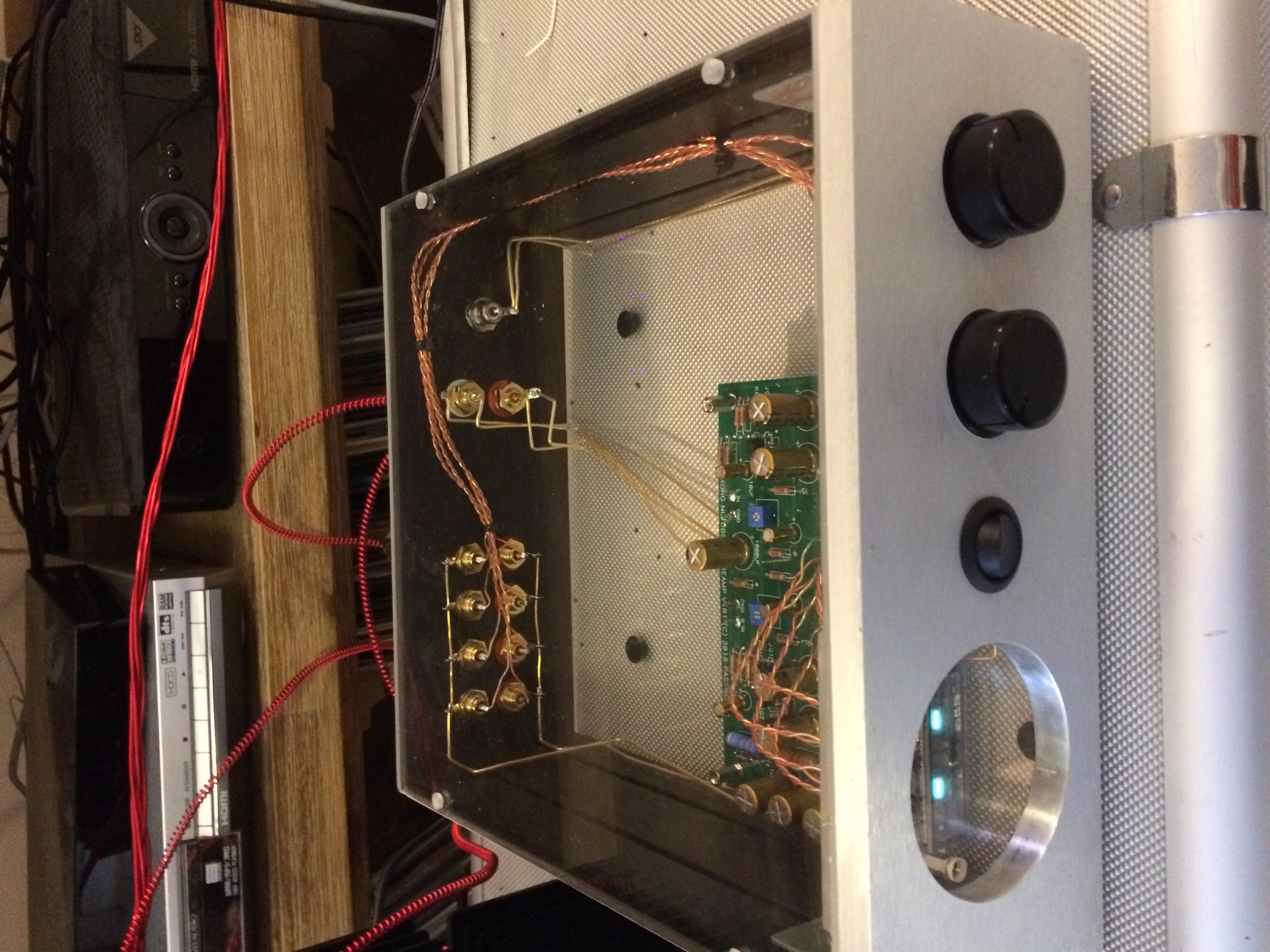

My son & I built one with a source switcher and a 10k pot in front. Even at its very clean setting, it's an amazing preamp that we like a lot. Haven't even really explored enhanced second harmonic yet ... 🙂😎
Regards, Claas

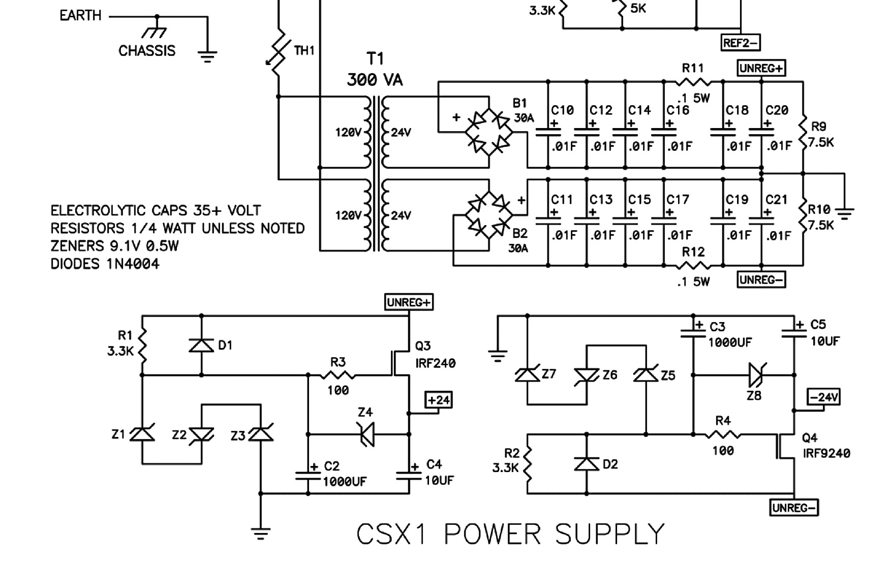

Mr. Pass articles is plenty of useful circuit modules, for example, this 24V stabilized supply.
Thanks for schematic 🙂 Components are easy to find.
Regular Greedy Boyz keeps few caps, IRF240 and zeners in a drawer with small toroid donut.

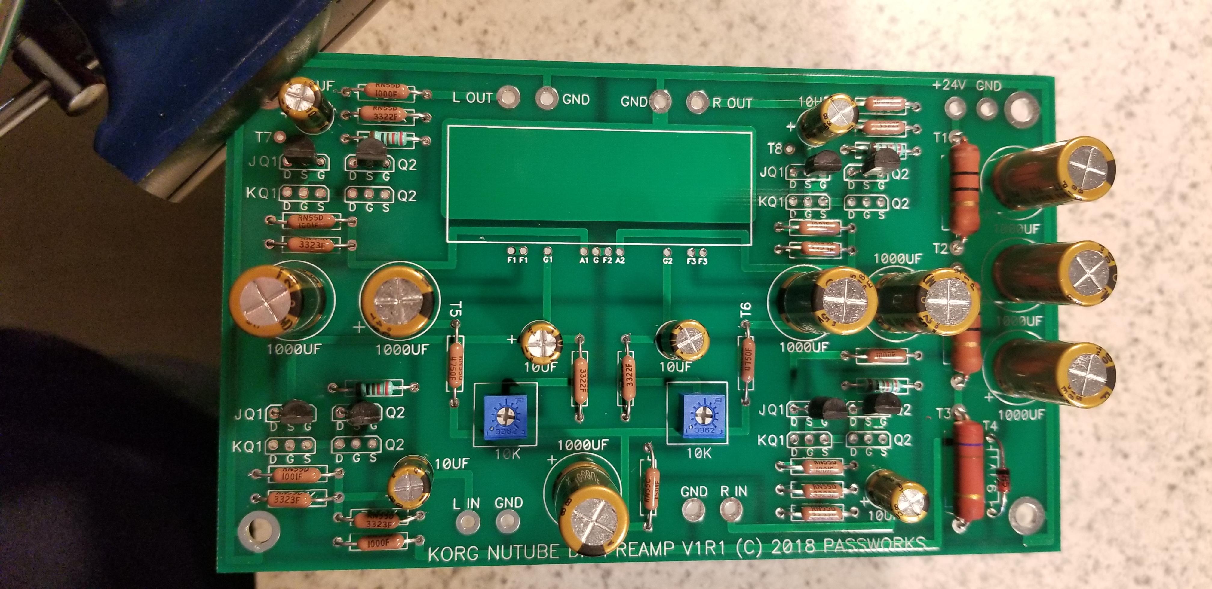

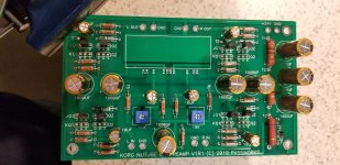

Everything to build my preamp arrived in the mail except the Flux. So I went out to my shop and grabbed a tub of flux I use for copper pipe soldering and practiced for a while. The flux from Ebay was ordered December 9th. Its in San Diego as of yesterday. I'm not waiting, so I found some electronic flux at Ace hardware. So, I'm ready to solder. I stuffed the PCB,but I'm too chicken to start soldering. Would someone one please help me cross the street? I'm new to this hobby and would appreciate anyKorg BI .jpg advice I can get. Please look at the picture of my board and see if I got it right.
Looks pretty good to me, ideally, when you solder from the back side, the front side (like your picture), should have small mounds of solder also like the back side. This will come with practice as you cannot watch the front side to see if you get right while working the back side.
When I'm not sure the front side is "right", I solder from the from front to fill in.
The real test will be the nutube, be careful with the pins, they are very delicate.
Do you have a clip to heatsink the parts, like transistors? If not, find one, allow is best, alligator clips second best, use them on each solder joint by clipping the part close to the part so when you solder the heat from the solder dissipates.
This is a great preamp, your halfway there from your picture!
