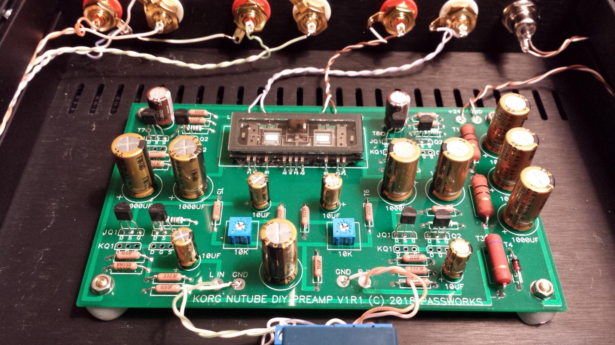

Korg Nutube left channel no volume
After some checking I have found the following:
Input signal of 60mV p-p
Q1 input buffer
Left Channel
Source = 0mVp-p
Right Channel
Source 60 mVp-p
Voltage Measurements
Left ch
Q1
D = 21.89V
G = 10.75V
S = 11.89
Q2
D = 11.89V
G = 0V
S = 2.24V
Right ch
Q1
D = 21.15V
G = 10.47V
S = 10.58
Q2
D = 10.58V
G = 0V
S = 1.12V
Resistance
Left Ch
Q1
G D = 166.7ohms
G S = 166.7ohms
D G = OL
S G = OL
Q2
G D = 220ohms
G S = 269.4ohms
D G = 209.4ohms
S G = 254ohms
Right Ch
Q1
G D = 269.7ohms
G S = 166.7ohms
D G = 169ohms
S G = 96.2ohms
Q2
G D = 106ohms
G S = 97.4ohms
D G = 104.3ohms
S G = 96.2ohms
All other T point are with in .5V of expected voltage values
I’m assuming the Q1/Q2 have failed on the left channel input buffer. Any other ideas?

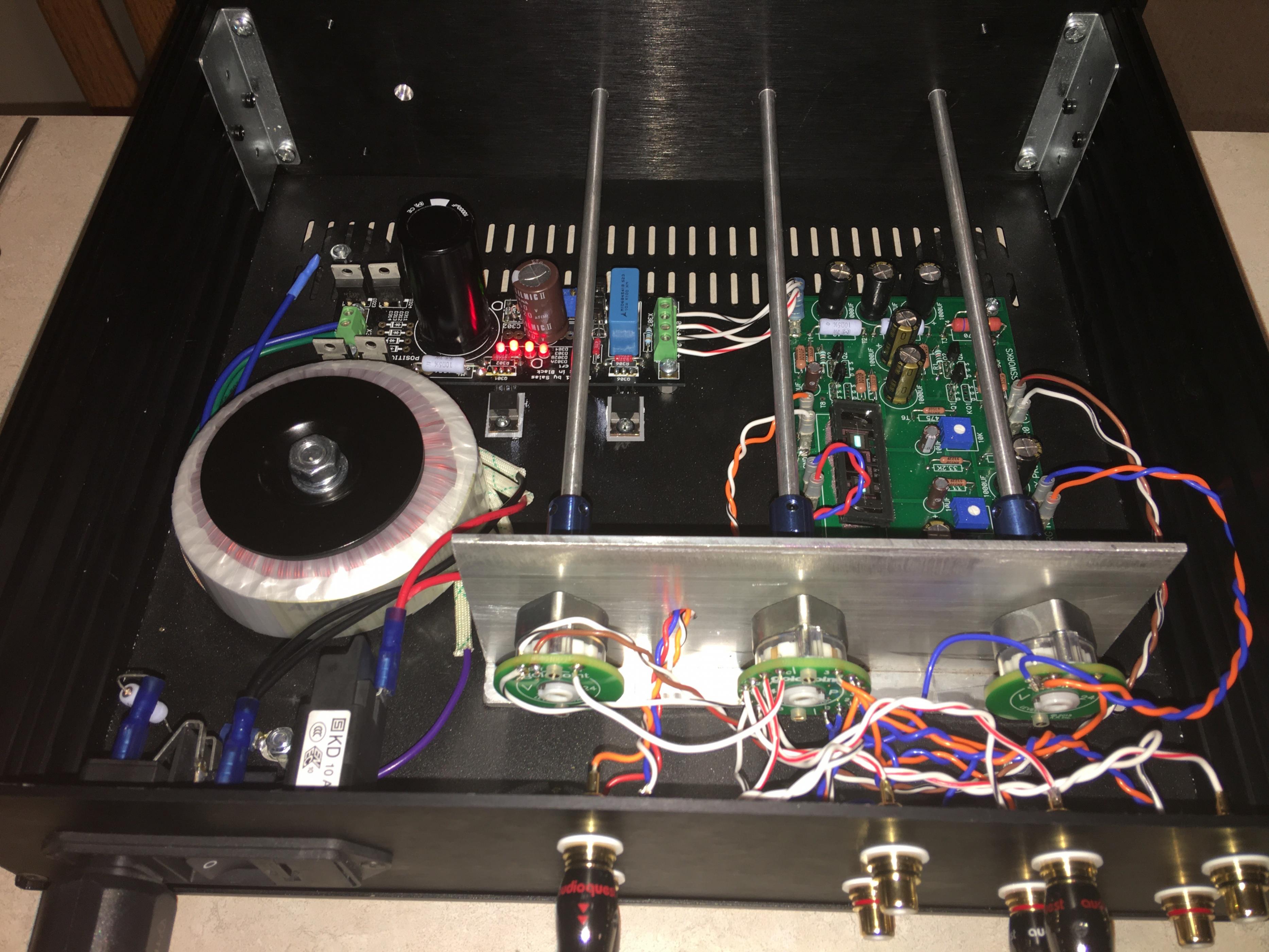

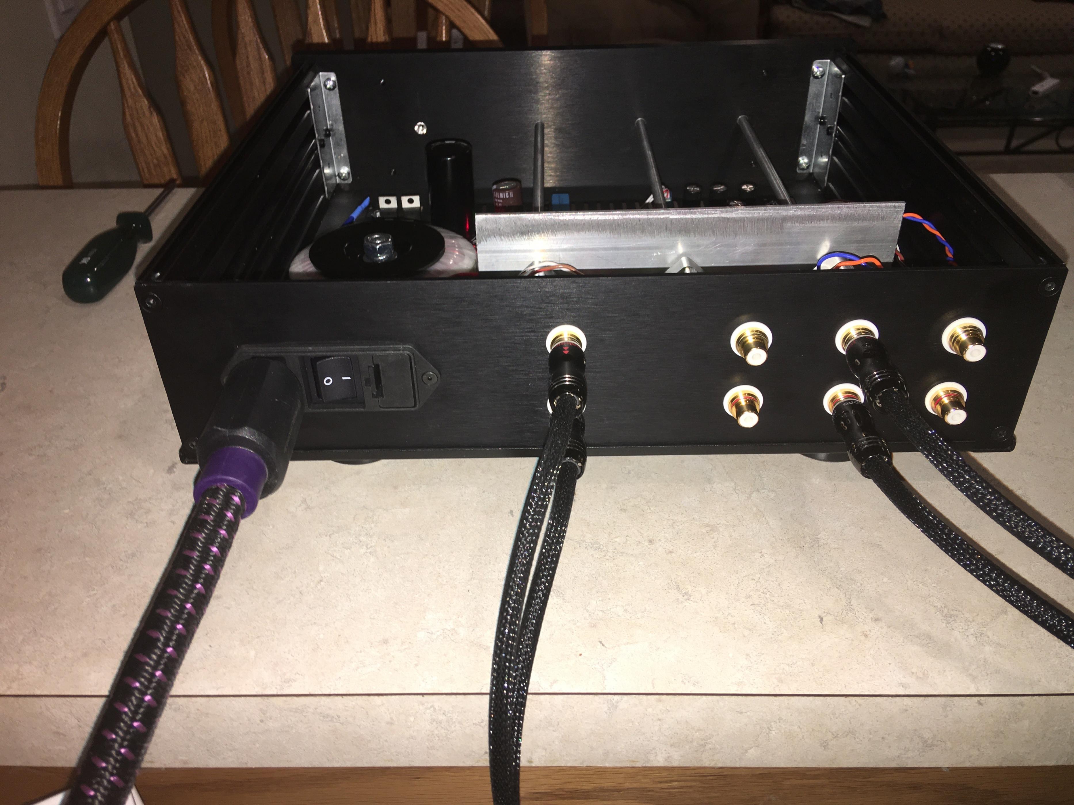

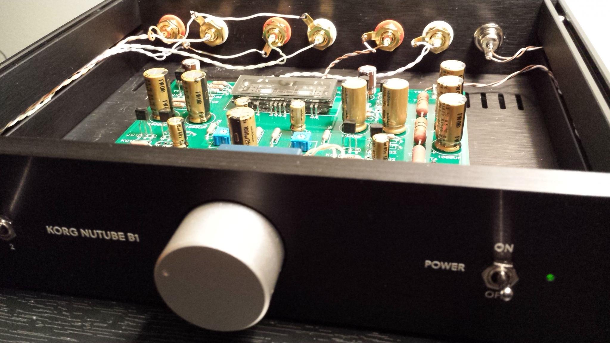

Hi, I managed to snag one of the 2nd wave full kits. It went together with no hiccups and is playing as I type through a M2x into a set of Elsinore's MK3. Sounds really good. I put a piece of carpet underlay under the Nutube then some silicone earbud pieces under the pcb leaving the top nut loosely fitted. Seems to be fine no odd noises yet and its siting a bit close to the speaker at the moment playing with settings. Cheers!:drink:

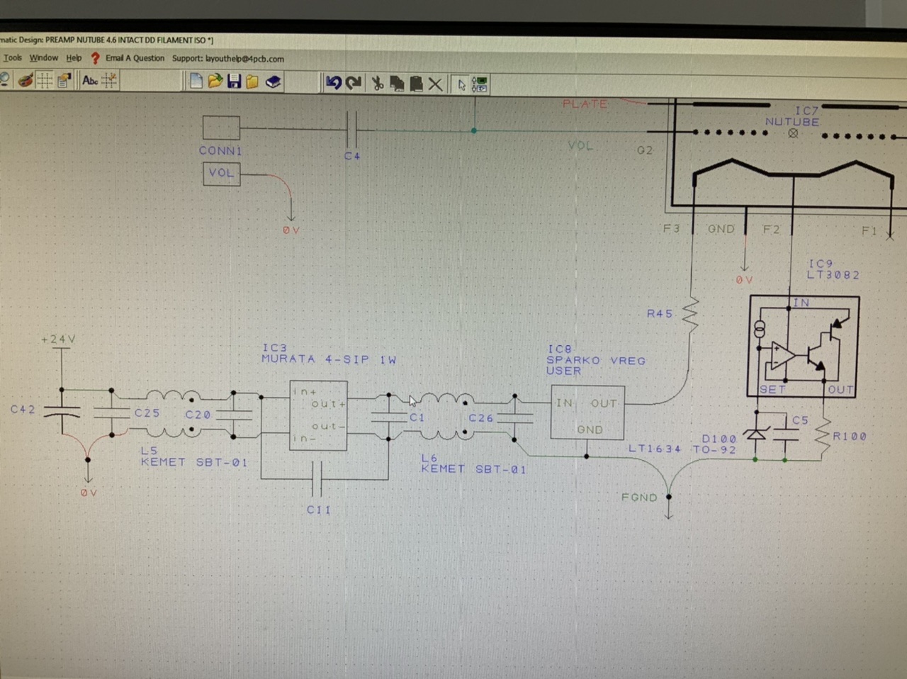

Here you go.. a Coleman style filament supply(45,2A3,211,etc). Isolate the circuit with a dc/dc. Cleanup the dc with a VREG. A resistor to help isolate the supply capacitance from the filament. Finished with a CCS (LT3092) on the backside. Ordering a PCB soon. Should be interesting ��
Congrats on your nutube adventures !
Dwight

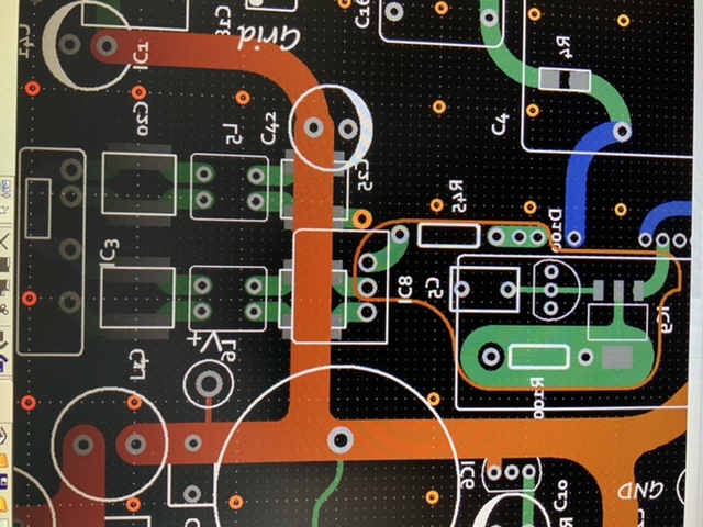

Well this is very interesting. Since I would be modifying the stock pass pcb I can’t use smd parts. But I understand what you are doing. Same thing could be accomplished with chokes and lm7809 on the diyaudio boards I think?

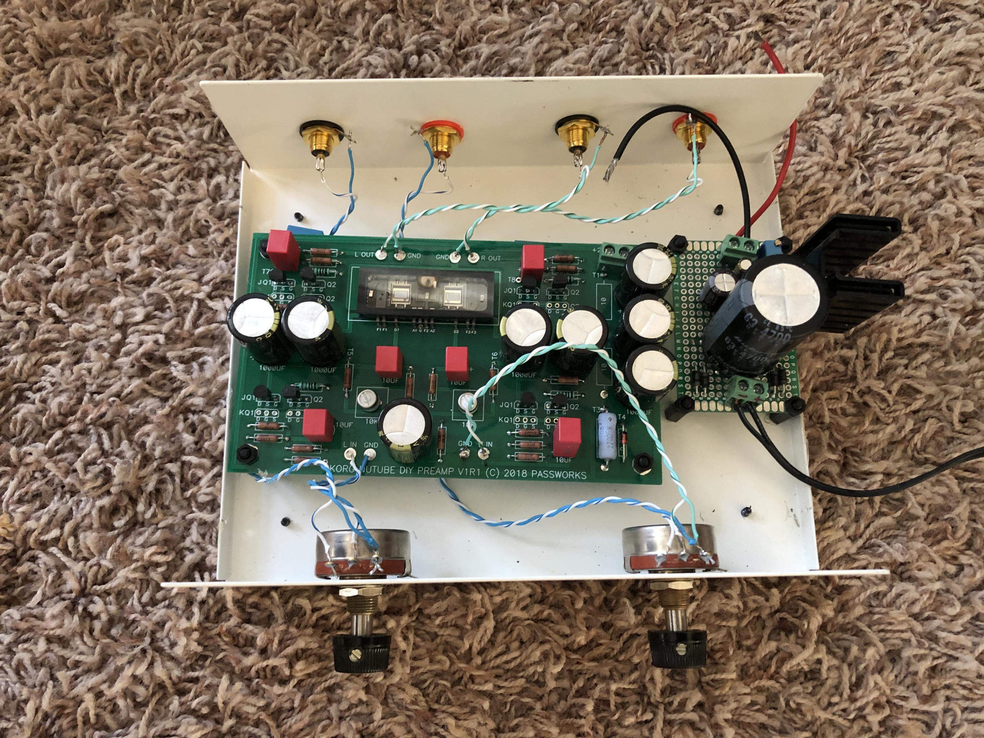

I tried a 32v smps from a laptop followed by lm317. Prefer the linear supply followed by lm317.
My point is not that smps are bad...but rather that this circuit IS effected by pay quality...and that the Onboard RC filters while a good idea are probably not the ultimate solution. Iam not a fan of lm317, I plan to try the jung regulator with more capacitance before the regulator as well.
But to do that I need to sacrifice one of my solid state preamps. Iam close to making that sacrifice...since I can’t seem to stop listening to the korg.
