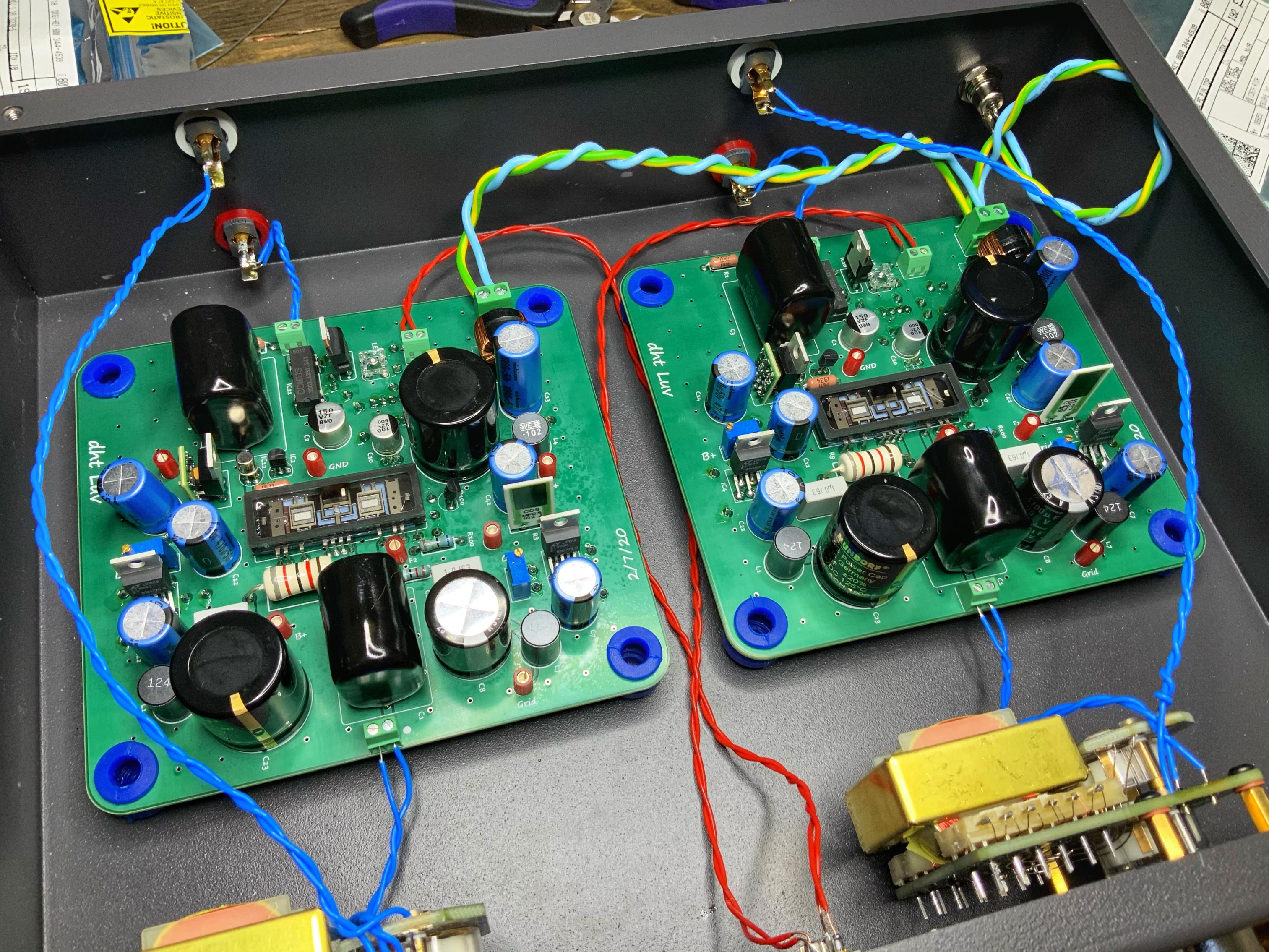

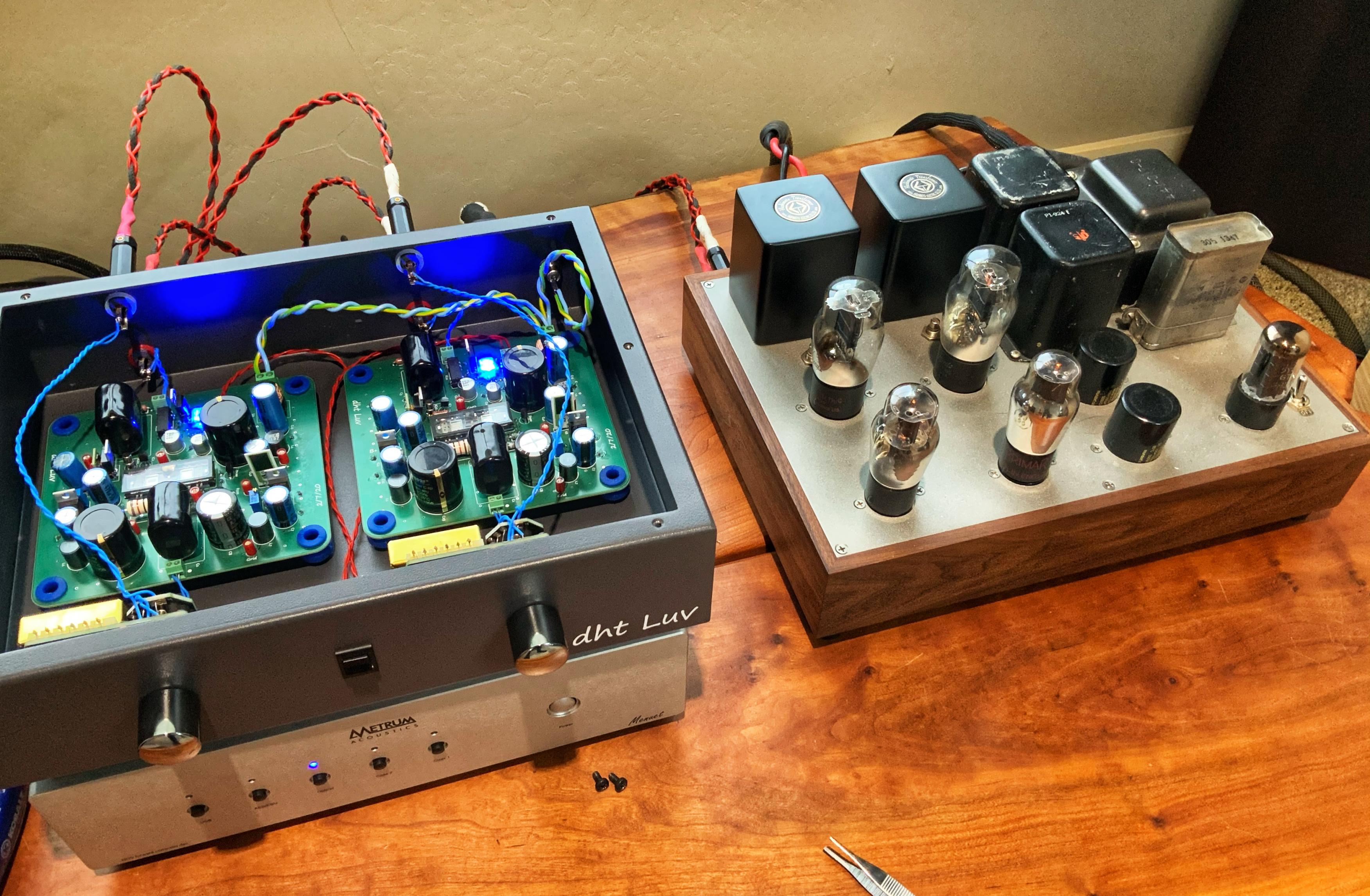

Hello happyrabbit,
nice PCBs and construction. Enjoy the sound!
I love my B1 - NUTUBE - pre! It's a fantastic preamp!
Well worth every minute you have spent on building this nice little sound-machine!
Play with your voltage (positive/negative 2nd harmonic) and try inverting speaker polarity. I think you will be surprised what is going on. 😀
Greets
Dirk

Hello Anthony,
very nice PCB with lots of room for exotic caps.... 😀
Greets
Dirk

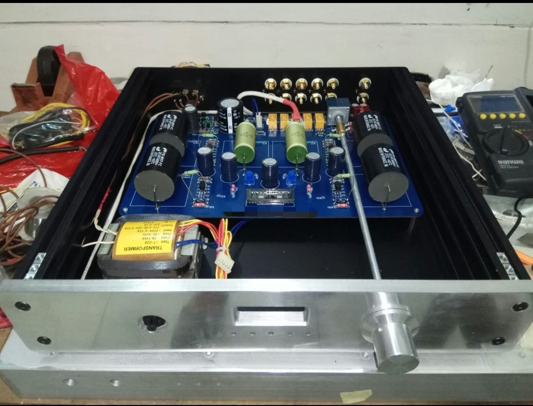

Hi cubic Incher
I didn't make it. A talented local enthusiast designed the pcb. I bought it for my buddy also.
I am going for the vanilla version just to hear the circuit. Just carbon resistors and normal silmic coupling. What papa say makes sense.. Normal materials you can judge the circuits.
My buddy is going to make the ultimate one.. So we can just switch around. I'm sure both sound great.

Hello happyrabbit
Your build has got my full attention, with my usual Pre' being a Slage AVC Dual Mono, your build has drawn me in.
It is inspiring to think of the option to build a version like your model shown 😎
My HiFi room at present has the Power Amp Mono's, close to the Speakers, and the Sources are in need of a 5 metre IC to connect to the Slagle,
when the Pre is set up close to the Mono's.
I can alternate this and have the Pre attached to the 5 metre IC and use short IC's with the sources.
If I were to have a build produced of a Dual Mono again, I would like it to be a two box design, one box per channel, to allow for the option to plug directly into the the Power Amp using a Male to Male RCA Adaptor.
I have for a long time had a curiosity to how this may effect the SQ.
Any thoughts on this method would be greatly received.
