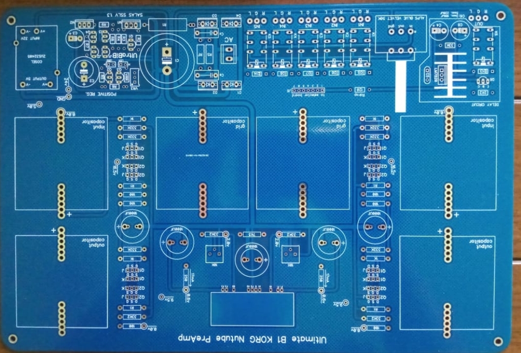

Hello, I have a question:
The Board must be fixed with conductive métal spacers or plastic to isolate it from the métal box ?
I use the diyaudio box
Gilles
Gilles
My board is fixed with metal spacers in an aluminium case. I can see that the holes in the board are connected to common ground, to a peripheral line, around the circuit.

I have a classA power amp that happens to be an USSA-3 from Fab
=> Seems to be a nice amp. To calculate the correct 3rd cap, you need to know its input impedance. I happen to follow Fred's excellent works. I don't remember for USSA-3 but I believe it is likely to be the same input impedance as USSA-5, which I believe is 22k (as probably the rest of his line up?). If so (you can always ask Fred), any cap value equal or higher than 1.4uF is fine in your case for the 3rd cap.
Note though that going for 3uF is a safe bet for the future in case you should use one day a power amp with an input impedance as low as 10k... but indeed today it appears it is probably not your case.

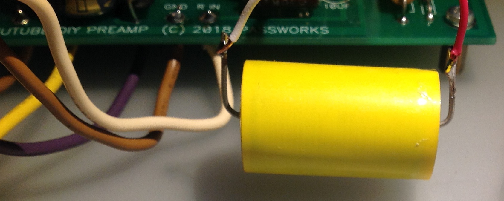

Well well well, I am getting a very nice support here from you dear members.. That's very kind of you, and this is all about the real original spirit of this forum and diy. Teach, learn, enjoy end share. Thanks a lot. Enough of this.
I choosed my caps. The choice is based on the caps I have and the experience I had with them, in some circuits where the sound differences are easy to discern.
- So cap one, for input, Sonicap 0,33μf in parallel with Mallory 22nf. Sonicaps are very good for me, transparent, but there is a certain "coldness". Be aware, they are musical. This coldness is a known characteristics about this series. It is often used with a litle "warmer" Sonicap in parallel from Gen2 series, more warmer; Mallorys do this trick very well. I like it. It will do no harm.
- Cap two, triode, Mundorf Silver Gold oil. This belongs to the white case series. It is for me very melodious, sweet, very rich, refined, nice tone and balance. No need of extra cap in parallel. It has a light sound, kind of ethereal.
- Cap three, output. Mallory 2,2μf in parallel with Sonicap, from the "cold" series. BTW, this is the Gen1 series. The Mallory is well balanced, simple. It doesn't make mistakes, it is not ambitious. Makes everything better but does not excell in any department except the nice balance. It is warm. Coupled with a 0,1 Sonicap Gen1, this couple sounds more "audiophile", in a good way, less boring with more details and musicality. I bet it will be well paired with cap two. Cap 3 is more down to earth, if you allow me a bit more of lyrism.

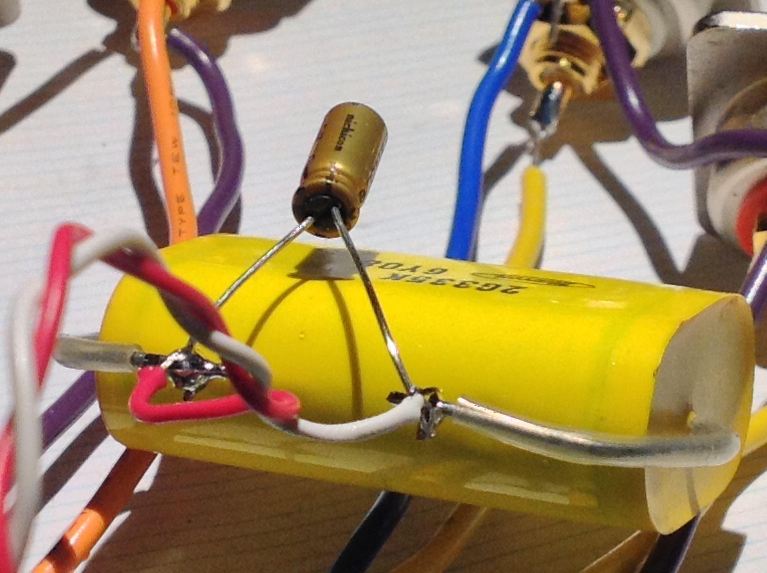

I would like to use a Mundorf Silver oil in the input, but I remanber now that I installed them in a power amp.
..I will try to make this upgrade today..
Keep electrochemical 10uF caps and bypass them ( solder in parallel )
with a small no polarised capacitors is another interesting option 🙂
Maybe solder two wires at (+) and (-) of cap soldering points for tweak time.
So You can enjoy experimentations is safe conditions.
With all this heat and mechanical changes is easy to damage pcb.
Best regards
Ok, good idea, I can solder and desolder the legs of the lytics to those of the films, so the board will not be touched or damaged. My 10μf lytics are non-polarized. The holes in this board have very thin and litle pads. I will use good desoldering braid to avoid machanical stress on the holes. At worst, if a hole is damaged, I will solder the cap's leg to the next contact, following the trace, but I really don't like to do this, have to avoid it. The soldering tip is very thin and the station is good.
