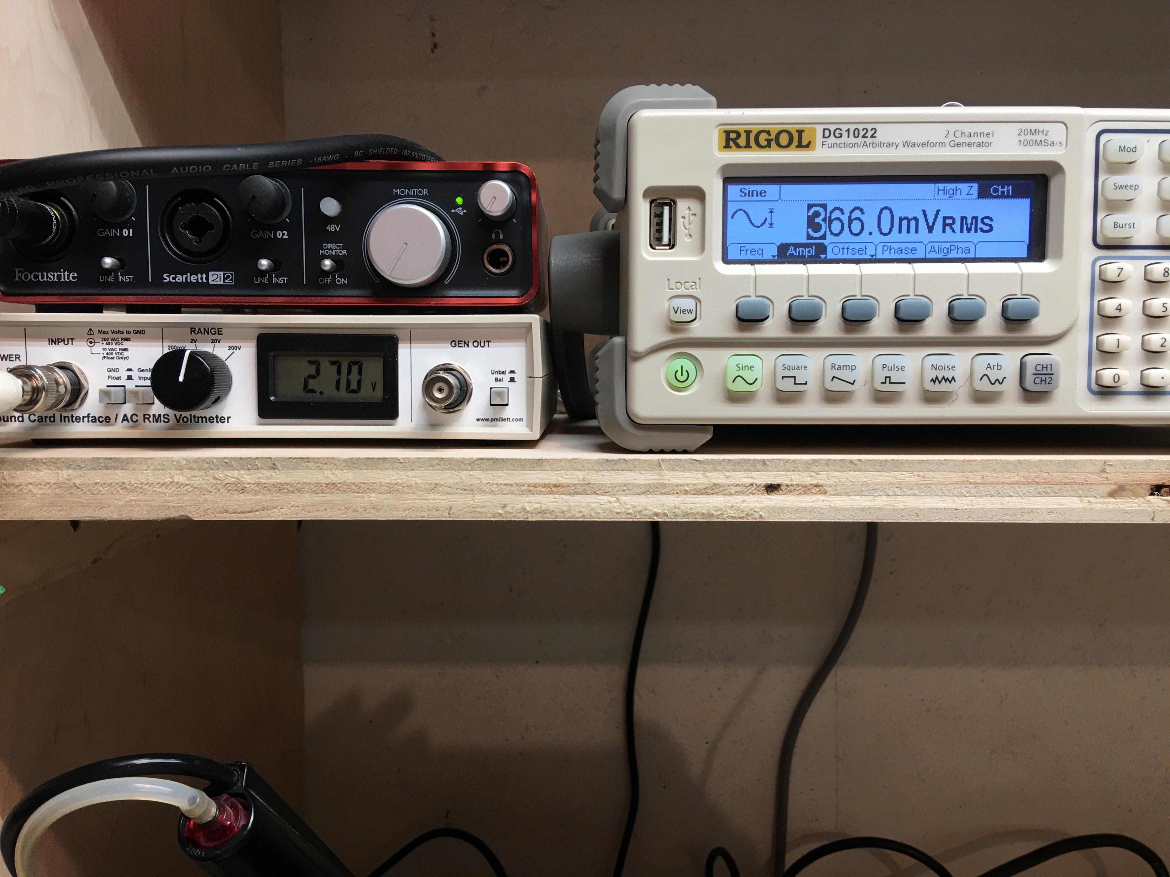

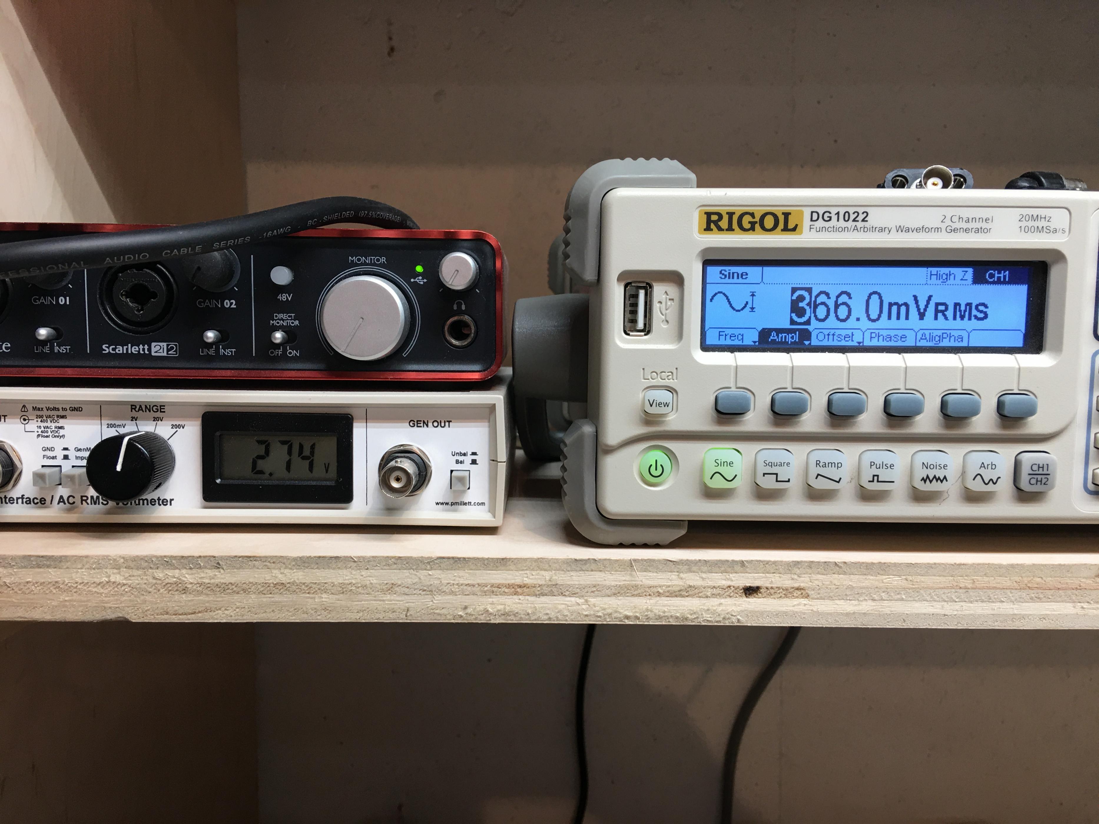

Thanks Kevin! Completely understand your logic 🙂. At full output with 1Khz test I downloaded I was getting 366mV, with the 50Hz test track from the Dayton Omnimic kit I get 466mV. So the 1Khz test track was created at a lower level. With the alps pot at full volume I get full voltage at both channels at the input block on the board. With music it goes way higher - the Dragonfly v1.2 is capable of 1.5v output.

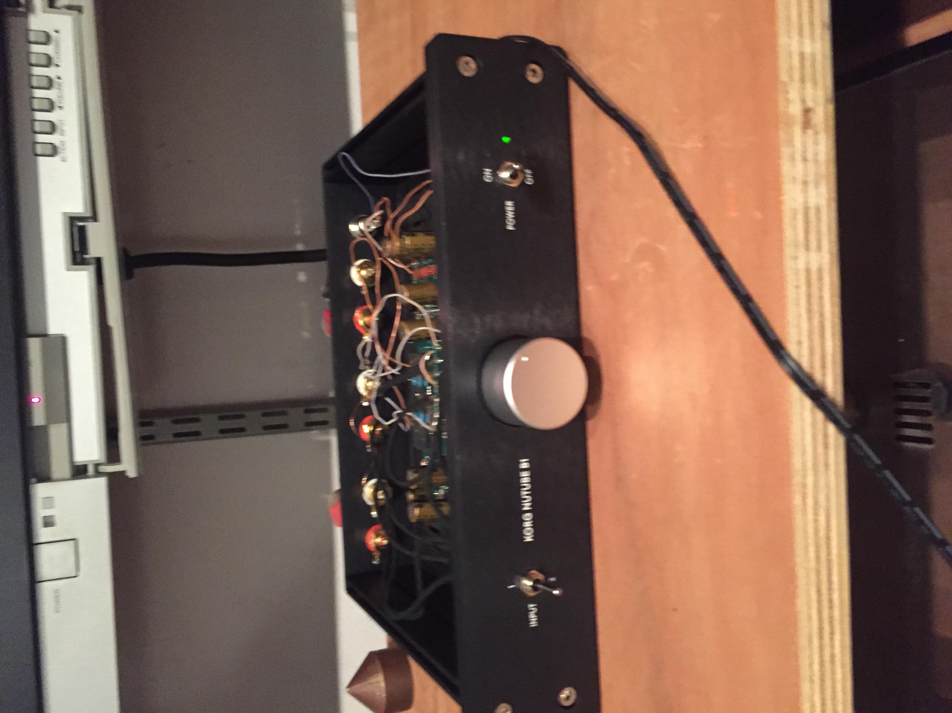

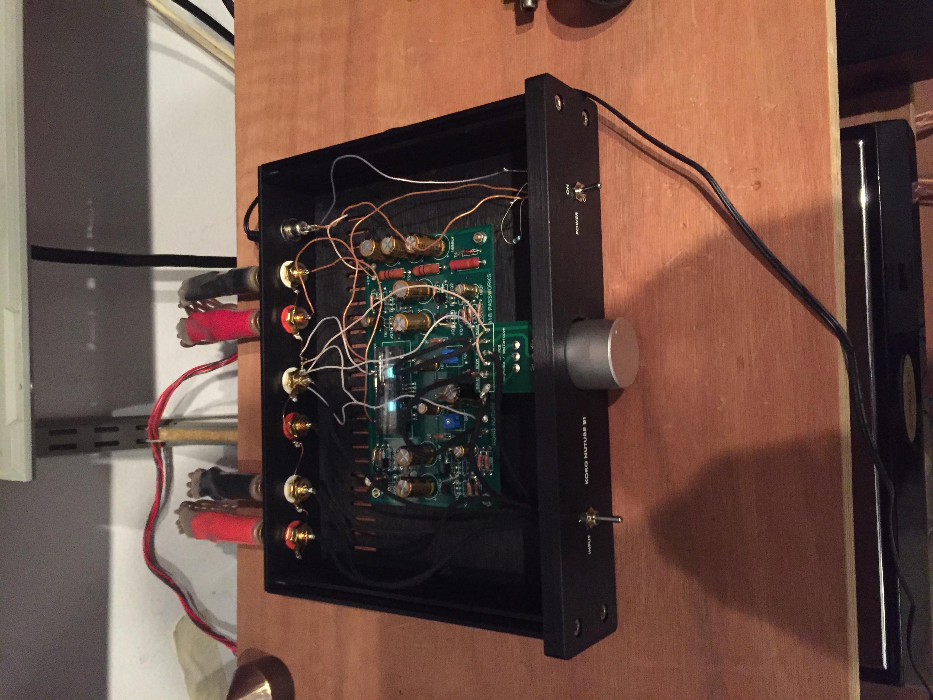

My B1 Korg build...
For a friend. Testing it now. Sounds wonderful! All voltages were as supposed to be with a smidge touch of the pot dials. Have to organize better the wiring. Big soundstage and dynamic. I’ see how it compares with my ba3 LS. Cd transport 47 Lab Shigaraki, dac Twisted Pear Audio B3 SE, Pass xa25 and F4 amplifiers. Spatial Audio M4’s TM and diy pair of Ripole subwoofers.

I just completed the B1 with Korg NuTube preamp board (not the complete kit). I installed it in a chassis with a ClassDaudio CDA-120 Class D 2 channel amplifier. I had incorrect connected the + output on the left channel to the - input of the power amp. The left channel doesn't work. I checked for signal with a scope and it seems the Korg Nutube output on that channel is missing or low. Wouldn't the buffer output FET's protect the Korg? Is it more likely for the FET to blow than the Korg? I'm going to check my soldering and all voltage levels tonite maybe its a construction issue.
Well, now that it has been like two weeks, I can't say exactly how the channel balance was upon first use, what I recall the most was the imaging wasn't as good as my current preamp. Clearly channel balance can affect that, so yes, it probably never worked right from first use. I do remember listening to White Stripes on the second day and wondering why Jack and his guitar were sitting just inside of the left channel instead of exactly center lol! Still sounded good 😛 The very first thing I listened to was Pink Panther and I didn't notice the imbalance, just that it wasn't imaging properly.
An Akitika GT101 kit.
That thing has a poop load of gain (~26db). So if you put 1mV input to the Korg B1 (gain of 15.3dB right and 16dB left) by the time it gets through the amp to the speaker binding posts there will be about 1V difference between the channels (11.6 right and 12.6 left). Someone please correct me if i'm wrong (my math skills aren't that sharp). Makes sense you're hearing Jack and guitar to the left of center.
I know this isn't helping resolve the issue, just helping me get my head around it. That's about all the help I can give right now...my preamp is at the machine shop with all the guts still inside it :bigeyes:
I ordered some new heater resistors (510 ohm) just to bring the heater voltage closer to spec, I had to order other parts anyway, we'll see what happens. Yes, that math sounds like what I am hearing.
