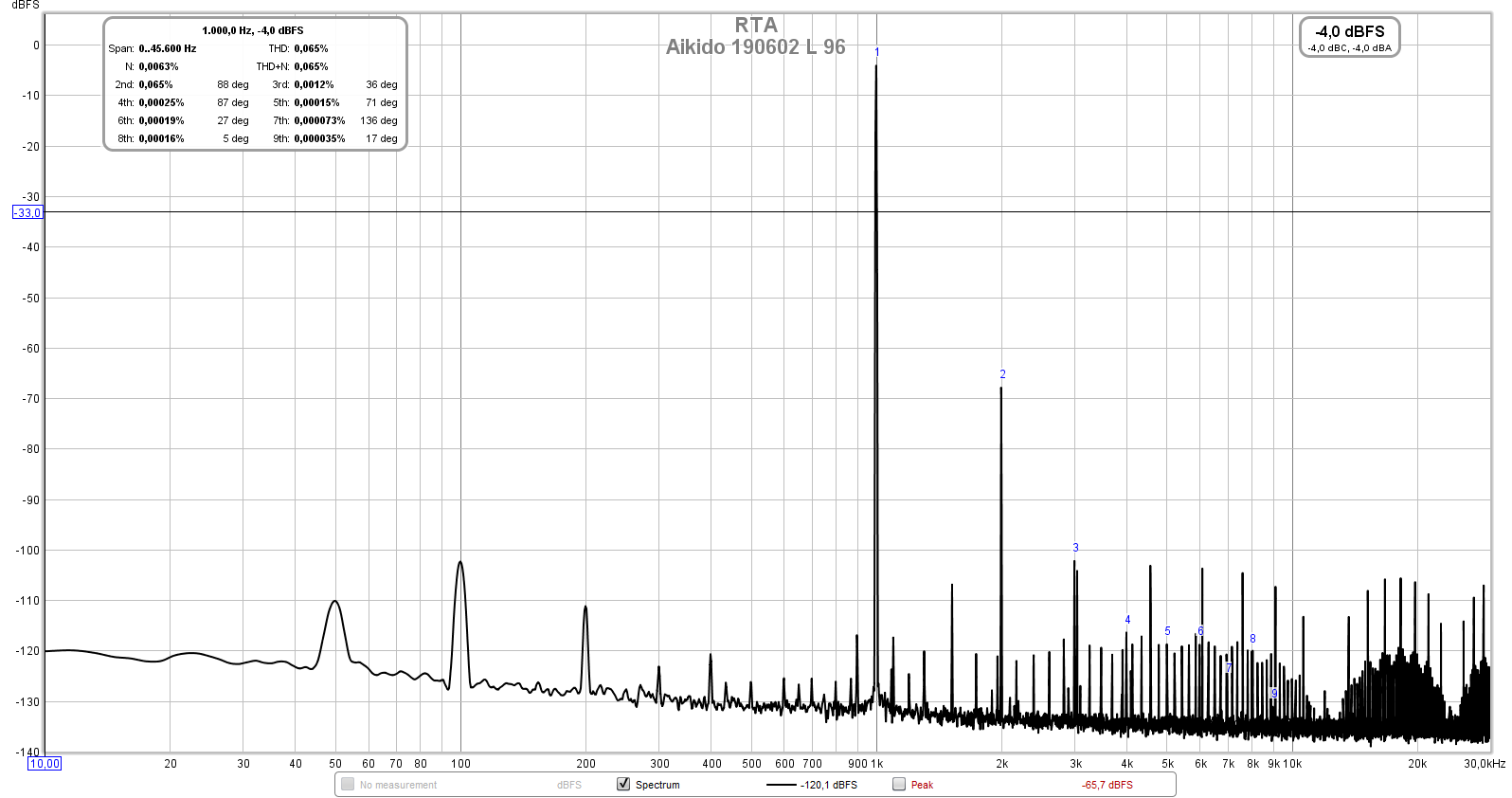

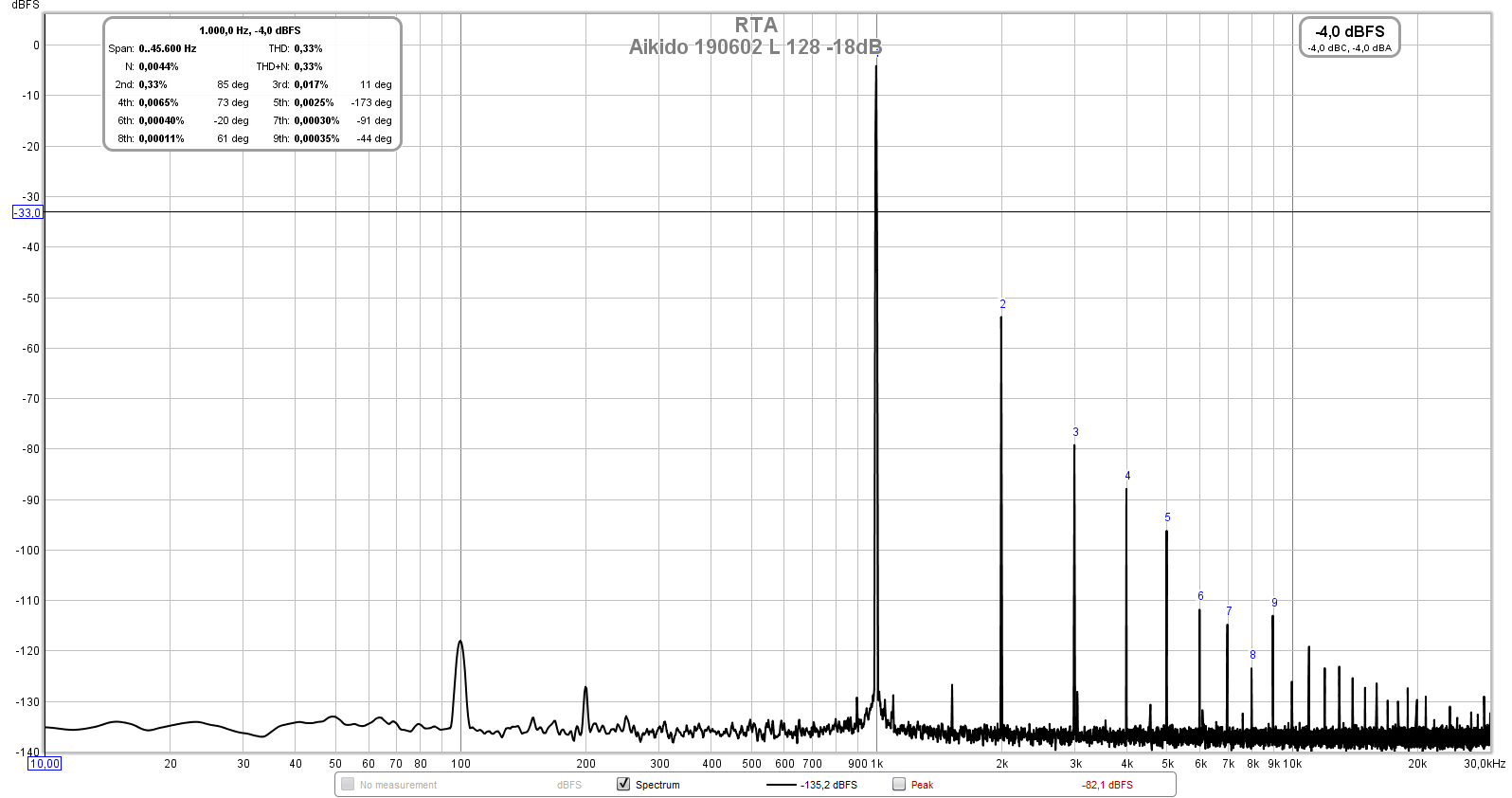

I don't have an Aikido with 6SN7s, but here are some measurements from my Aikido that's running E80CC / 6N6P:
First one is at 1.5V RMS out. Ignore the hash to the right of 1 kHz; that's coming from the control circuitry or display of my relay-based volume control.
Second one is at 10V RMS out ...
At a more realistic output level of around 0.7 V RMS, I get approx. 0.02% - 0.03% THD. So not much distortion or H2 in the Aikido ...
Regards, Claas
