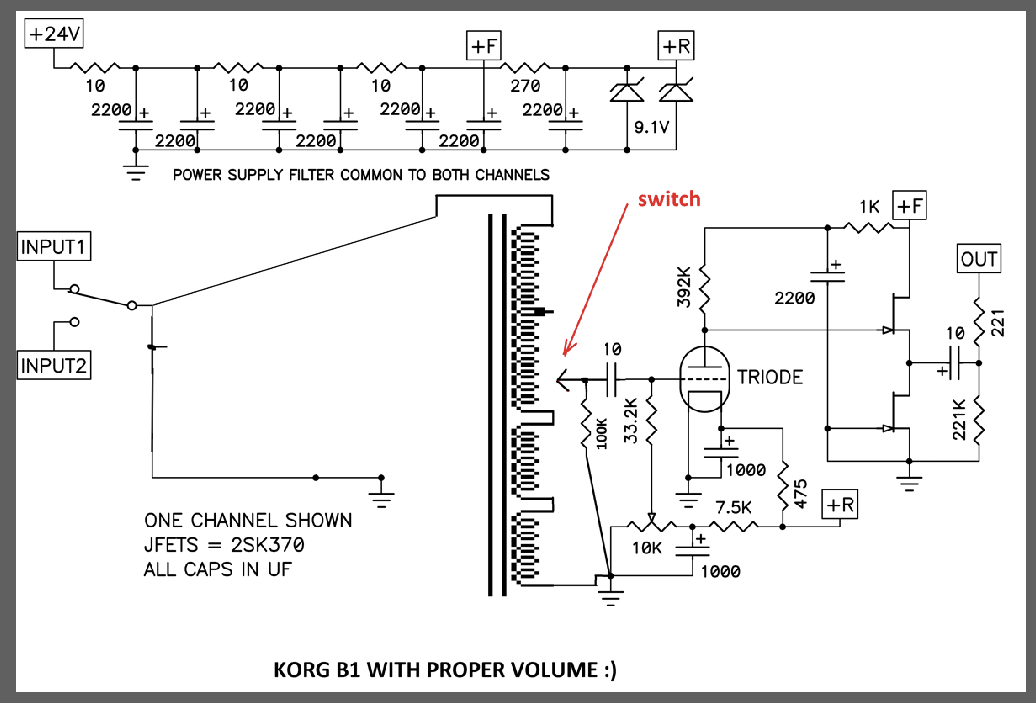

Like this: (it's an ugly markup I know especially since the grounding at the input jack is not addressed correctly)
As for the gentleman that previously suggested separate boxes, if wired as shown, a DPDT could be added as an active passive solution in the same box.
here's a quote from earlier in the thread:
"Thanks to Zen Mod, I realized that these 3 caps act as part of a high pass filter, meaning in practice that altering their value would affect the band pass in the bass. The smaller the cap, the higher the high pass cut frequency."
Can the input cap go away leaving only the RC coupling at the output? If so, what is the appropriate value?
yup, that would be OK
F=1/(2 x Pi x R x C) , where R is Rin of stage (roughly 33K2) and C is size of coupling cap , which you need because input grid is on pos. voltage potential
for F shoot for no more than few Hz
Hmmm....
If my algebra (arithmetic) is correct:
- 10uF produces a cutoff ~.5Hz
- 1uF produces a cutoff ~5Hz
- 2uF produces a cutoff ~2.4Hz
Looks like anything 1uF or above given the fixed R value is likely good. (Which is what NP said in his writeup anyway...)
And for clarity, the input cap IS required?
