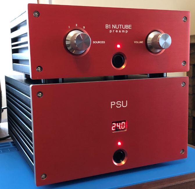

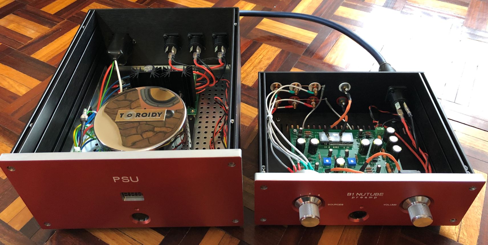

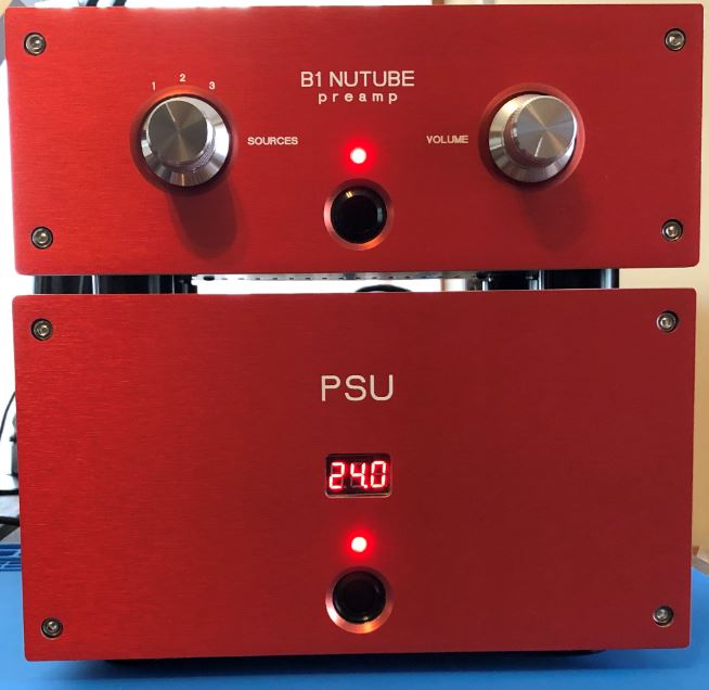

B1 with Korg Triode
Happy New Year!
Here’s my take on the B1.
T7/T8 at 9.5V, no smoke and … great sound :)
A big thanks to Nelson Pass and to the DIYAudio crew for another top-notch project.
Next on the workbench: F5, M2, F6 and single-ended Class A Sony VFET (providing I’m able to grab a kit that is).

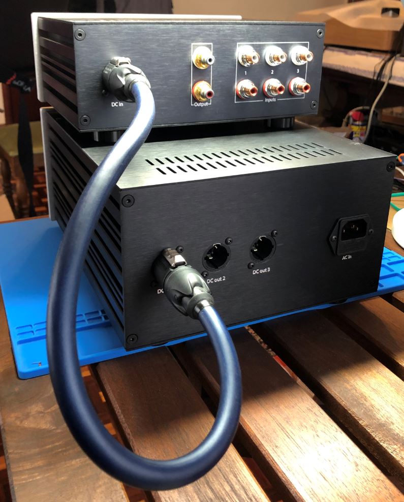

I see….so it is a Neutrik.
Have you connected the shields to Gnd?
I once asked Neutrik which connector you use for DC current and they recommended the SpeakOn connectors. Reason was that they only specify AC current for their connectors. With Korg both types are "overkill" :)
I always find terminating connectors quite time consuming…….and not the fun part of DIY.
I didn’t connect the umbilical cable shields to GND to prevent AC earth ground leaking noise into signal ground.
Grounding was done as follows: the PSU chassis => AC earth, B1 chassis => signal ground.
Indeed terminating connectors is not exactly the best definition of fun; at least we develop our craftsmanship :smash:
to Allvey
Fantastic KORG NUTUBE Pre - build!!!
:cheers:
Greets
Dirk
p.s.: I have often used the NEUTRIK XLR - 4 pole connectors for my builds
between PSU and PREAMPS or PHONOAMPS. Works very nice.
I use the 4-poles to not interchange them with the 3-poles for symmetrical
signals. Most of them are rated up to 16A / 50V! Far enough if you run
on 24V and under 1A.
I have to look for those NEUTRIK powerCON TRUE1 TOP - very nice!
Yes, but high DC current is more difficult to handle for a contact. But for preamp current use it does not matter of course. The current rating in Neutrik data sheets are all AC current because that what the connectors are made for.
This is the official answer I got from Neutrik when I asked about DC current:
"I would not recommend to use the PowerCON for anything else than 230V applications as it is “sold as such” and you will run into the risk that someone “hooks it up to 230V” and you will have to “re-order”…..
Yes, all of our products are AC rated as we originally are a company that designs and produces for Audio applications. And audio is AC…..
However, that does not mean that our products cannot be used for DC but as our ‘Target Market” has hardly any interest in that we do not specify those (DC) properties.
I could recommend our Speakon line of products, made for higher currents and lower voltages (less risk when mixed up with other applications). They basically have the same form factor so that should fit you as well.
speakON | Neutrik"

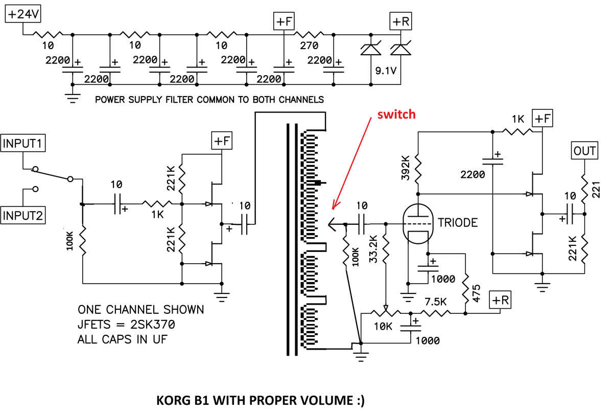

I have a Tribute Autoformer Volume control not currently installed anywhere. The Tribute inductive volume control has a DC resistance of only 33 ohms...
If I wanted to use this instead of the 50k pot specified, can I bypass the input buffer? What about the 10uF cap connected to the "grid" of the NuTube? Can this be deleted as well?
Kindest regards,
Chris
I'm not an EE. Any takers?
