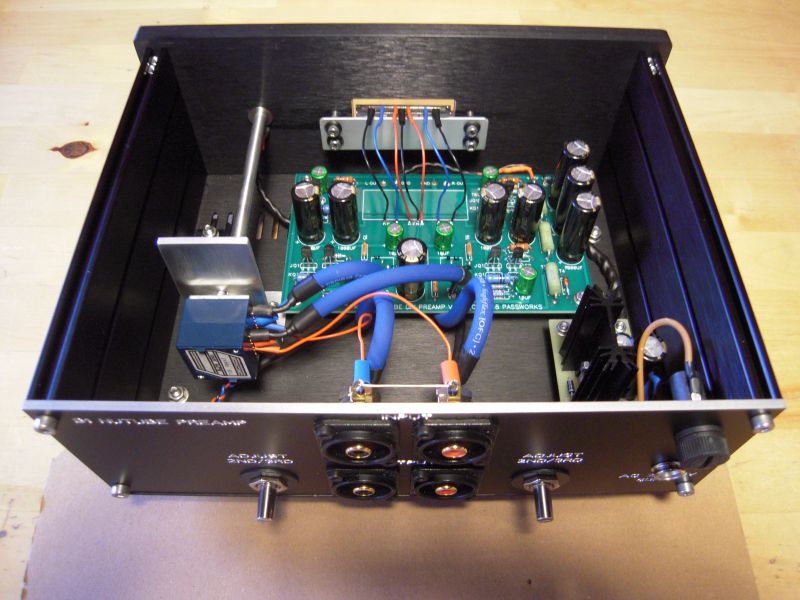

This board has switchable input but I couldn't fit 3 pairs of RCAs on the back. Instead I've drilled out for a 3.5mm jack in between those 2 visible pairs, only I've run out of jacks and didn't want to show the hole..
Curious question: what's the 1/2 switch on the front used for? I only see 4 RCAs on the back.

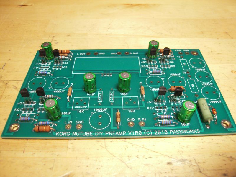

I have used the NICHICON greensleeves / 10 µF / 50V in my B1 NUTUBE.
Sounds very good.

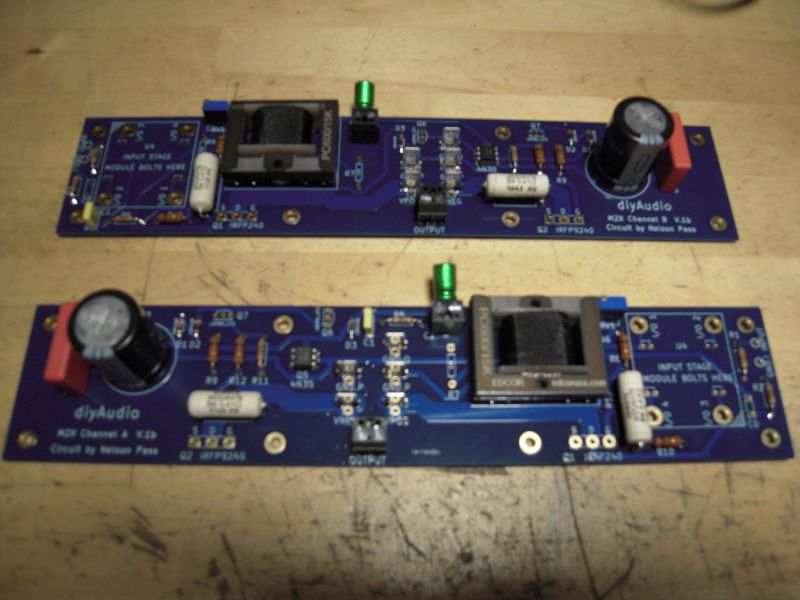

In my M2X I have changed the coupling cap from the NICHICON greensleeve to
a MUNDORF cap (C2 between EDCOR and follower stage). The differences
are marginal but audible. The discrepancy in the price is not marginal!
There is more difference changing the inputboards in the M2X. But they all sound good - each inputboard with its own 'character'.

Some pics of the NICHICONs in the B1 NUTUBE.
And in the M2X (the coupling cap is screwed in a screw terminal block -
easy to exchange - no soldering).

Wow this thing really is microphonic; my clunky Valab stepped attenuator causes whistles through the right speaker. I need to find a better means of damping the Nutube. Sounds good though
The xmas gift board from Mr P rings like a bast**d. I'm not blaming the board rather the Nutube itself or the way its mounted??.
The DIYstore board and the second Nutube is very quiet. Both were built with identical components and both tubes purchased from RS here in the UK but at different times some weeks apart.
The xmas tube it fixed (soldered) directly to the board where as the DIYstore board tube is on flying leads and on a foam suspension arrangement.
I'll be having a look at the xmas tube and detaching it from the board and mounting remotely with flying lead and a suspension kit. Not sure how much heat the tube will take for a de-soldering exercise. ??
