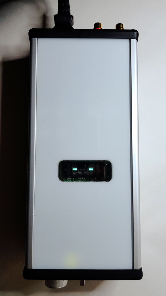

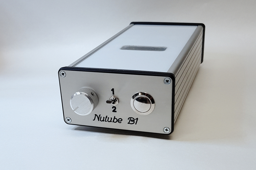

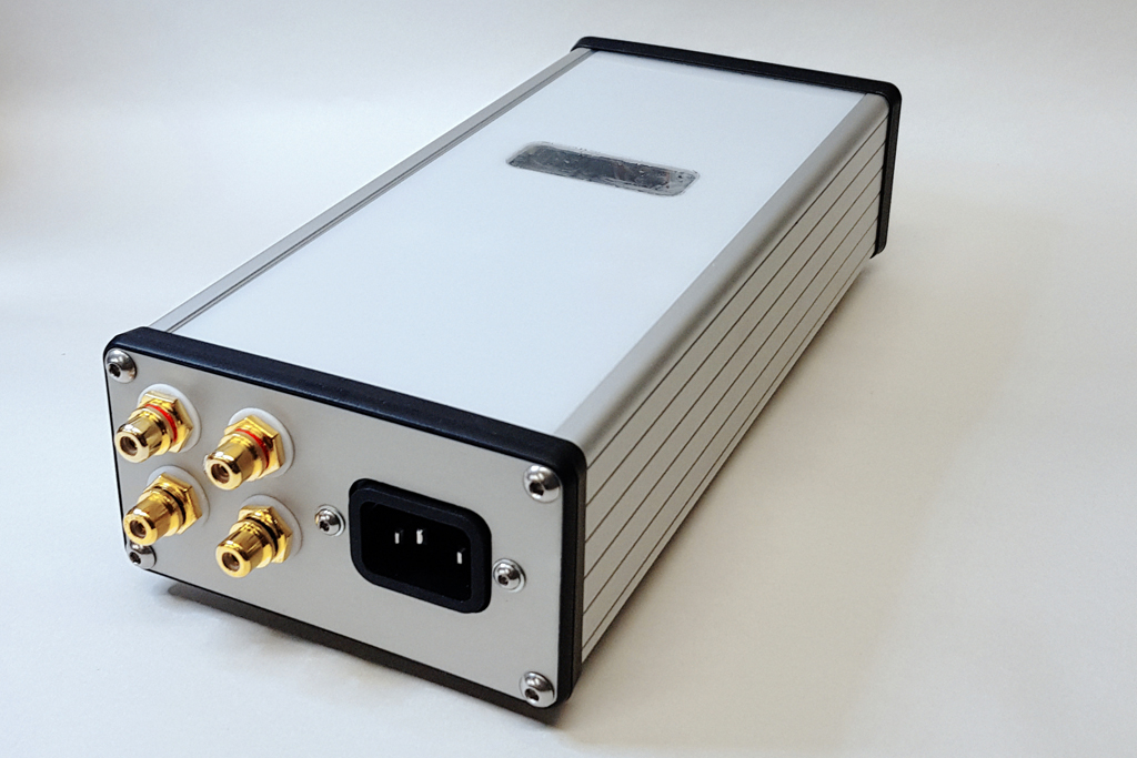

I'd just like to say thanks to Nelson for the circuit (sounds superb) and to all the other contributors that have put their time into guiding us mere mortals.
Thanks also to Algar_emi whose PCB layout I built.
Pretty happy with how this one turned out and how it sounds.
I'd just like to say thanks to Nelson for the circuit (sounds superb)....
Curious question: what's the 1/2 switch on the front used for? I only see 4 RCAs on the back.
- B1 with Korg Triode
