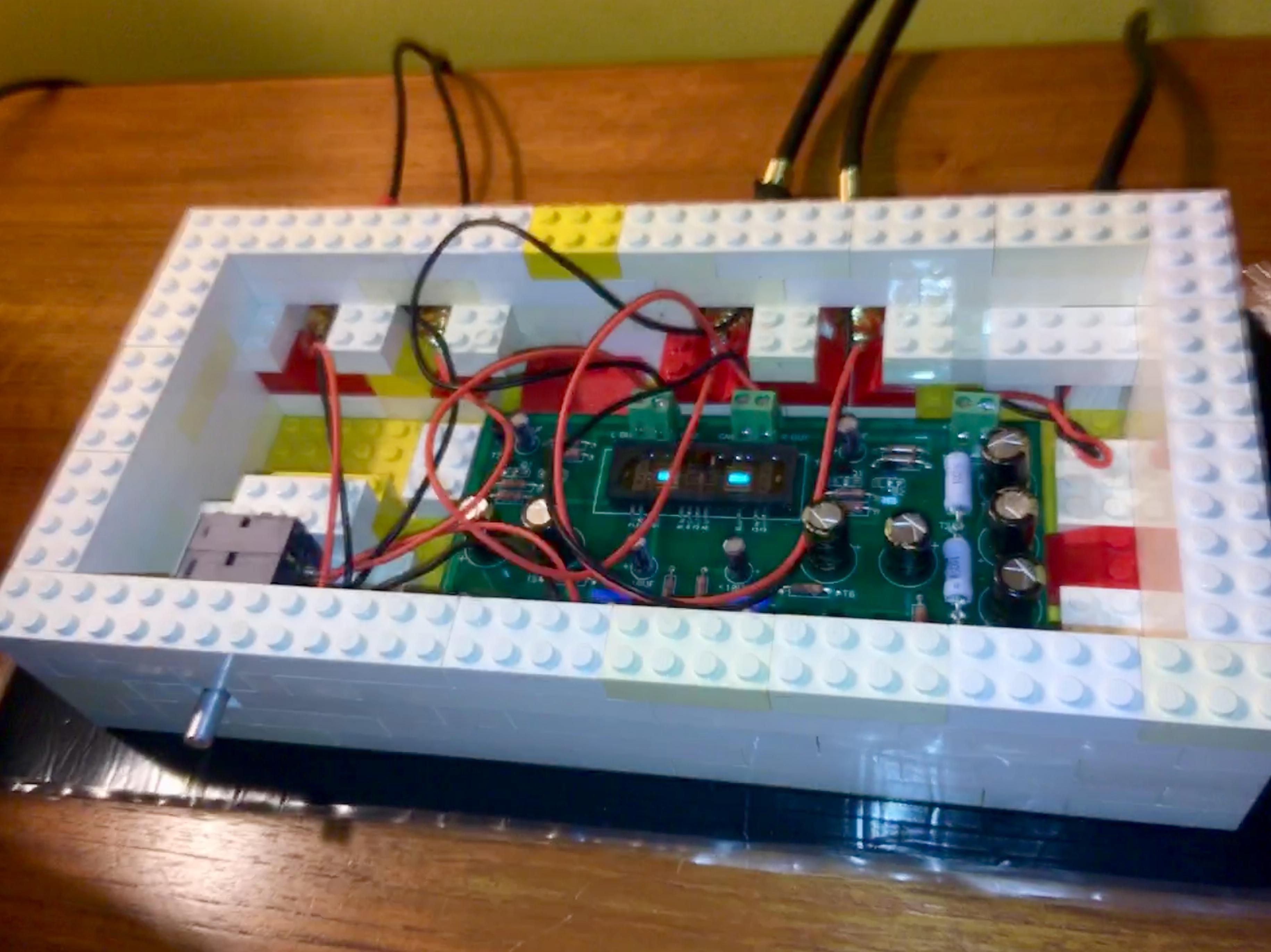

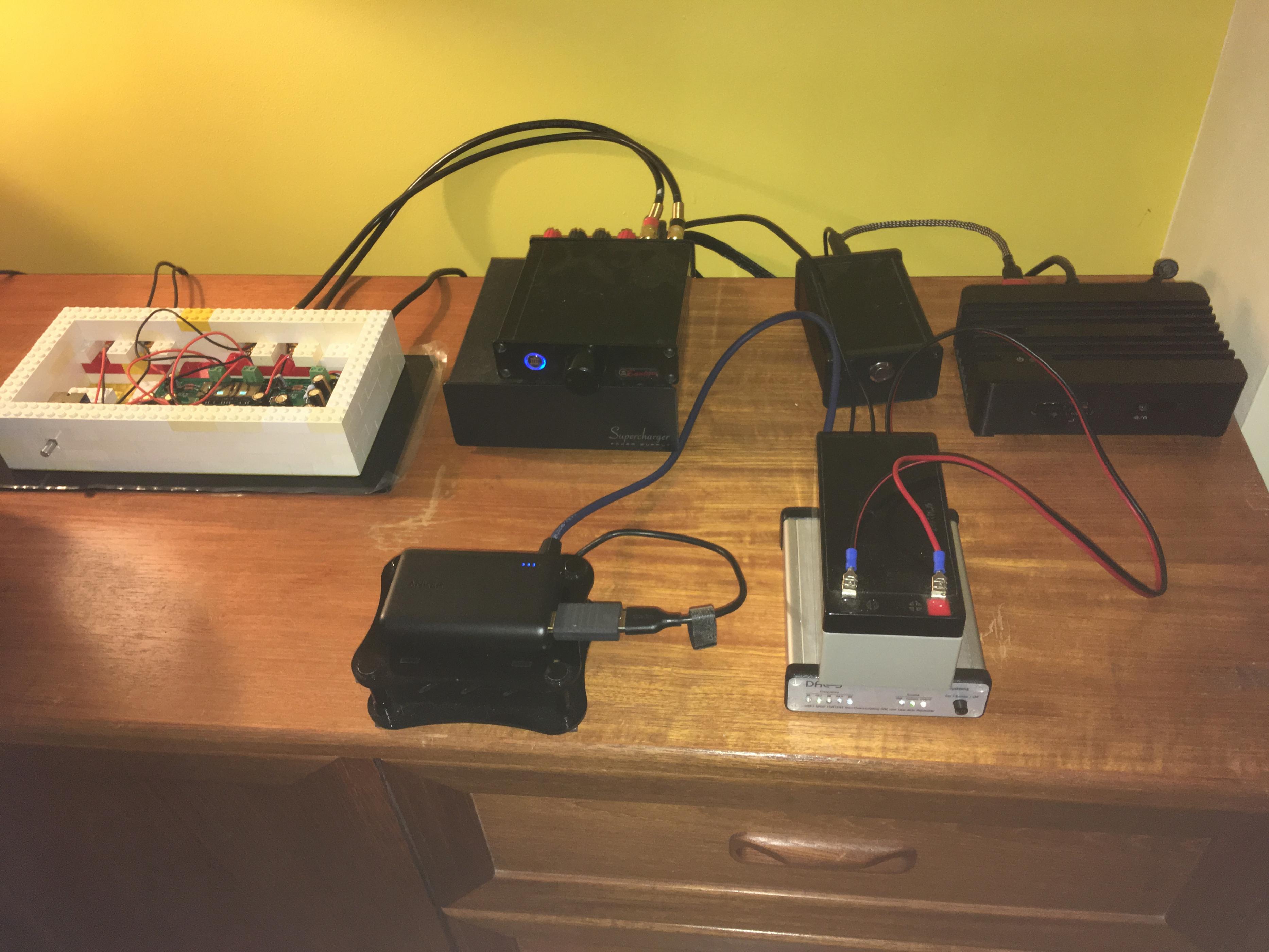

It lives!
Well, after a couple of false starts and some smoke (turns out wiring up the DC socket correctly is important) I have sound, I'm thrilled.
No indication of any microphonic issues (at low listening levels); I have the Nutube sitting on a 3M sticky foam pad. The Lego case is currently sitting atop a 30 duro (very soft) Sorbothane pad which will go inside a more permanent enclosure which is in the works, with the PCB sitting on top on plastic stand-offs.
Next steps - thinner gauge wire; save up for a shunt attenuator; try Charcroft Z-foil 100 Ohm output resistor; add second input and toggle switch; add power on / off rocker switch.
Sounds great at 9.5v and phase corrected at speaker terminals - I'll hook it up to a distortion analyser and experiment with different values.
I narrowly missed a pair of Cinemag output transformers on flea bay - maybe this is something to try to correct the phase before a headphone amp.
What a ride it's been!
LOVE the Lego chassis! A favourite toy/past time when I was a child. Still love building basically anything with my Son using Lego.

Holy ****...best enclosure ever! Never thought to use Legos!!
Wow...the Lego case is just awesome!
He should get some Roaylty from Denmark for that design.
Lots of love for the Lego. Took me about 45 mins using whatever was in the box. I'm thinking about upgrading some of the bricks to Tantalum though.
:cheers:
