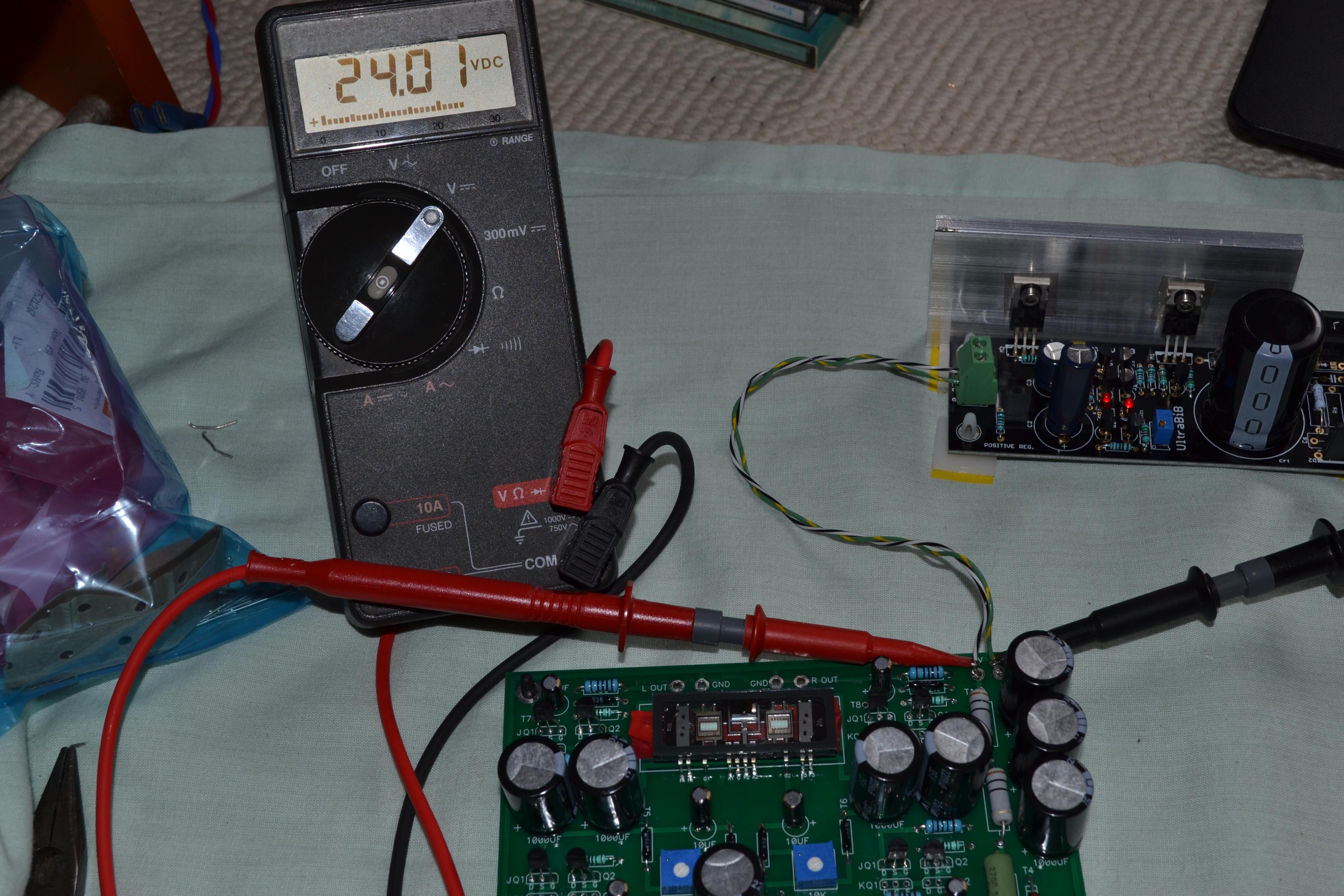

Before listing my measurements, I should mention that I received the Jfets in two bags. One hand marked Q1 7.4, the other Q2 7.4. The resistors that were included were 220 ohm.
I measured across R1 at the four positions. These were my readings:
Ten o’clock (J113): 1.65 V —> 7.5 mA
Two o’clock (J112): 1.64 V —> 7.45 mA
Four o’clock (J112): 1.62 V —> 7.36 mA
Eight o’clock (J112): 1.63 V —> 7.41 mA

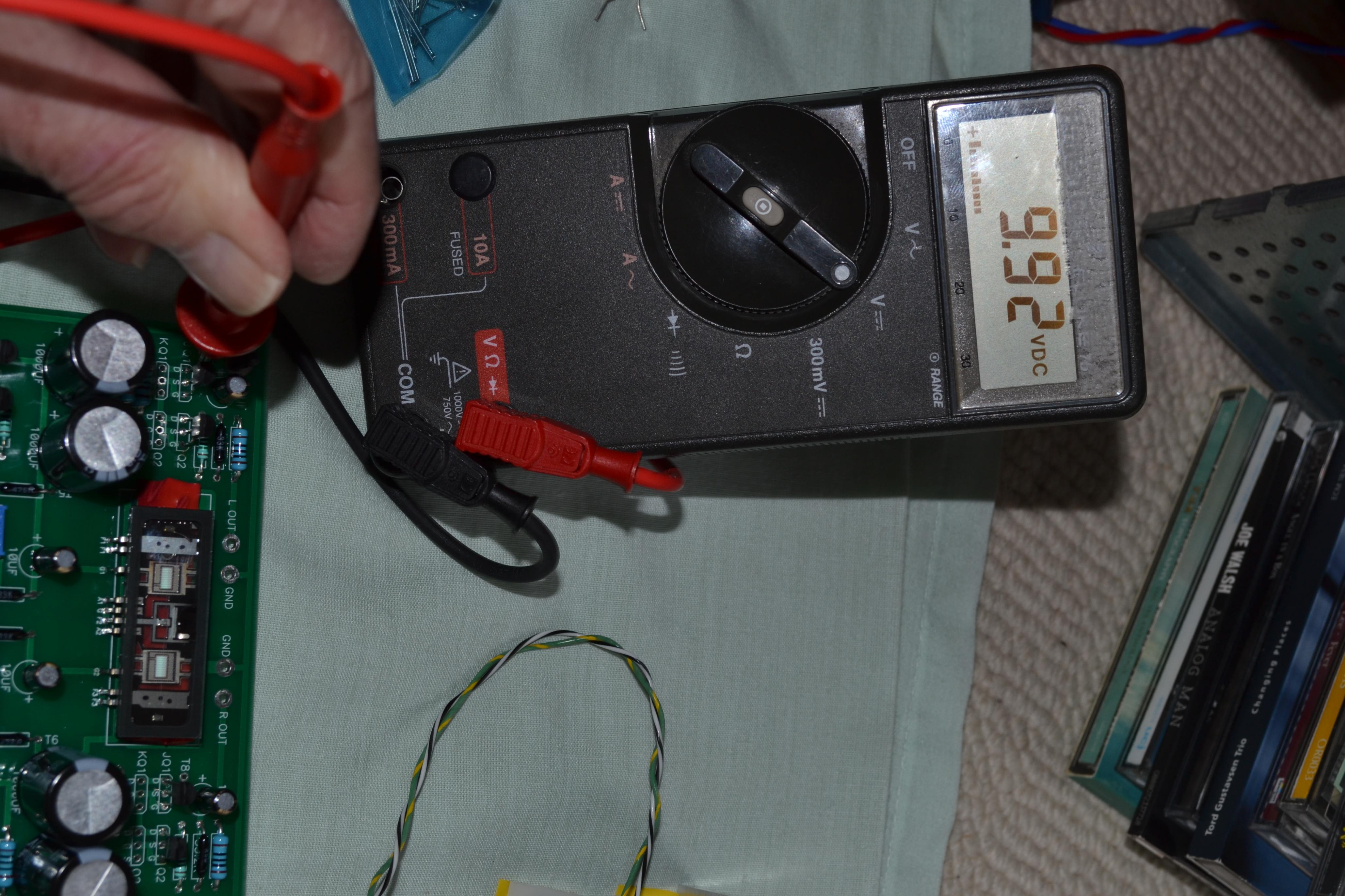

The rest of the circuit, after about 75 minutes, adjusted, everything very stable:
T1= 24 V
T2= 23.2 V
T3= 22.4 V
T4= 9.28 V
T5= 0.66 V
T6= 0.66 V
T7= 9.50 V
T8= 9.50 V
I have not listened yet, maybe tomorrow.
Thanks.
7 mA or a bit more is not a problem, but you are welcome to some
replacements. Alternatively you can raise the resistor value.
There are large piles of Jfets laying around, and probably the 112's got
swept into a "retest" bin with all the others whose Idss was greater
than 7 mA. Same chip, these are used for constant current sources.

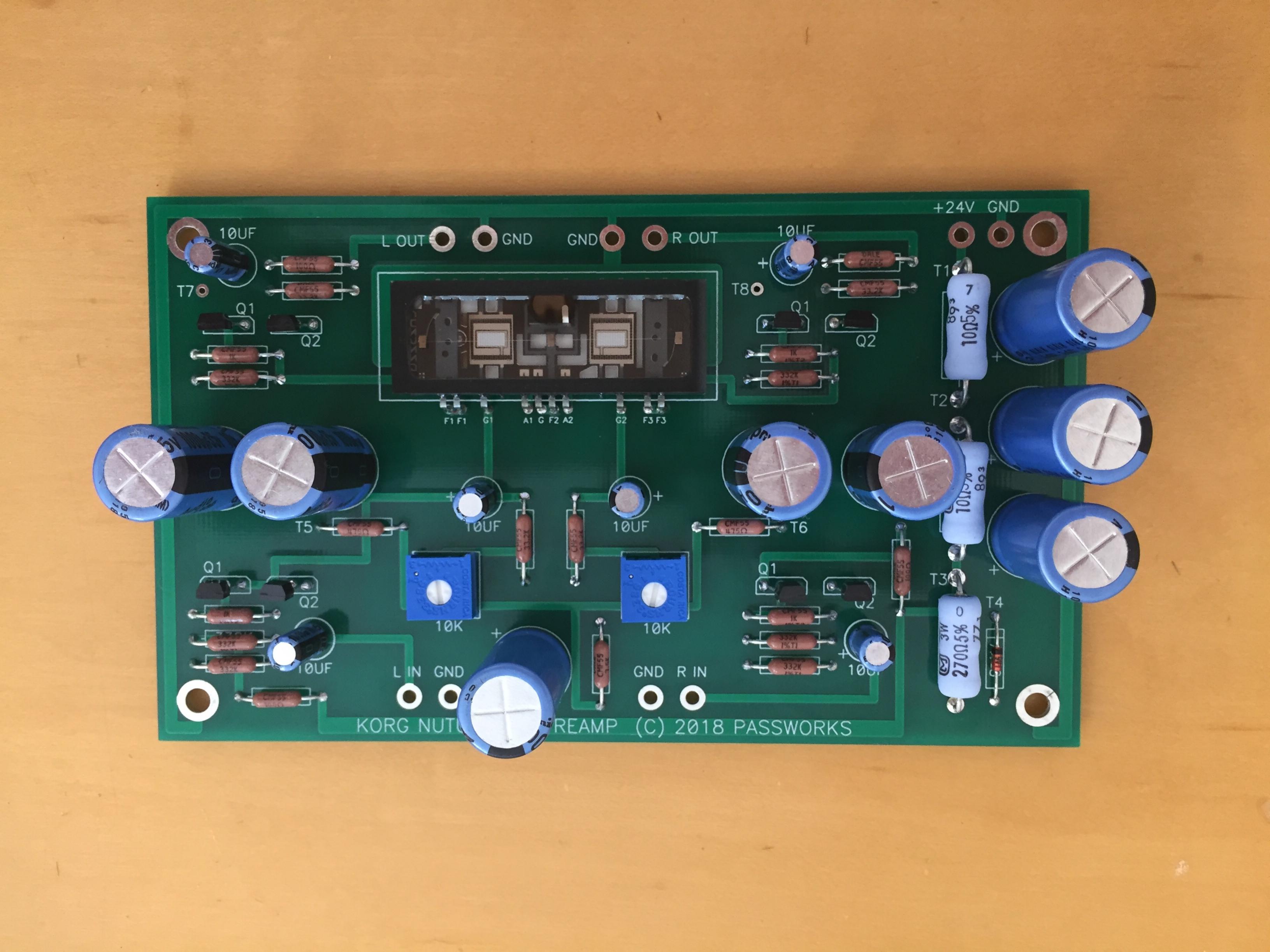

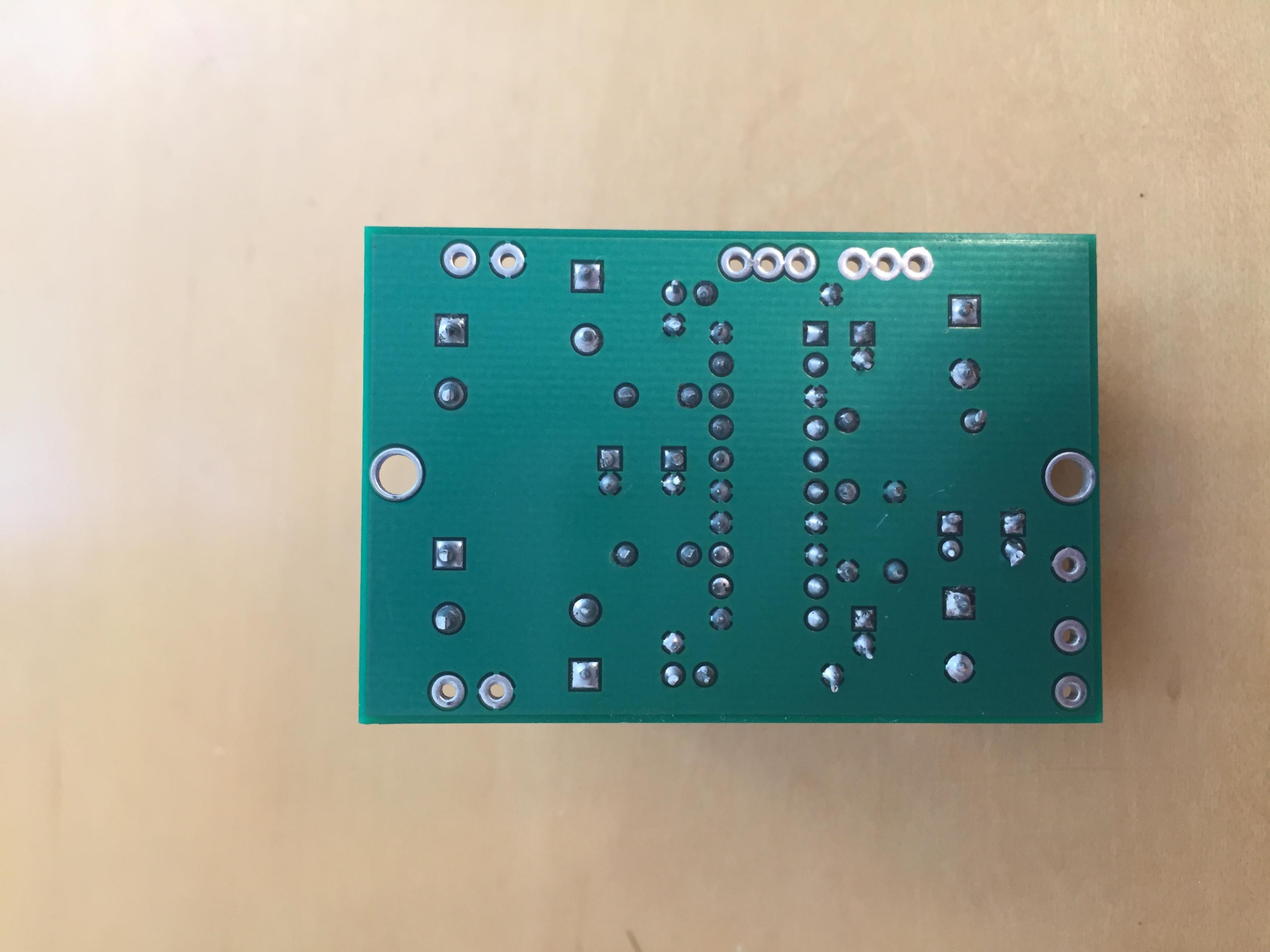

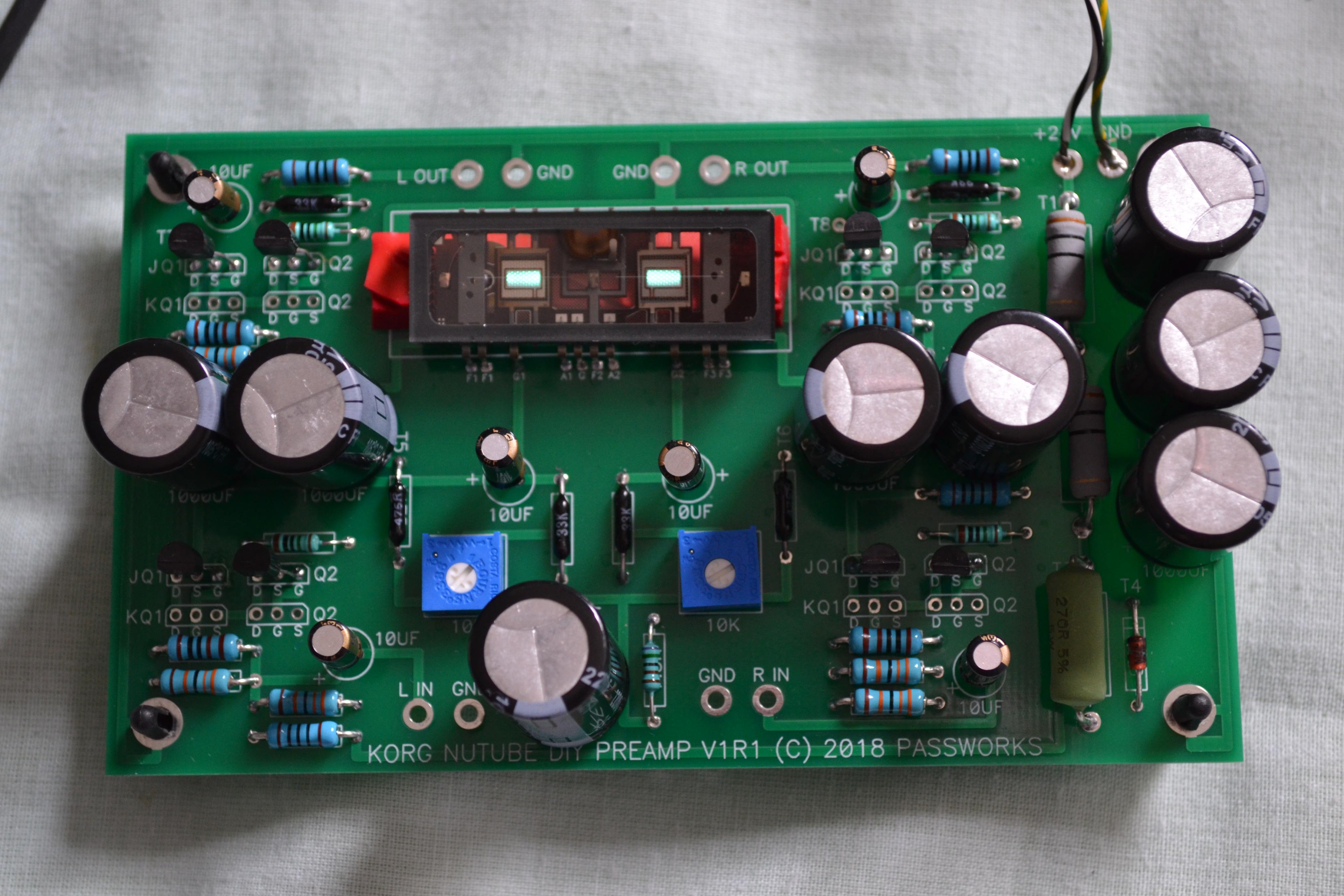

I am finished soldering my boards (mostly). The case is a longer process, so I will complete in the future. The pictures are attached.
Here’s the take away. I previously made attempts at electronic soldering. I failed and gave up multiple times. Though there’s no guarantee I didn’t cook a component this time around. I credit my success to two variables. I was using a generic soldering iron and silver solder in the past. Using the proper tools and supplies is critical for a novice I would say.

Looks good Pat, very neat work.
Stick with it - I fried a couple of components on the way but it worked out in the end. Having a decent, controllable soldering station really helped - a worthwhile investment for me anyway.
Let us know what happens when you power it up.
H

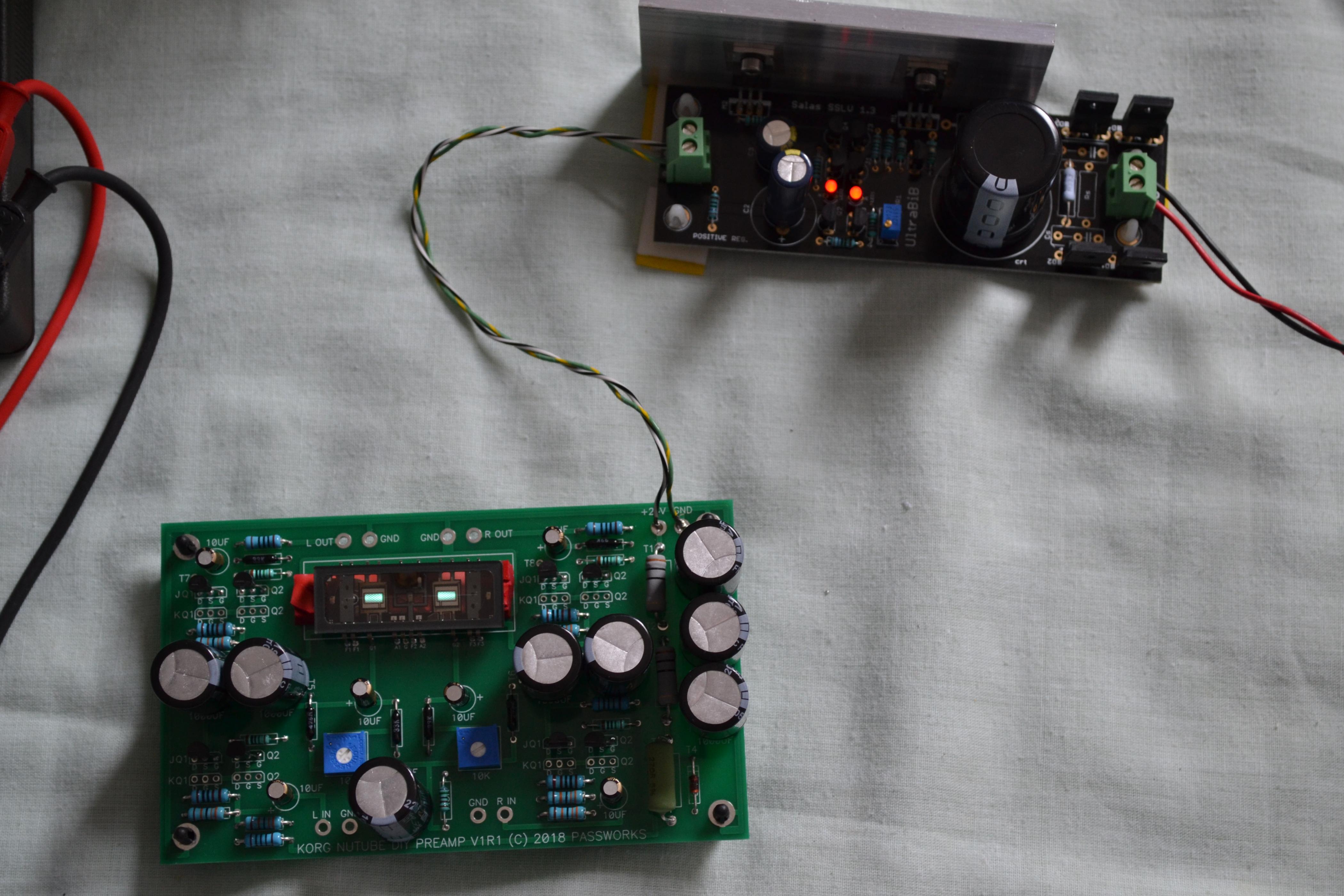

I picked up my board and jfets from my local posy office after paying the requisite fees; soldered all the components to the pcb yesterday and tested this morning. Happy to say that no magic smoke was released and all voltages are within a fraction of those listed. It is powered byDSC_0445.jpg
