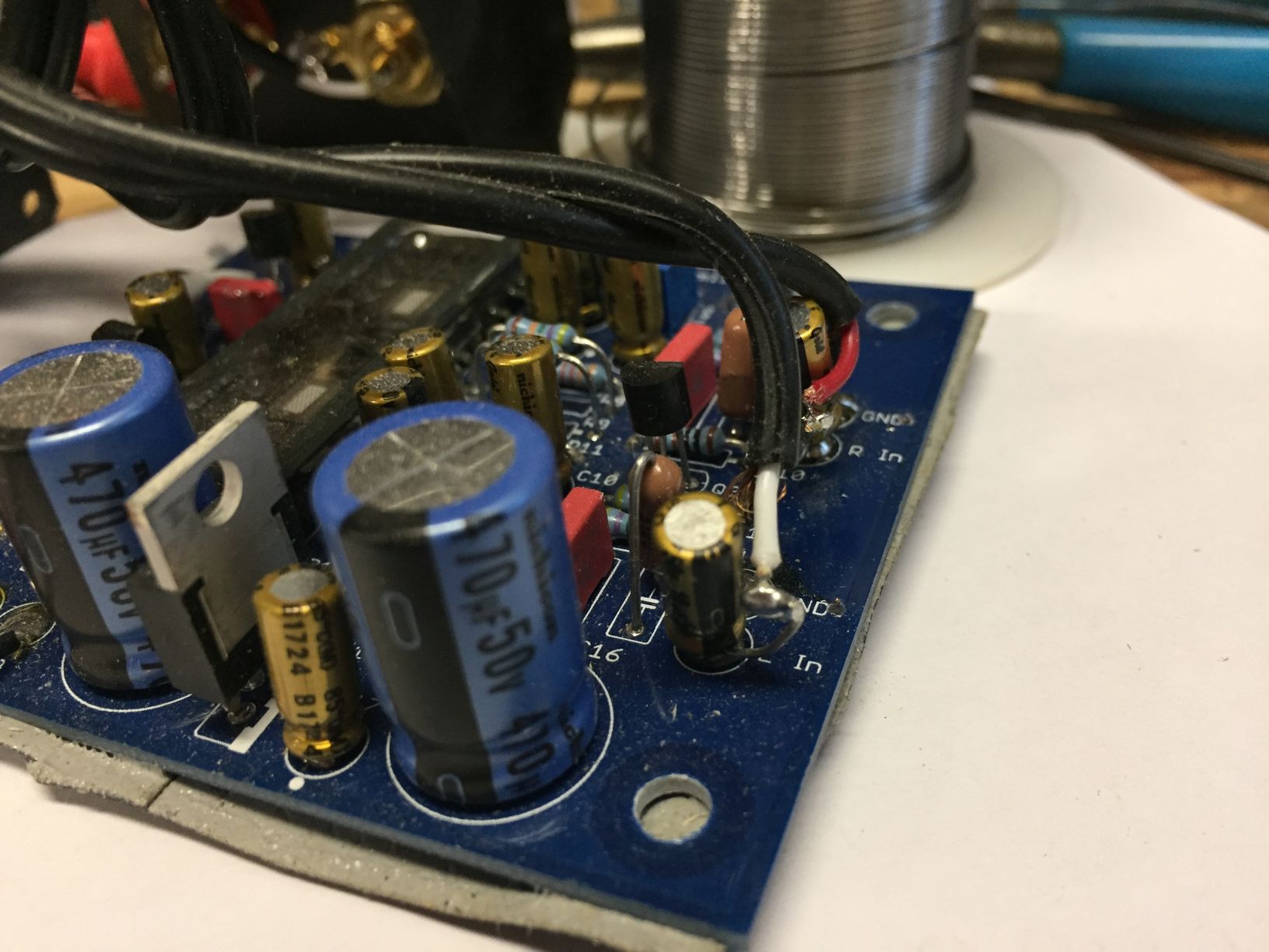

Enochrome:
I have built both the Nutube Buffer and the Nuhybrid headphone amp with the recommended 1K base stopper resistors and have had no problems. Both of mine are using a 24v supply, not 12v.
I've attached a photo of how I stuck one leg of the input cap (changed to a 10 ufd electrolytic) into the + input pad, air wired the input to the free leg and commandeered the input cap pads to insert the 1K resistor mounted vertically.
I also replaced Pete's recommended 475K plate resistors with Papa's recommended 332K resistors and used Papa's recommended 9.5V plate voltage settings. I think that both devices sound much better for the changes. For the headphone amp, I also changed the power supply input buffer voltage divider resistors from Pete's 475K to Papa's B1 Korg circuit values of 332K, although I'm not sure that matters.
In comparing the Nutube Buffer (Mosfet inputs) to the Headphone Amp (Bipolar inputs) to the Korg B1 (Jfet inputs) the Nutube pretty much dominates to the sound. Once everything gets 332K plate resistors and a similar 2nd harmonic level, they all sound pretty close to each other. Papa's B1 Korg does win the shootout for being quieter and smoother sounding while perhaps a bit more open at the same time. Probably a combination of better power supply and the Jfet buffers.
All of these circuits invert the input polarity, which happens at the Nutube. Some listening to the headphone amp with the inputs reversed by some isolation transformers has convinced me that proper phase at the transducers is critical. Easy to do with loudspeakers but the headphones required the transformers due to their common ground connection.
My next step is to A-B the $6 Triad TY-250P input transformer against some $75 Jensen JT-11-P-1 transformers. No doubt the Jensens will win but I am curious to see how close the Triads get.

correction previous post
Enochrome:
I have built both the Nutube Buffer and the Nuhybrid headphone amp with the recommended 1K base stopper resistors ...
Correction:
I only added gate stoppers to the Nutube Buffer since it has Mosfet inputs. My headphone circuit is running the stock bipolars without base stoppers and no oscillation.
The bipolar inputs still have the recommended 100nF Wima film caps. I suppose this value can be so low due to the very high input impedance of the bipolar base.
On the Mosfets, I upped the caps from the 100 nF to 10 ufd electrolytics since that seemed prudent for full frequency response with the newly added 1K gate stoppers.
