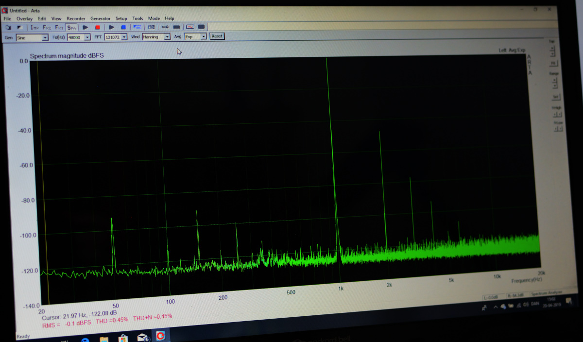

My Korg preamp will pick up noise from my computer monitor. I couldn't figure out why there was so much noise when it was placed on my desk as I was taking some distortion measurements but it was too close to my monitors. When I turned them off the audible noise went away.

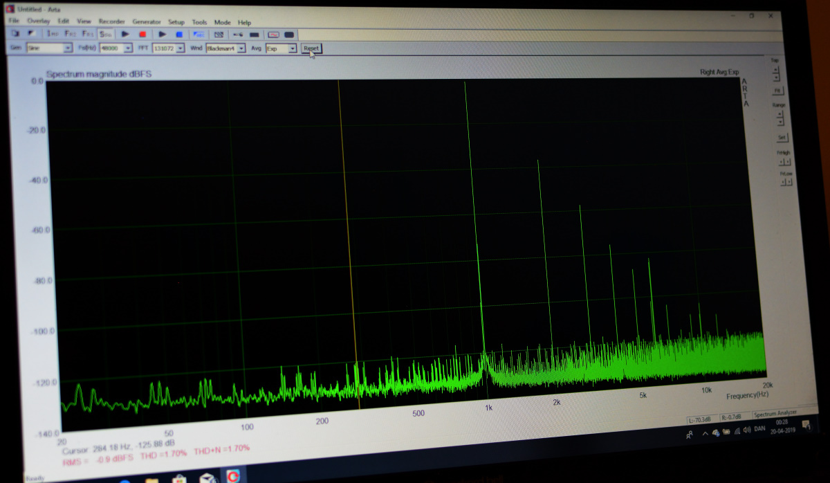

What I tried as the last things last night last night was to try other input in Focusrite but with same result. But if I turned up the volume a bit the 280 Hz spike disappeared as the picture shows. Distortion is higher but noise level still very low. Also listening to the amp is a very good experience. Very silent. It is just academic it could be fun to know how the 280 Hz spike was generated. I have a scope that goes to 0.5 mV/Div but think Focusrite is my best measuring instrument for this kind of "findings". I could try the scope.

I will try later using a lab supply which is an old type linear supply. It did not use screened cables inside the box as I thought that inside was very "clean".....no PSU etc. The Arta + Focusrite is a fine tool. I can measure just the noise at the output with input grounded. The 280 Hz spike is the only one I can't explain so far. It is so low that it is inaudible so only a learning experience to try to find out where it comes from.
Here is the result using a linear lab supply. It has more 50/100/150 etc. noise which was expected. But no 280 Hz so conclusion must be that the 280 Hz noise comes from the Meanwell SMPS. Meanwell is more clean which is good. The only thing I can think of if I should try to dampen the 280 Hz spike is adding E-caps at the PSU input. The relative powerful Meanwell should be able to handle some uF without going into "protection". I can try and see what happens.
I added 2 x 2200 uF at the PSU input where it was most practical to place them. First I added one. The 280 Hz spike was gone but seems to move down a bit in frequency. Then I added one more and the spike moved further down in frequency. But now it is lower about 110 dB down and I think this is sufficient?
My caps etc. seems to interact with a circuit inside the Meanwell PSU. I think it is looking good now. Most be time for some listening…….
