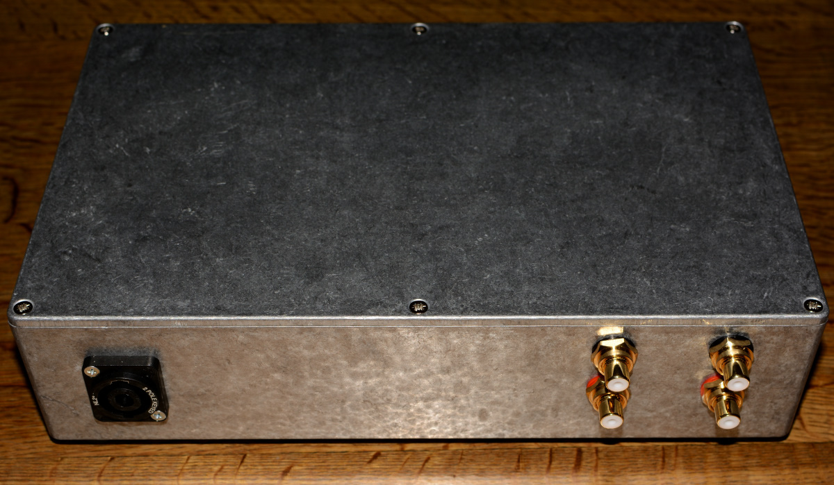

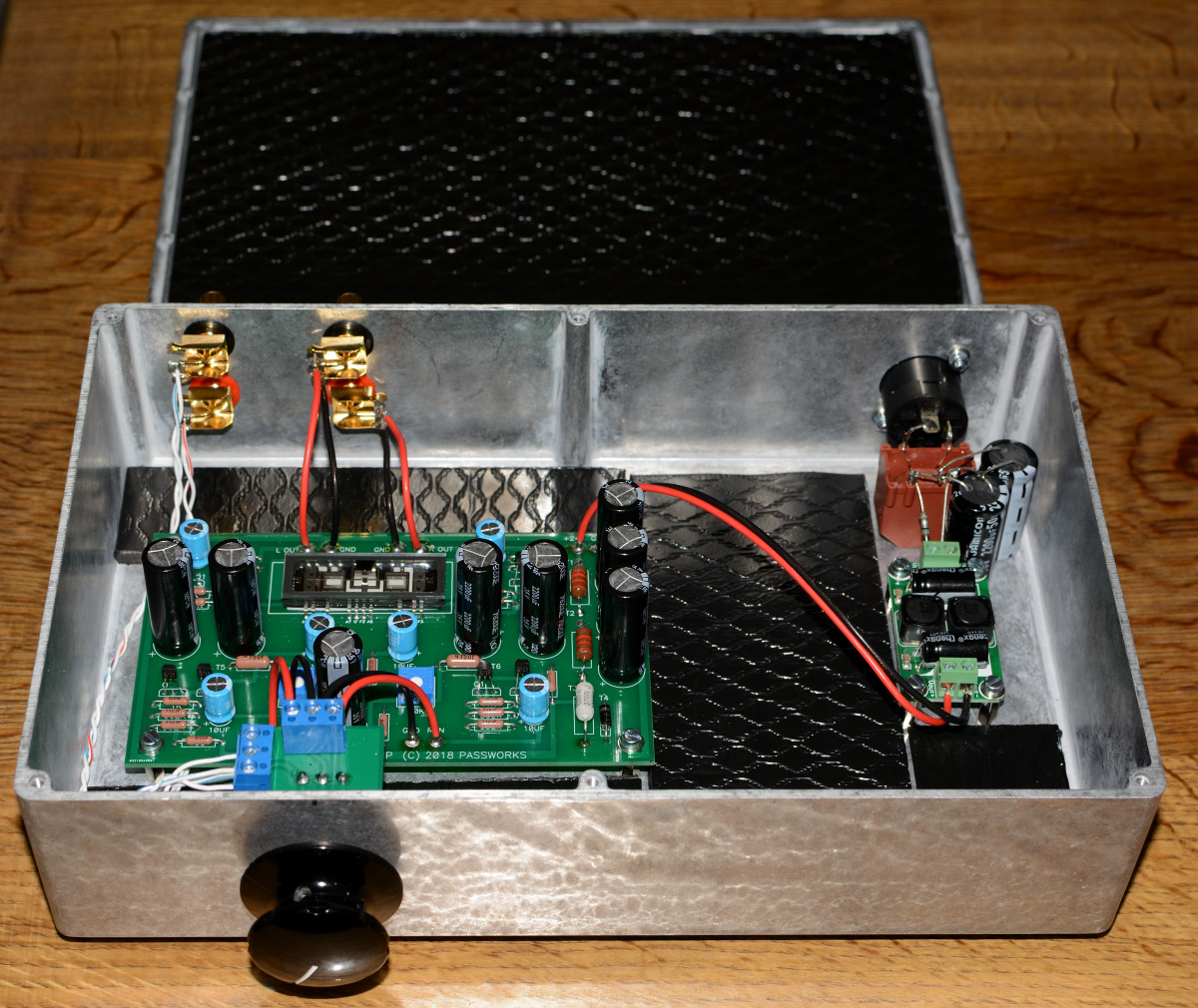

The adjustment pots are connected. I did not use the pots on the pcb. I wired it
to the backplate pots to adjust also if the case is closed. The wires are underside of the pcb.
I used BOURNS 10kohm precision trimpots (10 turns). Makes exact adjustments easy. But I forgot to make a connection from T7/T8 to the outside of the case.
So, to measure I have to open the case again. Or I have to count the amount of
turns (sure not that exact).

I'm building up a store version PCB, here's the part numbers (Mouser) I'm using if anybody is interested -
10ohm 3W 603-FMP300JT-73-10R
221ohm 71-RN55C-F-221/R
270ohm 3W 594-5093NW270R0J
475ohm 71-RN55D4750F/R
1K 71-RN55D-F-1.0K
7.5K 71-RN55C7501F/R
33.2K 71-RN55D-F-33.2K
332K 71-RN55D-F-332K
10K trimmer 652-3386F-1-103LF
10uF 647-UFG1K100MEM
1000uF 647-UKW1E102MPD
9.1v Zener 512-1N4739A
Remember that R1 and the transistors are included with the PCB

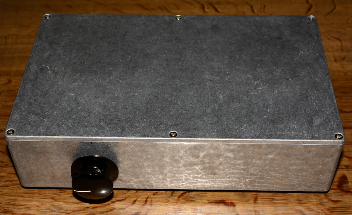

I decided to dampen the chassis a bit using bitumen. There was some mechanical ringing when I knocked on the chassis. Now it is "dead" and I think it is an improvement. I had some spikes around 6 kHz when knocking at the chassis using the Focusrite and Arta software. So now I sleep a bit better. It is also nicer feeling lifting the Korg……..

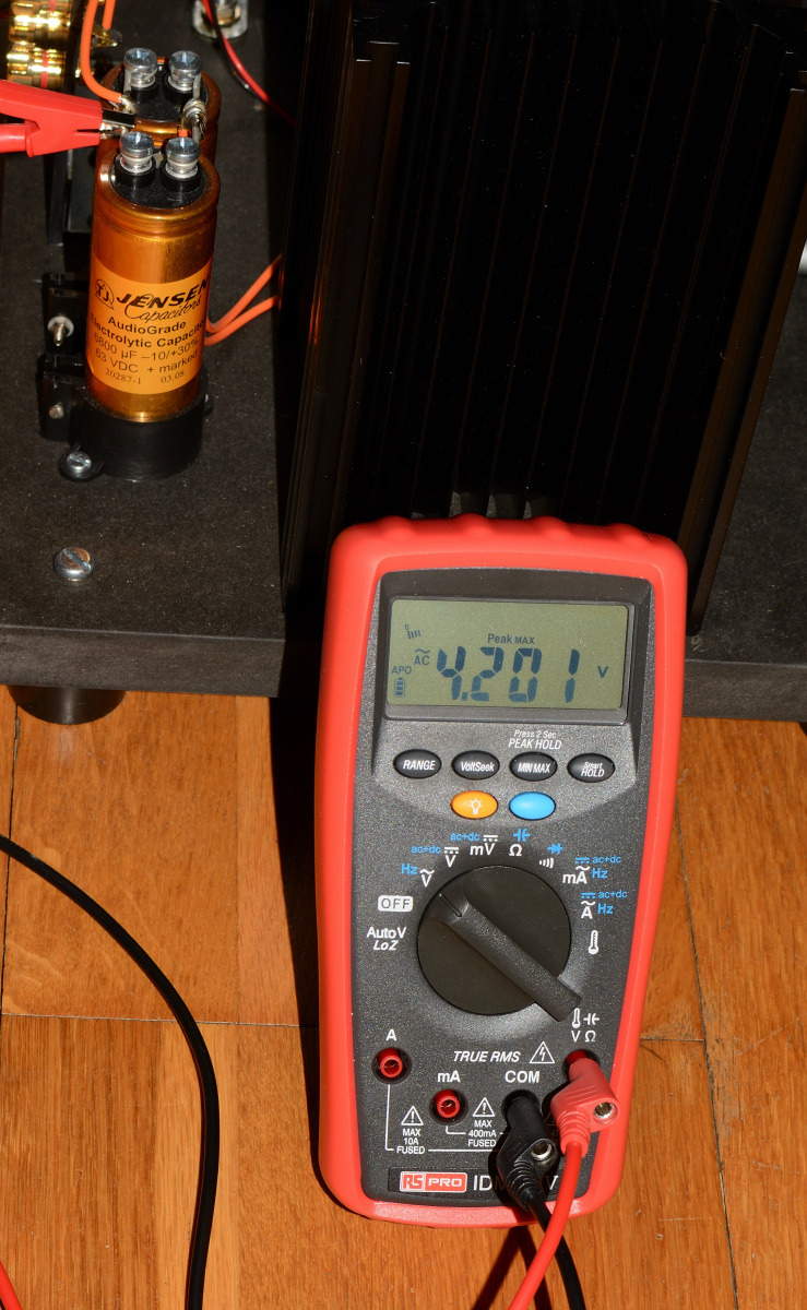

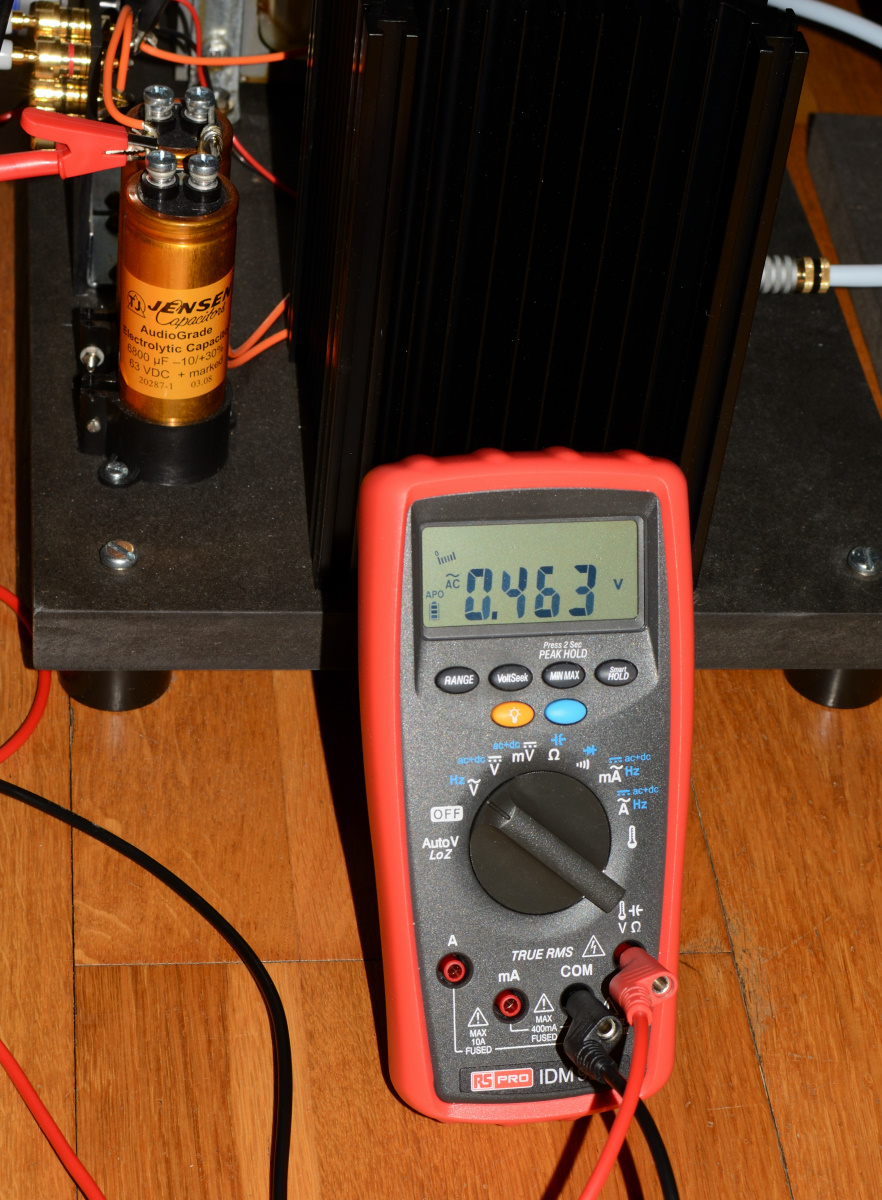

I made the same experiment as Nelson with Korg to check how much output voltage is needed when playing at normal listening level. I would say the listening level was quite loud. I would never play louder. I played classical music. I used Korg with MoFo and I measured output of MoFo which should be identical to Korg output (MoFo has no voltage gain). I used a DMM set to AC to measure average RMS and then set to Peak hold max. to measure peak voltage. As can be seen average RMS is about 0.5 V and peak 4-5 V. I am surprised that average RMS is not more. Speakers are TG OBL-15. They have a sensitivity of about 94 dB. Room is 30 m2 and distance to speakers are about 3m. So Korg works fine with MoFo if speakers are relative sensitive.
10 to 1, or 20 dB is about standard for pk/rms with "good" music,
so there you are.
