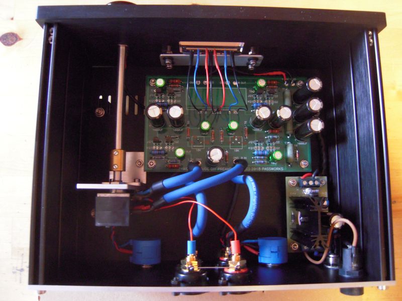

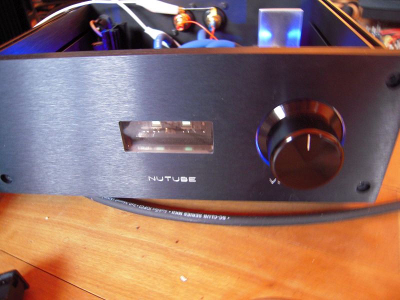

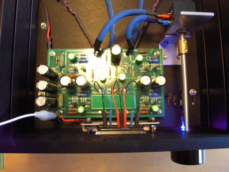

Hello Ed,
sorry for the late response - I had birthday yesterday. Thanks for all your wishes...

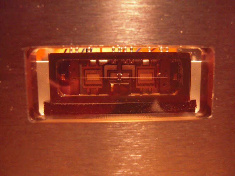

You asked for the cables I used in my B1 NUTUBE Pre to connect the NUTUBE with the pcb (if I understood the question right?).
That is a very thin braided litz wire, pure copper 0,14 mm², silver plated.
I soldered it directly to the pcb and to the NUTUBE. Those contacts at the NUTUBE are easily bended! During soldering a little care has to taken.
Then tubeshrink over the contacts of the NUTUBE.
Used the same cable (braided it myself) from pcb to the 10 kOhm potis.
Shielded NF-cables (blue ones) are from the german company Sommer Cable.
(Pretty low capacitance, OFC-copper, flexible, good price).
If you have further questions... 😕 ask
Greets
Dirk 😀

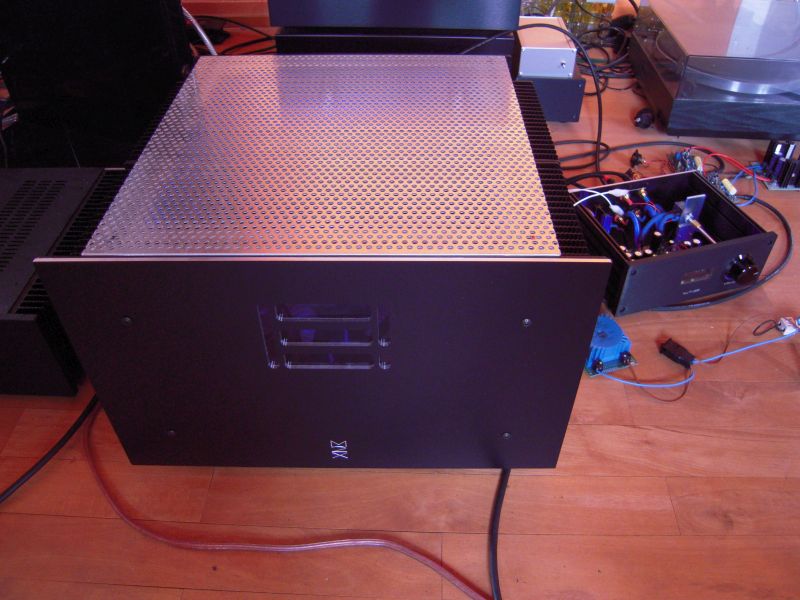

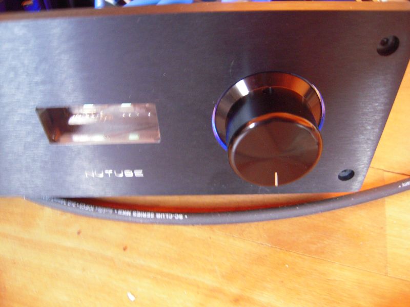

Hello NUTUBE - builders,
many are thinking about the question: Is B1 Nutube PreA + M2X playing
loud enough?
I only can tell you my experiences:
At the moment my B1 NUTUBE and M2X are playing together. Source is my
musicserver playing flacs (with foobar).
My loudspeakers are a selfconstruction. Easy to drive 2-way-speaker:
4 Ohm, 91 dB/W/m.
I am listening to Dave Brubeck at the moment sitting 5 meters away from loudspeakers at the laptop. The room is 10 metres x 4.5 metres.
Volume pot is at 25% and I can listen easily to the music in the hole room at
normal listening level. B1 Nutube at 50% is pretty loud.
Is Dave in the house?
I read in many posts, that many have loudspeakers with efficiencies of more than 95 dB. So I would dare to say that this combo should drive your speakers
easily. But it is a different game if your loudspeakers are 8 Ohm (gives you less drive). Many diyPass-amps half there wattage from 4 Ohm- to 8 Ohm - speakers.
I hope this helps you
Greets
Dirk

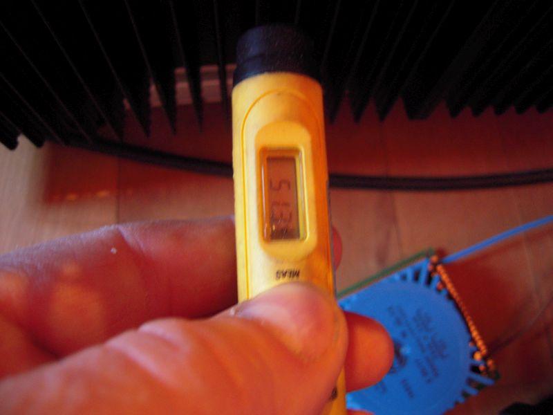

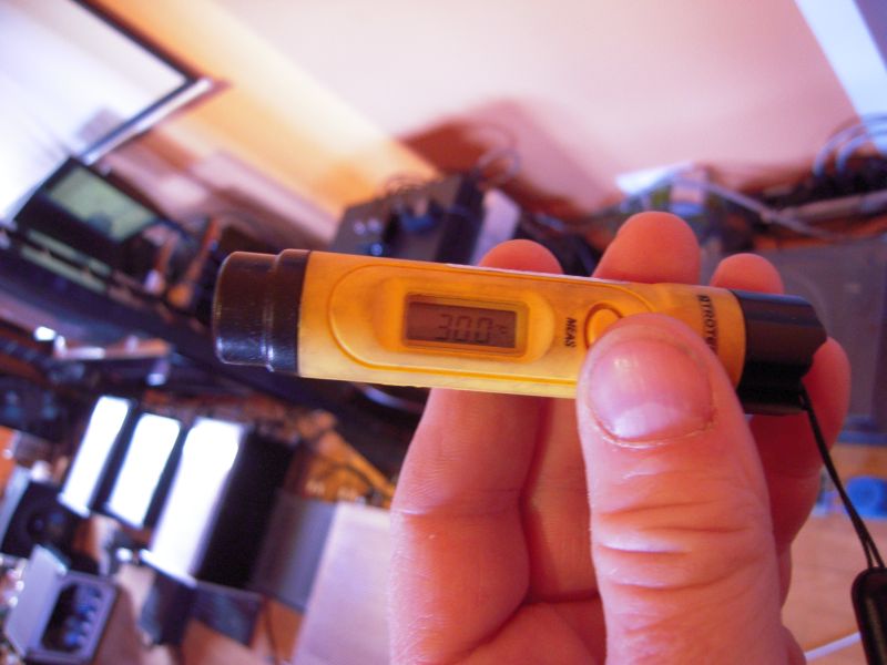

B1 NUTUBE M2X temperatures

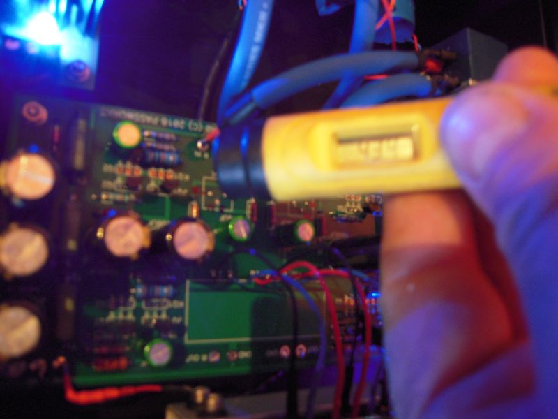

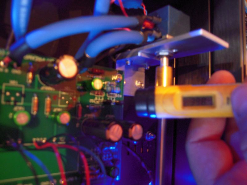

Perhaps also interesting:
Some temperature measurements (those class a- babies heat and sun is shining in-
30 C temperature in my listening room)
B1 NUTUBE: JFets are at around 35 - 42 C (temperature) after 1 hour
M2X: measured at the outside of heatsink / where the Fet sits inside
51 C - not bad for an extra heater
But I can touch the heatsink for 10 seconds - Nelson Pass rule
The room is on 'fire'
Greets
Dirk
