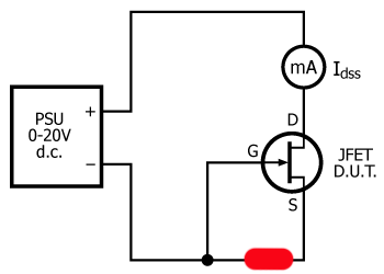

I often see this test rig for measuring Idss where PSU is 9V battery:
JFET Idss Matching – Stompville

I personally ignored choosing the right profession when I was a bit, actually a lot, younger so I still don't understand electronics. Having said that so I have an apology to ask a stupid question: the source resistor is put here?

When establishing a J113 as a constant current source in the 7 to 10 mA range, is there a formula for determining the required source resistor value?
There is, but it's just a lot easier to have a variable resistor on the Source.
I use a dip switch with 8 resistors with 0, 4.75, 10, 22.1, 47.5, 100, 221,
and 475 ohm values and a 12V supply.
Supply is not critical as long as it's consistent -you are only matching.
First I sort by Idss, with R=0, and put them in bins by 1 ma difference.
Alternatively you can do the first sort by Vp, the pinch off voltage with
Source resistance at 1 megohm. Easier with high Idss parts.
Then I sort within bins for the desired Ids value given the resistance,
and that sets me up for current sources good to 1 mA or better.
I don't operate the J113's at Idss, which is too high in current and
dissipation. I keep it down to a reasonable 6 to 12 ma.
