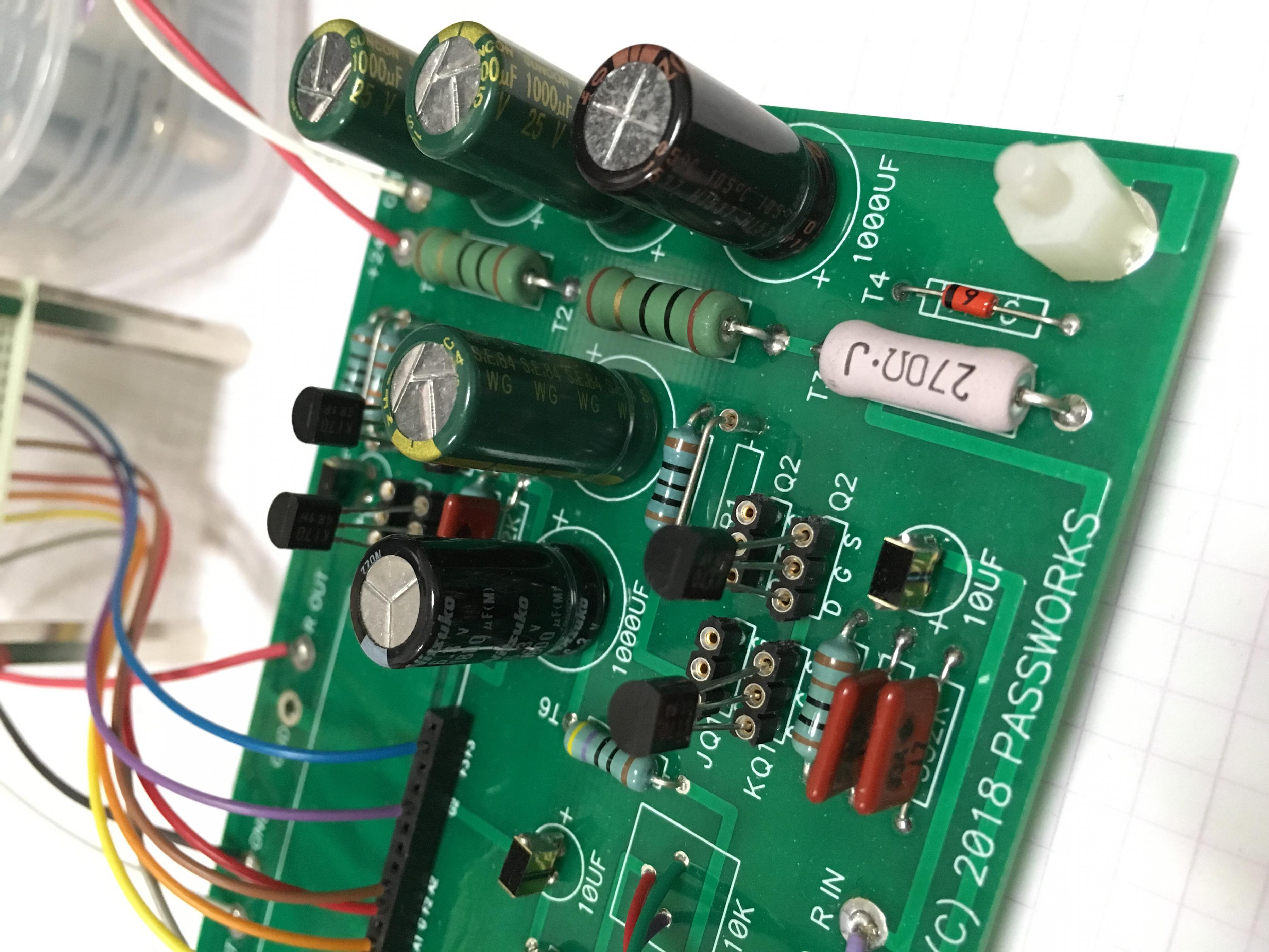

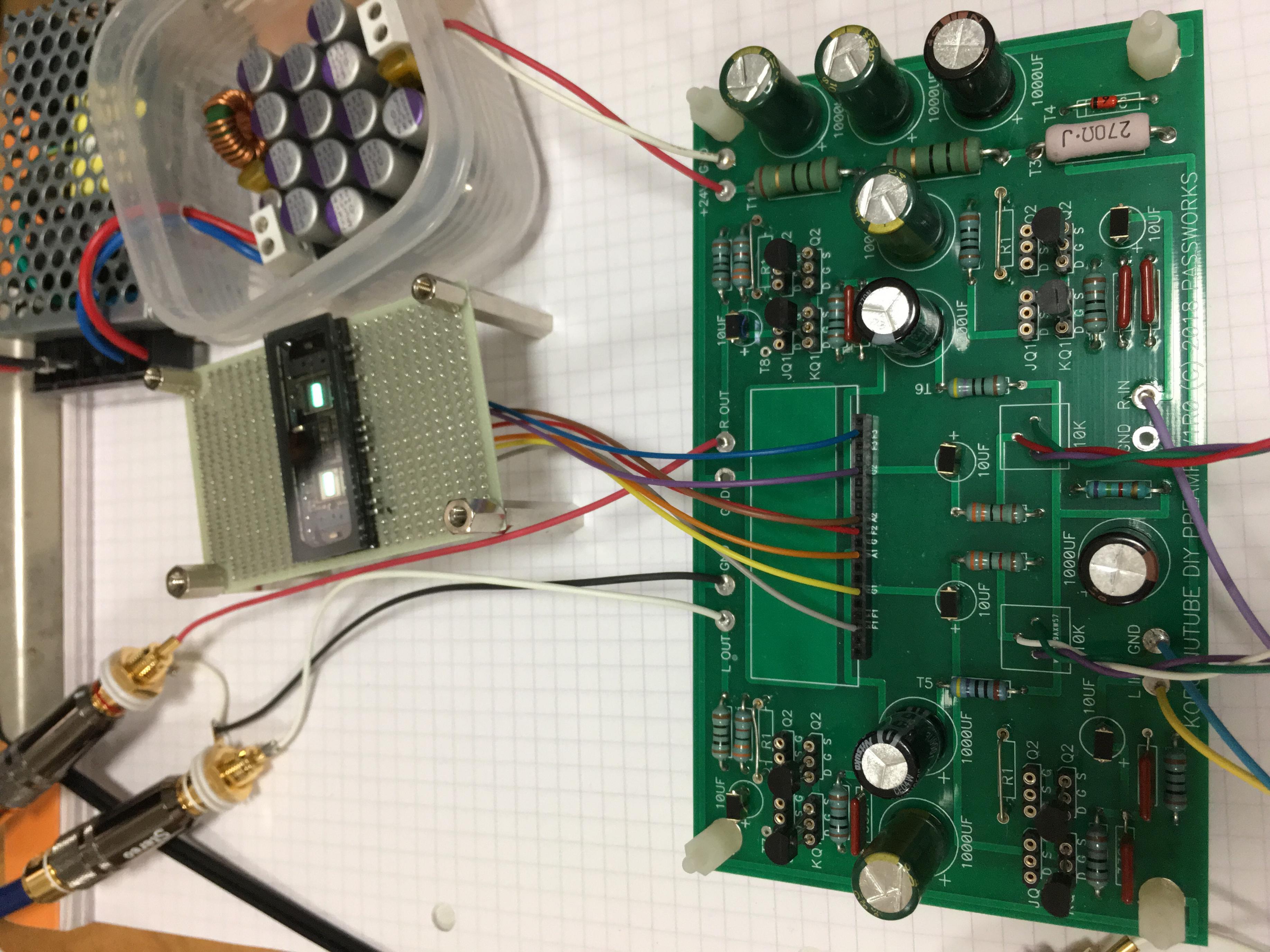

I made a test bench with the PCB from diyaudiostore.
I think the sound is different from the original because I selected parts in Japan,but It's sound is good. Thank you to Nelson and the community.
I did two tests.
Reduce microphonic noise with a magnet.
The result was similar to that of post# 1745.The potential at T7, 8 changes, and the sound changes accordingly.
I do not adopt this method, for fear of the side effects that magnets give to electronic devices.
Fairchild J113 (supplied with pcb) vs Toshiba 2SK170
I placed the socket at the Q1, Q2, R1 position of the PCB and changed the parts.2sk170 are GR grade, matched. The potential of T7, 8 is adjusted each time.
Of course, I know that 2sk170 is more expensive and this is not a strict test.
The result: Both sound good and the differences are quite small.
The 2sk170 may sound slightly solid, but it is probably my assumption.
I choose J113 and keep 2sk170 for the next project.
