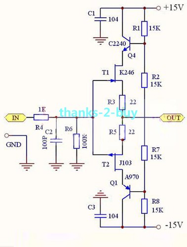

it is a "JFET input Cascoded Buffer Board" for a few $ from ebay.
It should be a piece of cake to use for the b1 rev 2 (with an external supply pcb), but there are a few parts more on this pcb. What do you thing about those?
referring to schm in your post (#146)
you can leave C1 and C3 in , toss C2 out
leave out R1, R2 , R7,R8
leave out Q4 and Q1 , put shorts through C-E holes
and that's it - B1 V2
depending of your JFets Idss , you can put shorts instead of R3 and R5 , or decrease them to 10R ...... or put 20R trimpot between sources , with wiper to out , if you need to trim output offset

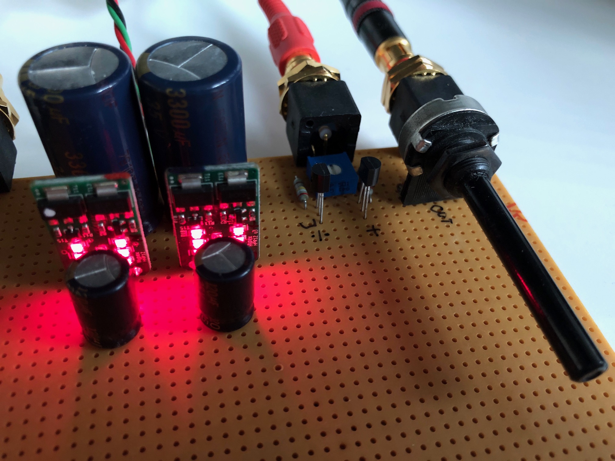

While waiting for the B1 Nutube edition I put the B1 rev 2 together.
I followed Mr. Pass' general rule: 'use what you have'.
I only had 500 Ohm trimmers so each leg is paralleled with a resistor to bring the resistance down.
The PSU is made of one SilentSwitcher (see the store) followed by a pair of Hypex regs to bring the voltages down to +/-12V. The SilentSwitcher is powered by a USB power bank.
I'll be delighted if the B1 Nutube is any better than this one 'cause its damn good as it is. Go Build 1 yourself.
