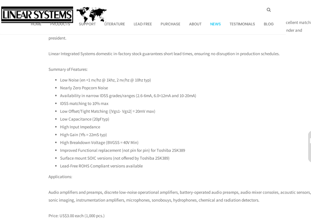

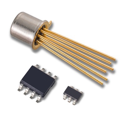

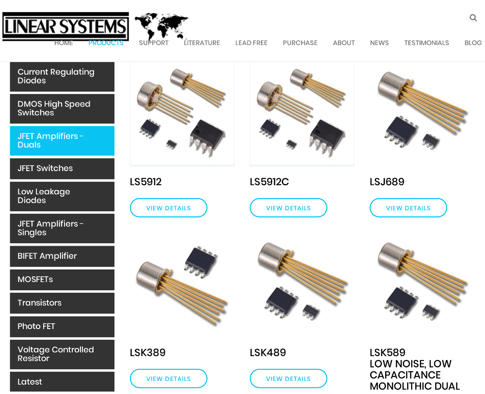

Linear Systems produce dual jfets N and P channel's package.
3 $ one pcs if group buys of 1000 pcs probably metal cans cost +
DMOS Switches, JFET Amplifiers, BIFET Amplifiers, MOSFETS
superb pretenders for buffer B1 V3 if Papa Diy blessing ?
Sorry I did not look on the web, is it a complimentary j/k pair in one case or parallel jj kk pairs?
Parallel in one case 🙂
3 Bucks each?Sounds like a bargain, but I doubt the actual price you will get when quoting them as private customer… Am currently using paralleled BF862 in B1, fortunately they aren't oscillating despite the fact that i forgot to use separate gate stopper.
