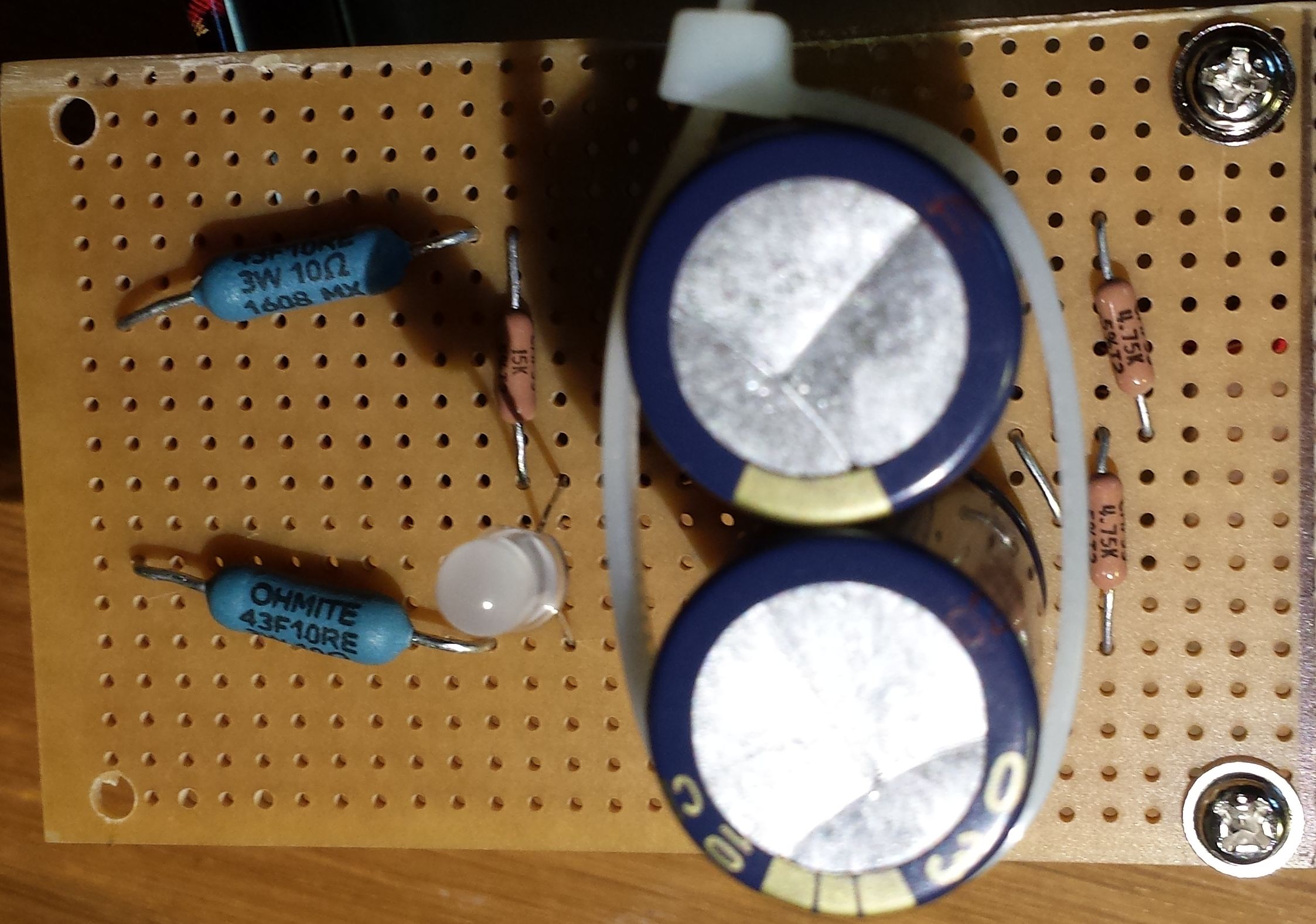

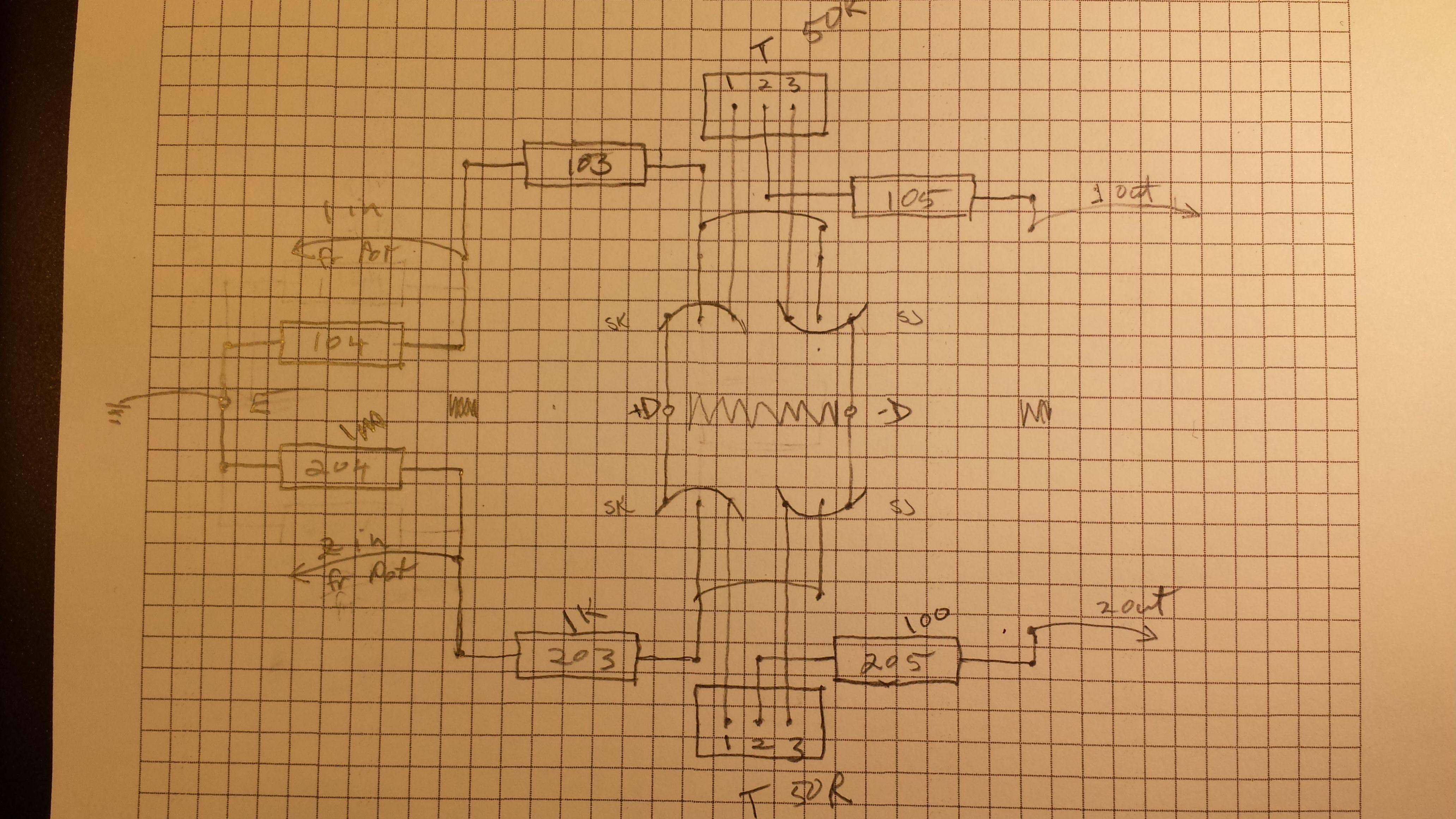

OK, I’ve done a layout and assembled parts, but could use some feedback as it’s my first DIY layout, and also have some specific newbie questions:
Power module:
Preamp circuit:
Any other issues that will help avoid noise here?
Power module:
- 10R at DC entry is wirewound 3W
- Resistors on DC output after cap are metal film ½ watt, as is the resistor on the LED. Because they are 4.75K Ohms it seems 1/2 watts is fine and wirewound not so much an issue here?
- Caps are Panny FC (low ESR), though I have some Nichicon FW available.
- I’m using stripboard, 50mm x 80mm, and nearly all the strips are used, except for edges. I’m hoping the distance between strips is enough that noise will not be an issue? Technically, no spots needed to be cut in the strips.
- Because stripboard holes are 1mm, the input and output from the board are 22AWG solid core pairs, as nothing larger than 20 would fit anway. I’m hoping that is robust enough for optimal power delivery? I suppose I could solder an 18AWG between the 1A DC power supply directly to the 10R resistor leads. The current reqs are meant to be pretty low.
- The power termination blocks available all seem to require 1.3mm holes, so it seems would not be fit for purpose.
- Jumpers (2x) on right serve to common the cap centre leads, which goes to circuit Common. The zip tie (temporary) mostly hides one of them.
Preamp circuit:
- I put Right & Left as facing mirrors of each other, and the power in is a solder point in the centre, between the JFETs same wire as above, twisted pair.
- Again stripboard was used 50mm x 80mm. Spots are cut in the strips at relevant places across the centre between channels.
- On attached, vertical lines connections supplied by strips, horizontal lines are supplied by leads, and curved lines are supplied by jumper wires.
- Since I'm starting with only one output and won't have a switch, I assume the 1M resistors on the input & output positives are not needed?
- I would expect to connect preamp Common directly to power module Common, along with Potentiometer and RCA Earths.
0.5mm diameter copper has a current rating of >600mA and for transient duty could probably cope with 2 to 3Apk.
You don't need 18awg (swg) cabling.
0.6mm diameter hook up wire in low temperature PVC insulation can take about 1A continuous and never get warm enough to soften the PVC.
I don't follow your layout drawing.
The input for one channel is a TWO WIRE connection. I can't see any two wire input.
The output for one channel is a TWO WIRE connection.
Same for the other channel.
You should have four two wire connections going In/Out of this board.
Yes sorry, I did not show the wiring of the input & output RCA’s or the volume pot, just showed the layout of the boards. I was presuming that the preamp board would handle the Signal-wire side of things, and the Signal Earth In/Out would not need to have any connections on the actual board. It would go from RCA In > Vol Pot > RCA Out and merely be twisted with the Signal wire, without an actually connection to the board. Is there a reason it should? I suppose that could complicate the wire pair twists…
Or am I missing something more basic?
