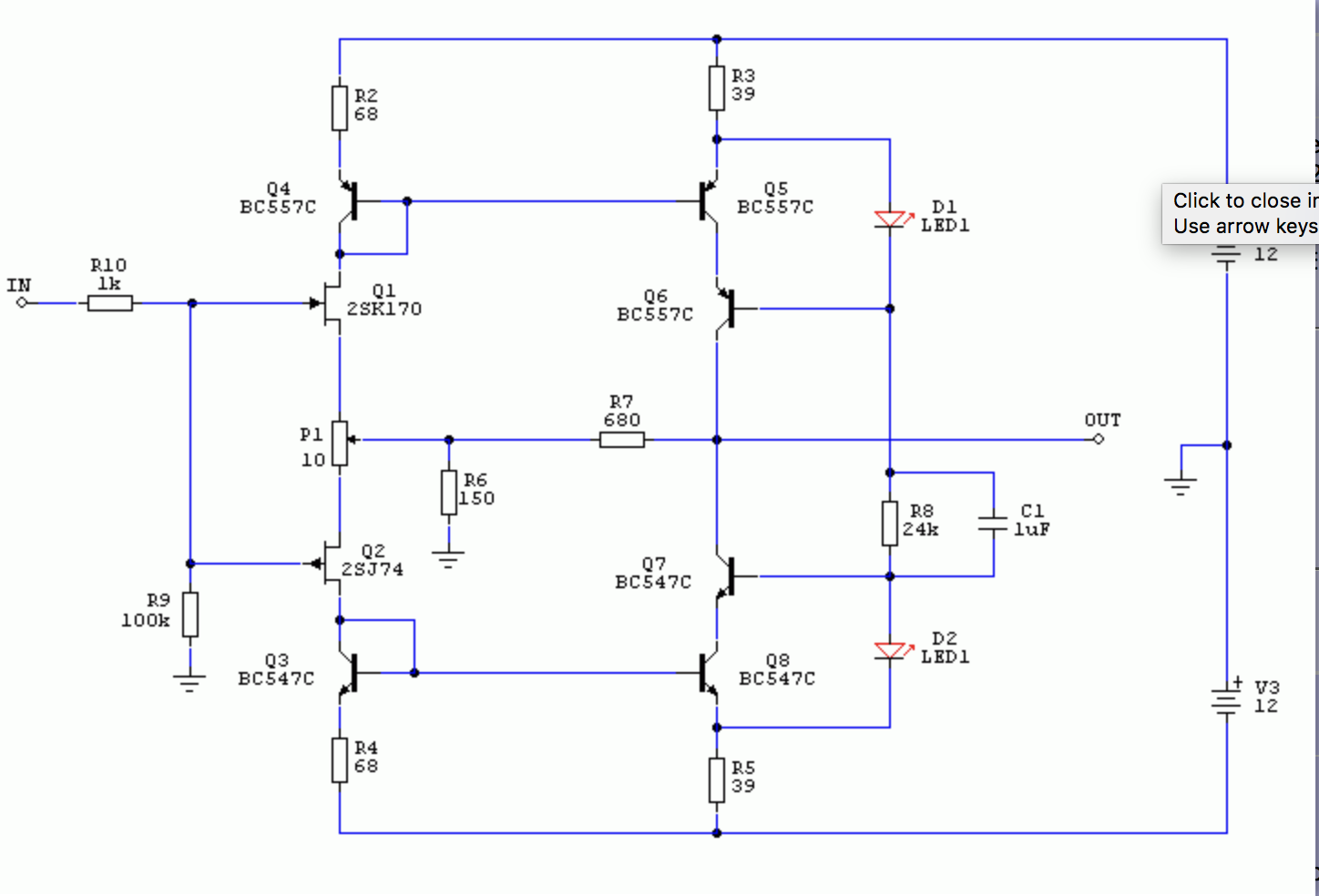

If I set it to negative dc offset of a couple of mV and use it with a capacitor do I get some of that negative phase second?
I would argue yes you can. Dc offset in the b1 rev 2 is nulled by adjusting the jfet source resistor values, same as the p3 trick in the f5. You can adjust the pot in b1 rev2 to achieve increased 2nd harmonic and then null the dc with cap on output.
Well, I tried this... without measurable H2. Even using parts with an offset up to almost 4mA Idds (k170 at 8mA and J74 at almost 11mA). Don't know if I did something wrong... my source resistors were each adjustable from 0 to 10Ohm. Did you try in real?
I have not tried this. I do feel that my B1 rev2 sounds 3rd harmonic dominant although I haven't measured it or attempted to adjust it. It does sound "too clean" to me. Perhaps B1 rev2 does not have enough distortion to make a difference.
I have, however, done the same thing with the attached circuit (Juma's current mirror LSK preamp variation). Definitely had an effect.
