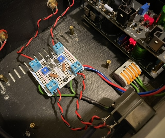

I made this little guy on perfboard last week. Amazing the kind of clarity and quiet you can get with a couple of resistors and a little Toshiba magic. Using with an Ultrabib, which makes for a nice combo.
My favorite way to control volume in my setup.
