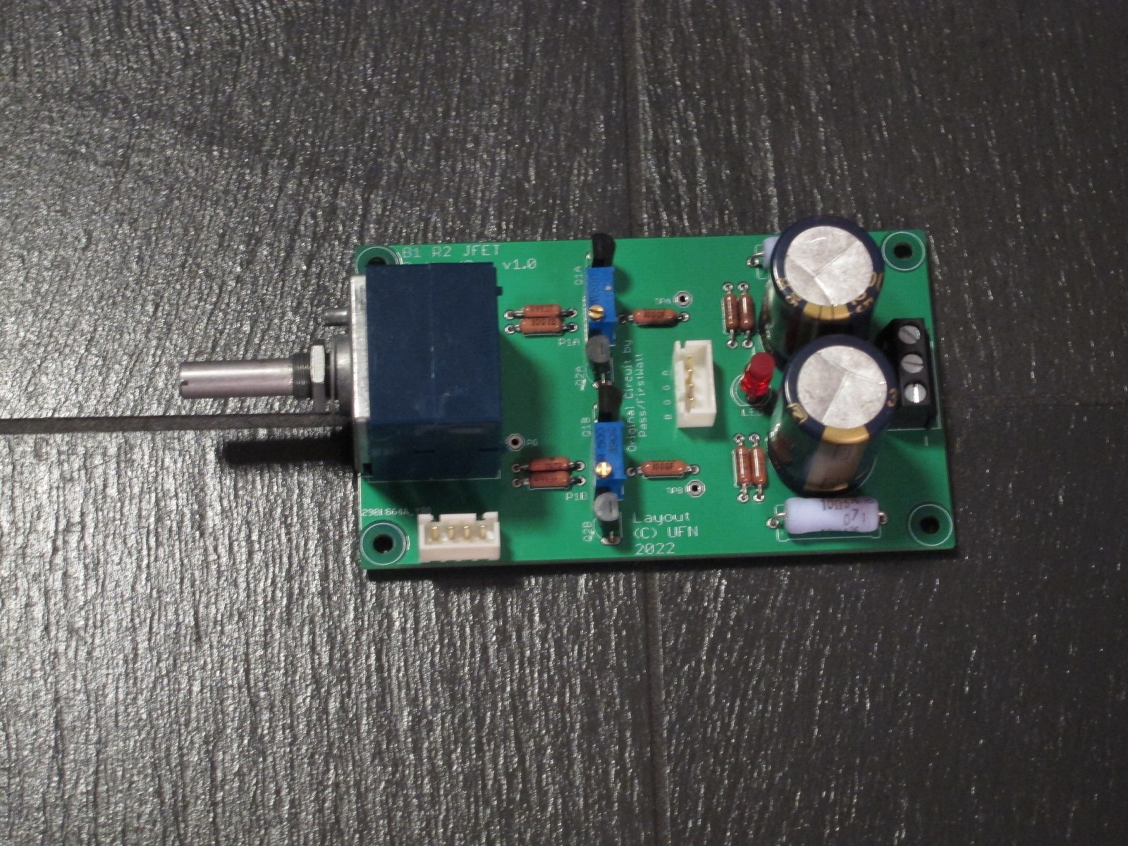

Hello, I’ve let design some pcb for the B1 rev 2 and I have some pcb spare. If someone is intersted, please pm me.
Nice Boards!

I just made my version, copy of Pico’s protoboard basically. Intend to replace my WLS, and improve my gain structure with minus 12-ish db.No idea yet, but I'm sure I'll think of something 🙂
Just succeeded in zeroing offset on one chan, very stable. Maybe solder something together during christmas 🙂
I will update along the way, and if it all works from the get go I’ll post something during Christmas. I’ll be powering it from Gaz’s regulated bipolar PSU, much alike the Whammy PSU. I don’t have the neg Salas board yet, but I think I will get a good impression of the circuits potential 🙂Interesting. It would be interesting to hear your listening impressions between WLS and the B1.
Toshibas are 10mA IDSS. So they’ll dissipate approx 120mW @ 12 volts. But I might not want to lower the PSU as far as 12 volts, it reaches 21 max. Maybe I’ll settle for 150mW, and perhaps sink the JFETs if they run hot. I have TO-92 sinks.
Edited to add: I really love the WLS. Fantastically clear and liquid. But it is way to gainy for my F2J, like mentioned before. So wanna try a buffer, capless this time. Dreaming of the IP, but this is less expensive. Had all parts except for an Adafruit @ 5 bucks.

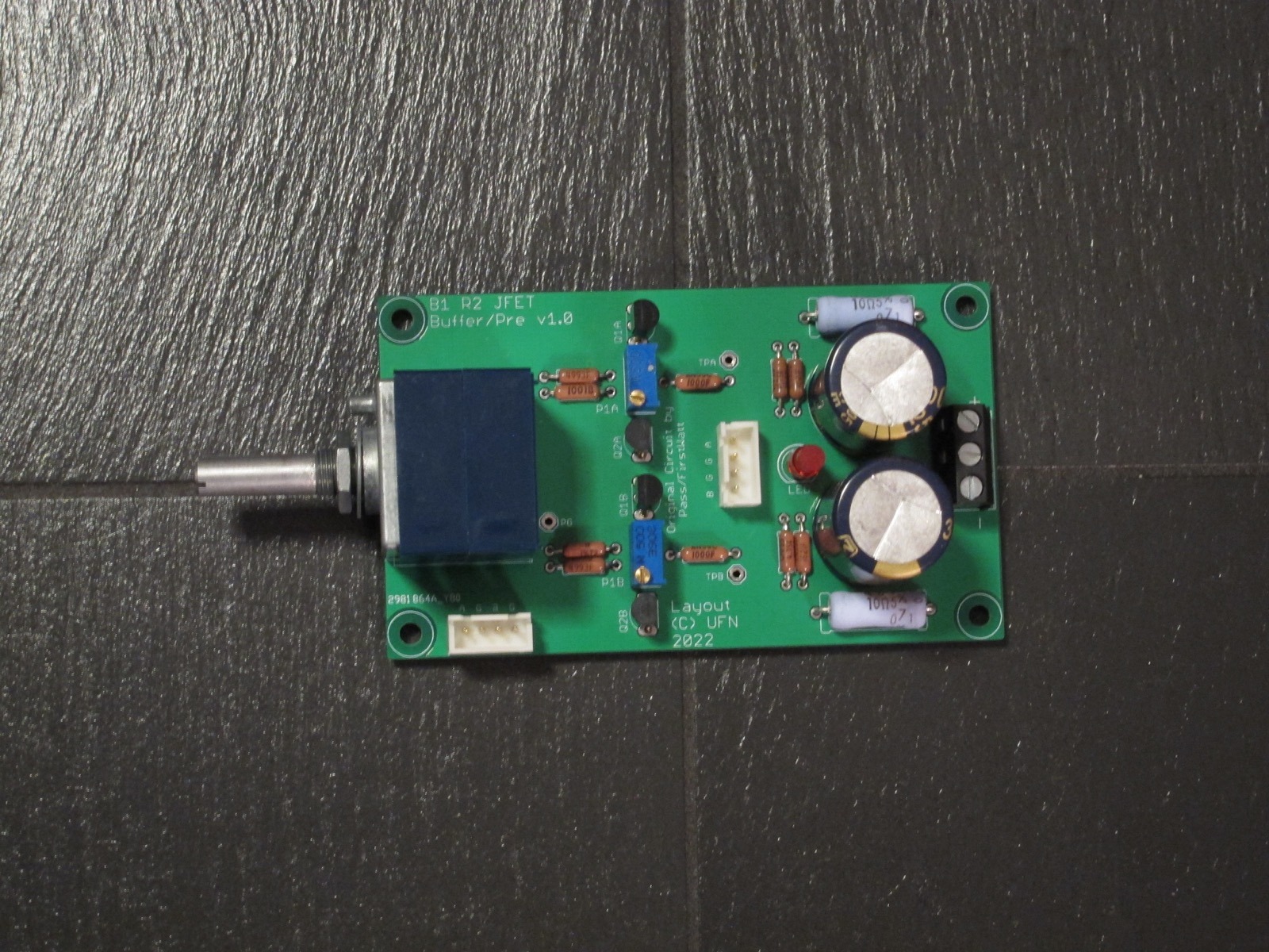

My B1 R2 is up. Ready for listening now 🙂
Immediate impressions, after just a few songs, apart from very improved gainstructure, is:Interesting. It would be interesting to hear your listening impressions between WLS and the B1.
1: Even more relaxed and smooth midrange. Especially noticeable on female voices, for example Eva Cassidy. This means it is possible to play even louder without it ever getting harsh or making my ears oscillate
2: Very good bass, it is just as good as the WLS, perhaps even more natural? Hmmm
3: Highs are very relaxed, but also extended. The WLS still has the upper hand on overtones, but it is too early to tell since I only use pin sockets for JFETs and pots, whose wipers conduct the output signal. Also, the WLS does have better cabling drive capability (large output devices), so shortening them through a change in chassis layout might inprove things even further.
4: A tad more natural and relaxed. This might be due to a bunch of factors, including things I did or did not do with my WLS (matching, etc). But, given no feedback and extremeley low number of parts, there are several reasonable explanations.
Both are winners, but in my system I think a buffer is the way to go 🙂
