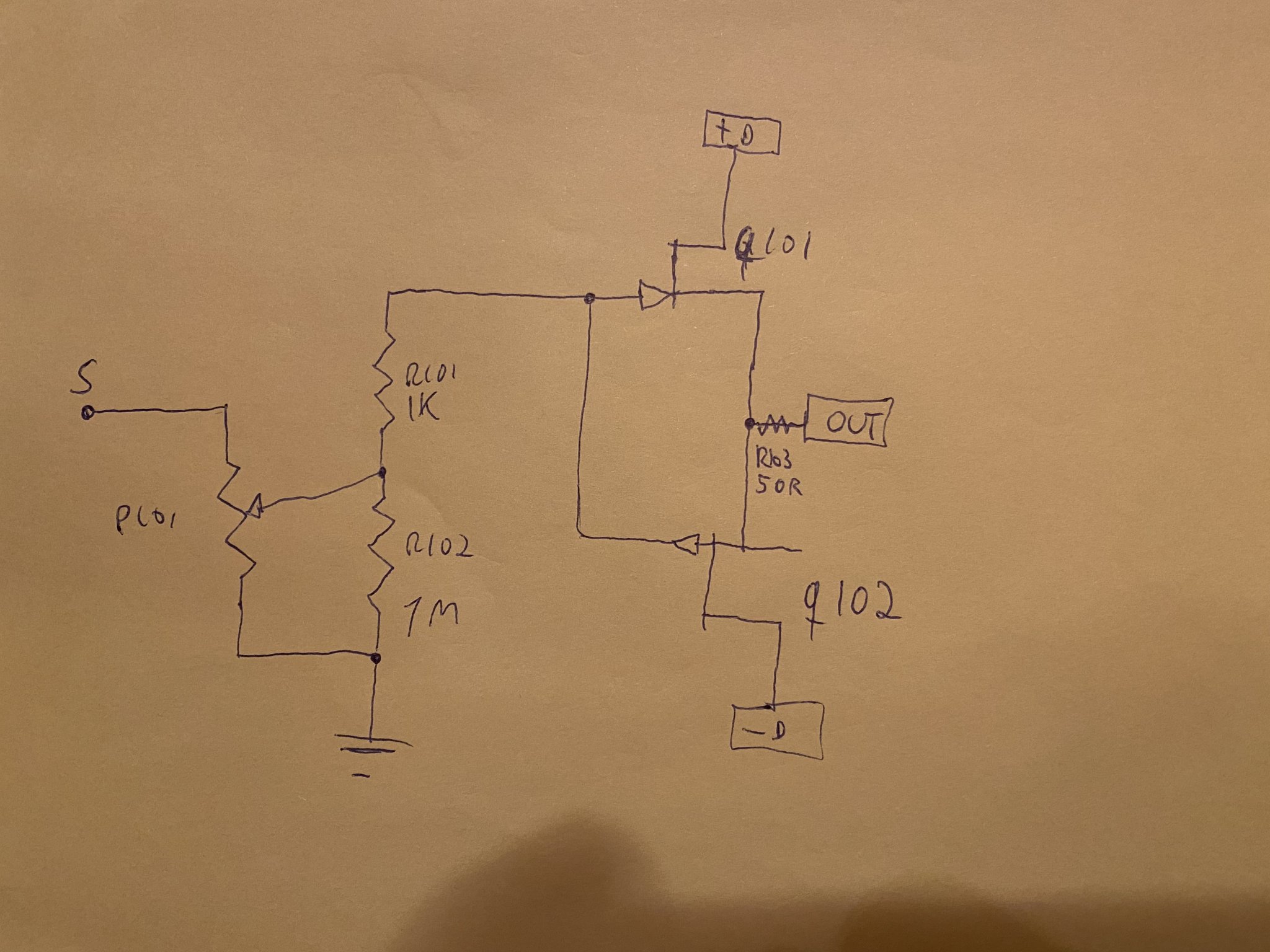

1 + 2)Use batteries instead of a switch mode power supply. Everything else will be virtually the same. You could definitely use a switch mode power supply (also simple to add) but batteries are technically better while also being simpler. I can draw it later if necessary.

1) how much power does this B1R2 typically require under load?
I'm okay with doing a good job on this if it helps me get a great sounding buffer. I'm okay with it taking a bit longer if I have something that will be less hassle long term-- in other words... i'm not into super complexity but it doesn't have to be super super simple.
Thanks again.
It only requires a supply capable of 200mA, less actually, (the circuit will draw a fraction of that) but having more output capability will mean you can use it for more projects into the future.
It's class A, you would have to be driving something pretty demanding to get it into push pull territory. The circuit will draw not more than 40mA.
I would aim for at least 1A capability.
I think I have covered it all very briefly. If you need further explanation on anything, just ask.
Less questions will probably get longer answers.

A few more build questions--volume and trim:
-- any suggestions for very good volume control 25K on the B1R2 (2019version)? (I would like it to be quality sounding... I'm not after spending hundreds on some fancy one but if there are really good ones for under maybe 30 dollars or so? (Not sure what's reasonable). It seems like an important part that is in the signal path.
-- trimpots? the schematic shows a 50 ohm trimmer resistor (or whatever you call it). Parts manufacturers often carry Bourne.. but any suggestions since this is directly in the signal path? What are some really good ones? (I might reduce the 50ohm to much smaller if I can get the Idss to balance as well as reduce the 100 ohm output resistor-- suggestions Zen Mod has made earlier).

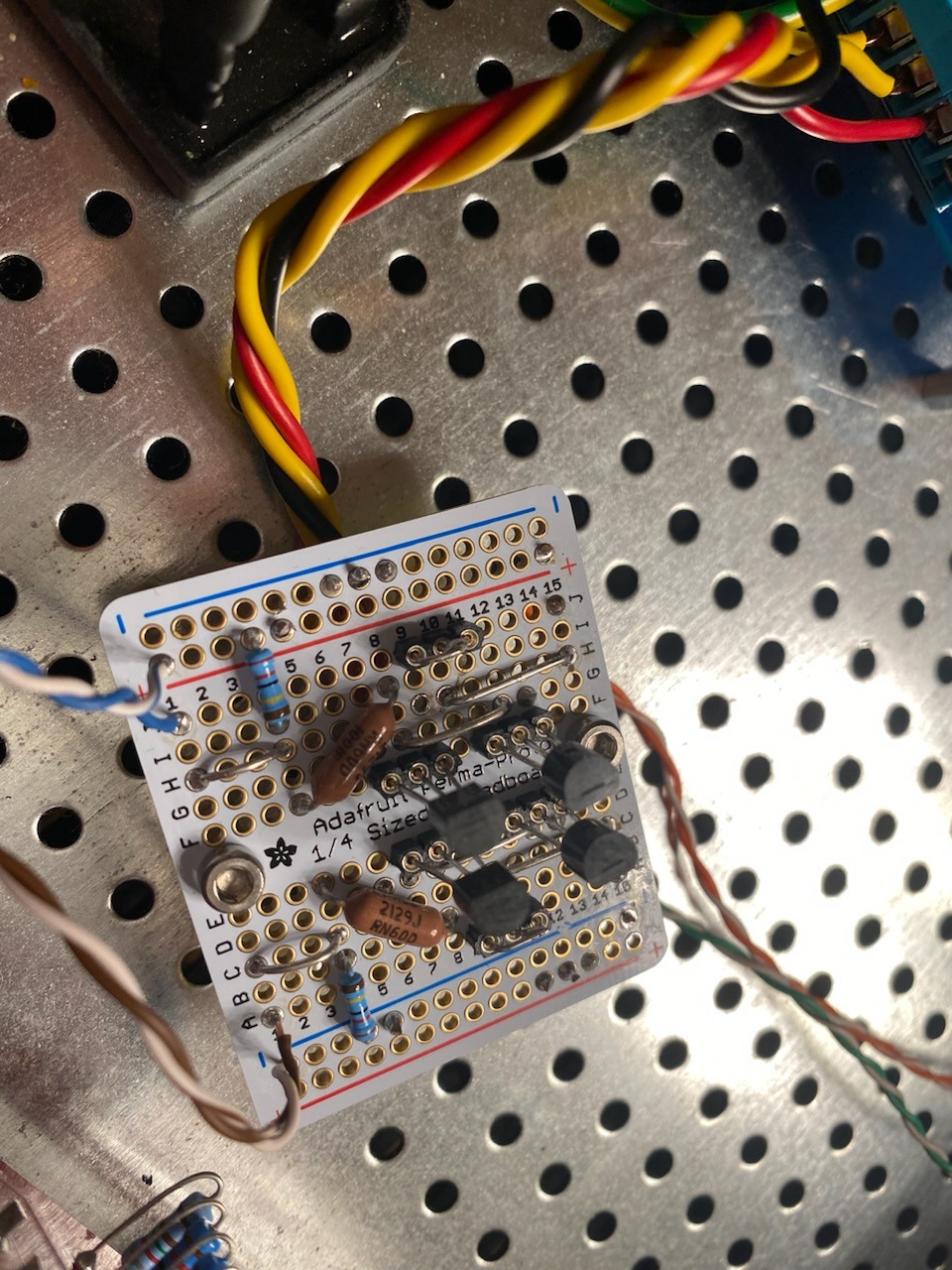

B1 R2 beast builders R1
Three parts per channel.

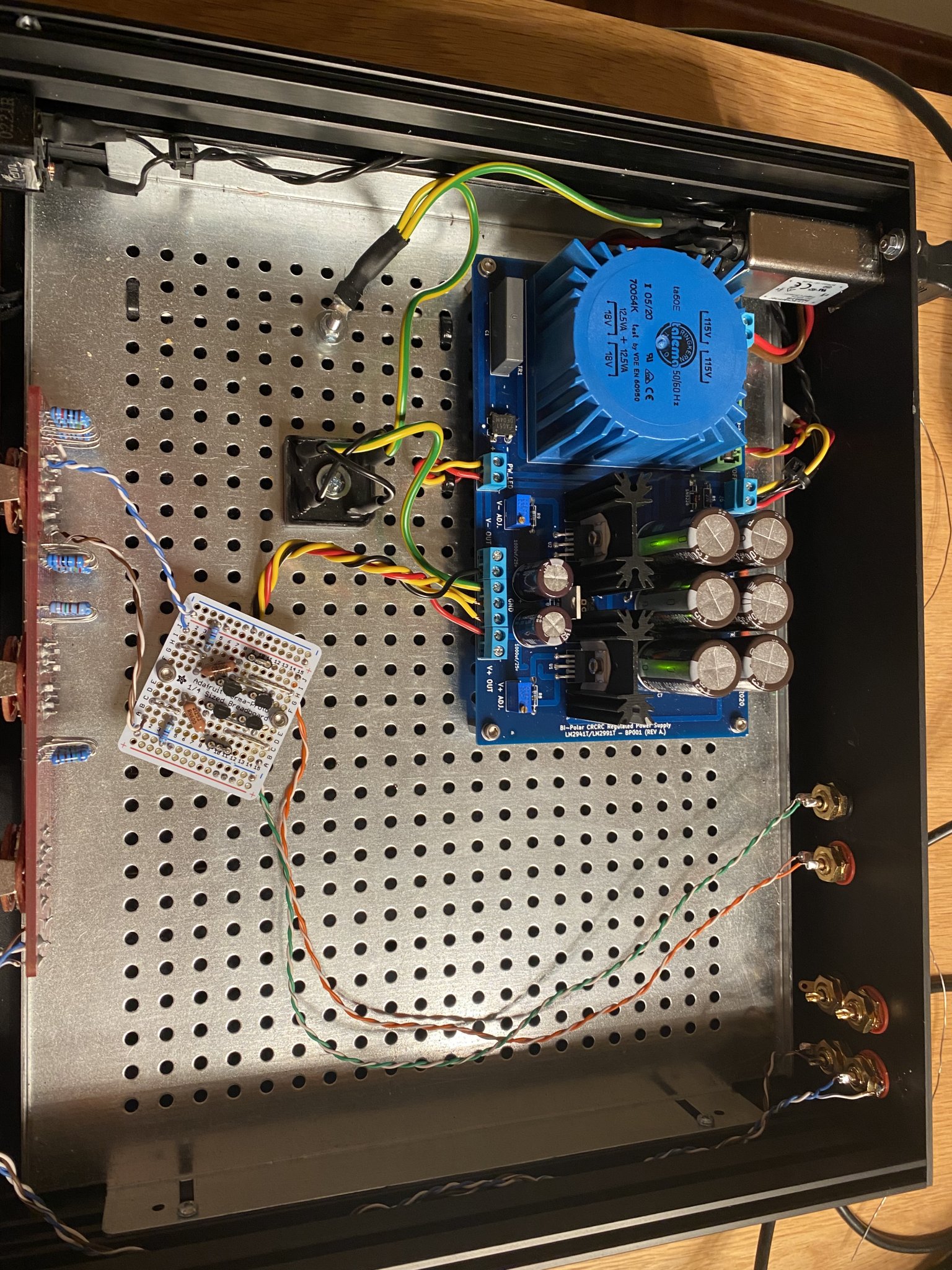

DC offset: 1,3mV and 2mV, JFETs matched within 0,01mA
Now for connection to F2J. Imminent explosion will be reported.
Zero degen, no pots, no series output resistor.
For the record: this was a mod extremely well worth the effort! Increased liquidity and dynamics, just as Pico promised.
My WLS is up for sale, that’s how good it is!!
Will post revised circuit tomorrow. Thanks to Pico and MZM, and Papa of course!
Board isn’t even cleaned, JFETs arent even soldered. Still insane.
Lot’s of potential for chassis layout improvements, and probably also for the B1 board itself. But for now, I’ll just enjoy it like this for a while 🙂
