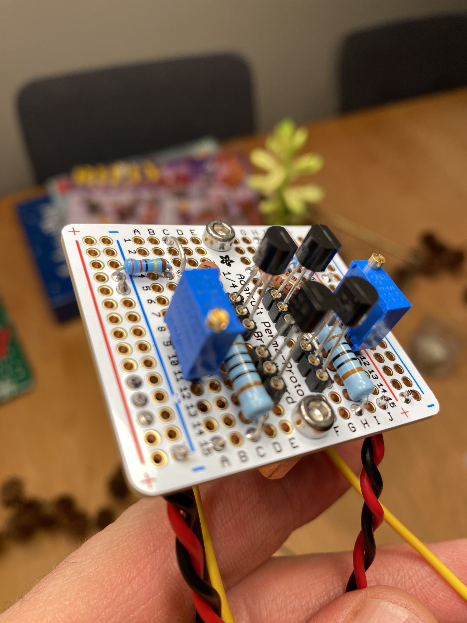

Very cool! It sounds like it would be a fun and worthwhile little project. How does the imaging compare to the WLS?
When I assembled my 2nd WLS preamp, I matched everything with a little transistor tester to get the closer performing components in pairs. However, I didn't try to match the SMDs because I am not a masochist. Surprisingly, things were pretty close which is likely due to them being bought in bulk originally.
My first WLS board that I assembled, I didn't go through that effort. I did not hear a difference. between the two.
For the record: all my transistors on the WLS came from the same reels. I bought hundreds of the big ones, enough of the small ones.
I need to listen more wrt imaging. In a mountain cottage for Christmas. But from the little I have listened, it seems comparable wrt imaging. But remember, I have el cheapo speakers right now, plus the F2J colours the stage with it’s positive phase H2.
But yes, very worthwhile. I did this in between Christmas preps with three kids, and in three days perhaps an hour a day. And it is allready up. So very happy with that, for prototestibg anyways.
Reactions: ItsAllInMyHead
Yup, looks far better than on a protoboard. But it works, that’s at least something :cheers:
