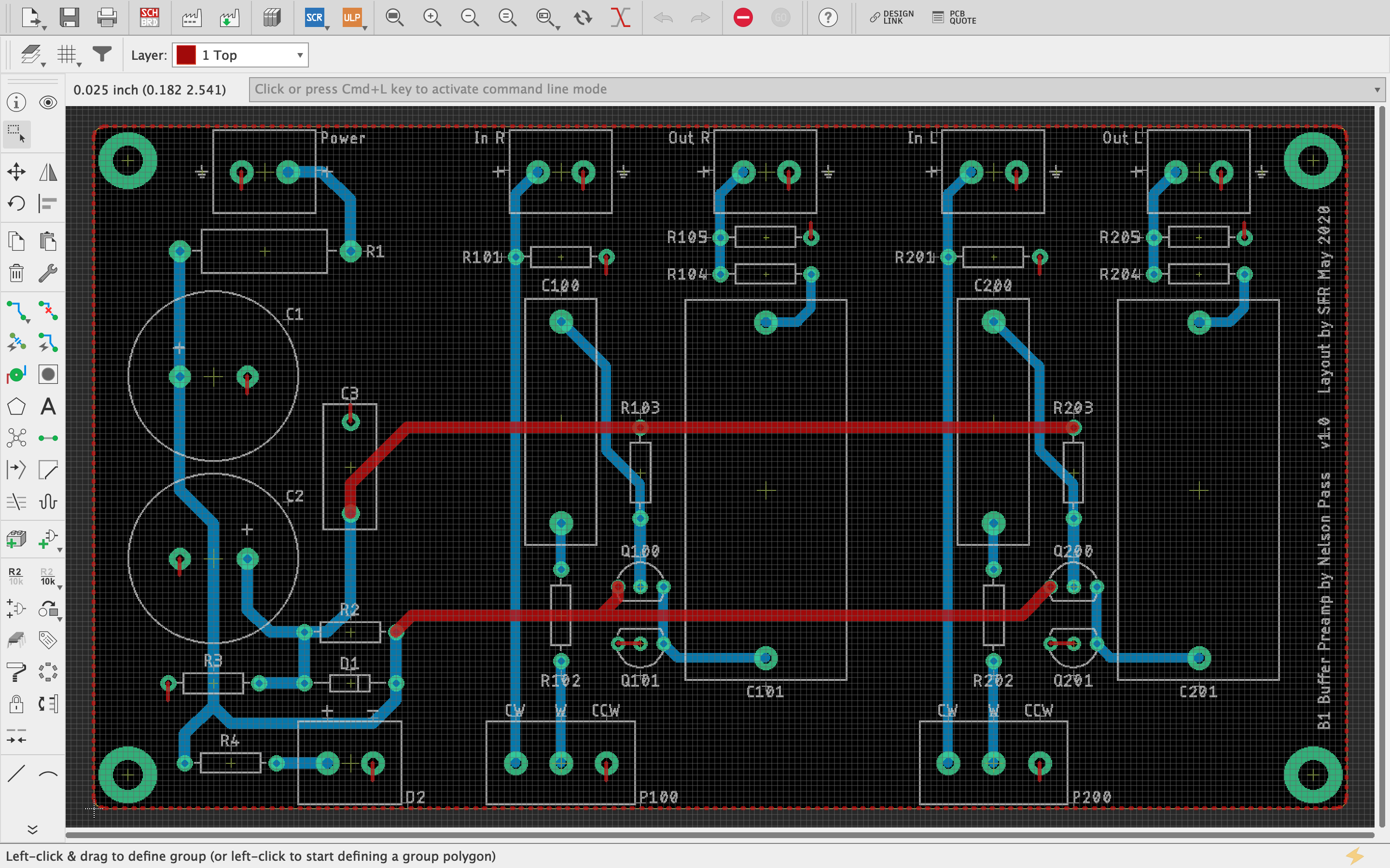

I'm working on a PCB layout for the B1 as a way to relearn Eagle. I've done some very simple PCB's in the past but haven't worked on anything until recently. Would anyone care to critique my layout and make some suggestions if something should be done differently.
A couple of notes,
-C1 and C2 are 10,000uF to save a bit of space.
-I've left out R100/R200 since I will only be using a single input.
-I have all the traces on the bottom layer with the exception of two power traces.
-The ground plane is on the top layer and as uninterrupted as possible.
-I'll be powering it with an 18V wall wart. Since there is no safety earth connection, should I tie the mounting holes to the ground plane like Nelson did with his boards?
-The main concern I have is the length of the input traces running the the pot connections. Could this cause an issue?

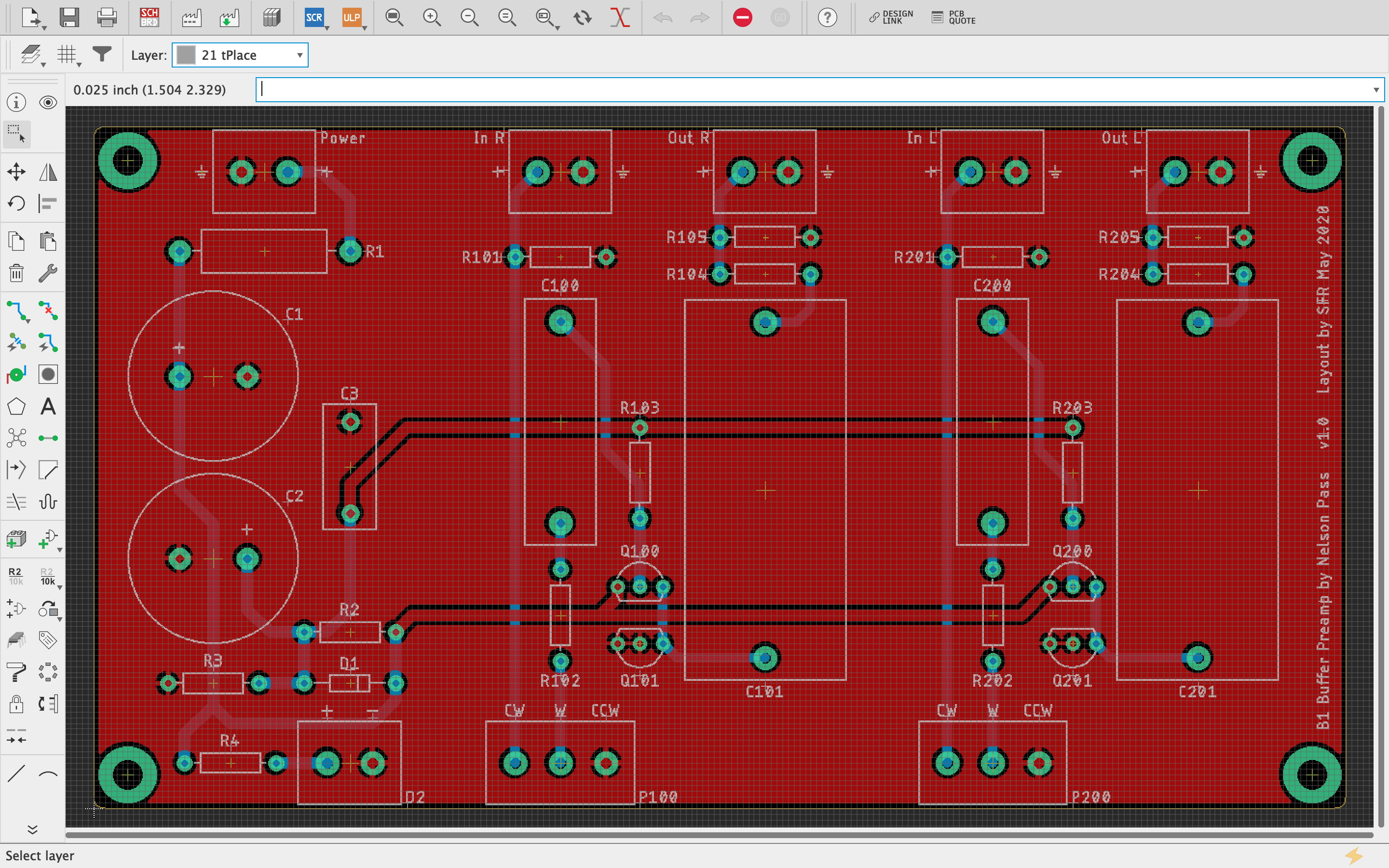

-The wire stubs on the top layer all go to ground. I've left the first photo without the ground plane flooded to show the traces and connections to ground better.
I've attached a couple of images. Any help would be greatly appreciated!

R102/202 is to prevent oscillations in the gate of jfet.
That is needed.
Input should have an input vol control P100 either in the pcb or externally.
Its a must.
If I were you I would supply regulated power from LM317 as used by Papa Nelson in the H2 generator circuit, after the Wall wart. Believe me it will be more silent.
Other than that I havent checked your cct for mistakes.
John.

If less than 10" long input wires could be twisted pairs like in Kat 5 cable.
If more use shielded wire.
Same with output wires.
This is a buffer, wire length no problem, only hum is the problem.

Thanks for the advice. I'll look into adding an LM317. You think this will be beneficial even with a regulated supply?
-Sam
Depends on how quiet your 18v wall wart is!
Any way you have to start with 20+ volts if you intend to use LM317.
If done properly the B1 should he dead silent.
You should not hear any hum when you place your ear in front of the speakers.
John.
