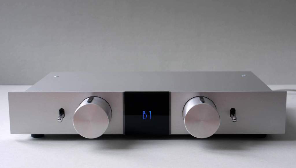

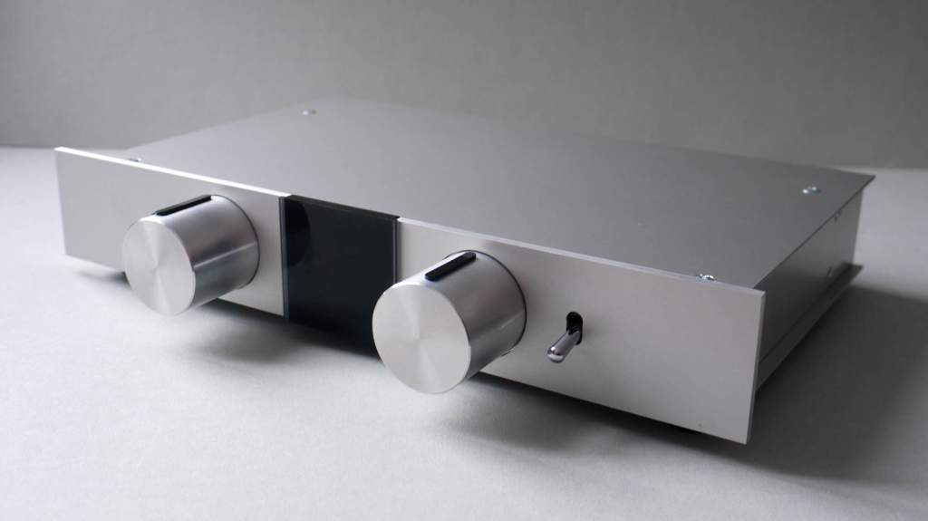

Here are pics of the B1 me and my friend Leslie(brainf) built. PSU is an old Dell PSU.
I have finished a B1 that is powered by an old HP deskjet printer supply. I must say that it was fun to build. This nice little piece sounds astonishing well. For a low enclosure profile I have dislocated the caps off the board.
