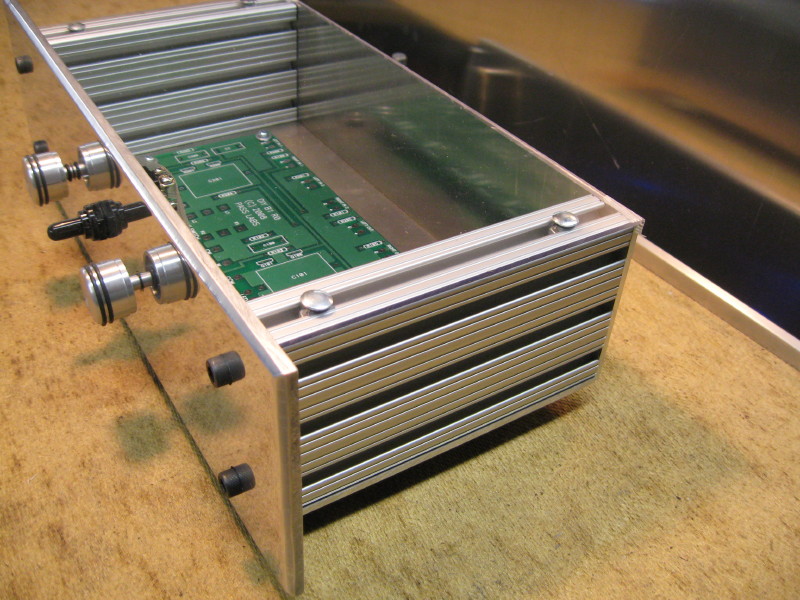

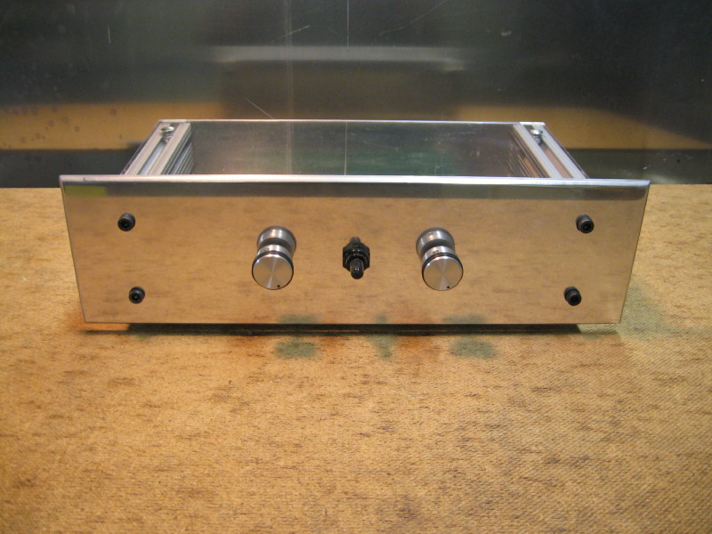

A little premature, on my part. I am missing a couple of components so haven't powered it up but here are some chassis efforts.
I see two knobs, did you use two volume pots instead of a single dual pot?
I didn't think of that, it would have the added feature of balance control.
Yes I did. You can PM me for infomation about it.That is a Good looking chassis,did you fabricate it yourself.
yes, they are Alps mono pots. There was discussion on the B1 main thread about the use of stereo or mono and gain control so I thought I'd use two monos.I see two knobs, did you use two volume pots instead of a single dual pot?
We might be interested as well..... if you can share those info, other people might appreciate. 🙂

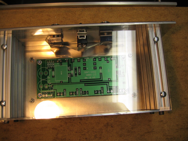

Dear All,
First, I'd like t say that I'm not the most talented and hardest working DIYer, You can call me lazy, I could have made my own pcb and bought the parts individually , But I bought a kit. The only thing that needed more work is the casing . Pix below.
The psu is a 19V switch mode psu from my laptop, located on a separate plastic casing. The connection between the pre amp and the psu is non detachable type. You can see that I use an IEC socket to pass through the dc wire.
The casing I use is a midsized aluminum , with thick panels. It took me quiet a while to make the knob nice when turning, The mechanics of the extension system must be aligned properly to make it feel nice when turning.
I almost forgot to say that it sounds fantastic, The most transparent pre amp I've heard by far.
I prefer to use a 50k pot, I find it sweeter sounding than a 25 or 20k pot, The pot I'm using right now will be change into a TKD pot, As soon as it arrives.
I also opted not to use the selector, Cause after some extensive listening and comparing 2 identical b1 kits (yes I bought 2 kits), I find that the best sound is by directly connecting the pot to the input, Without the selector. The selector I experimented on was a Japan made expensive gold plated dpdt selector, Even the solder terminals are gold plated., cost me $25- . But by doing this , I lost a bit of convenience, But then I use a dac that automatically selects digital sources and I don't have any other source, So this configuration works well for me.

How do you wire B1 without selector switch.
I may do this also.
It's easy, I directly connected the pin 1 and 3 of the pot to the ground and signal terminal respectively , Of the input RCA socket.
