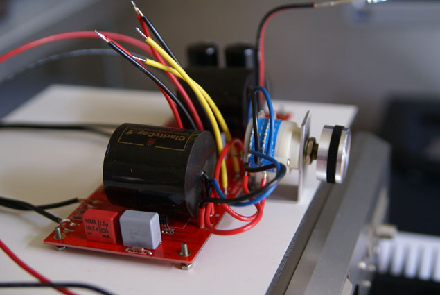

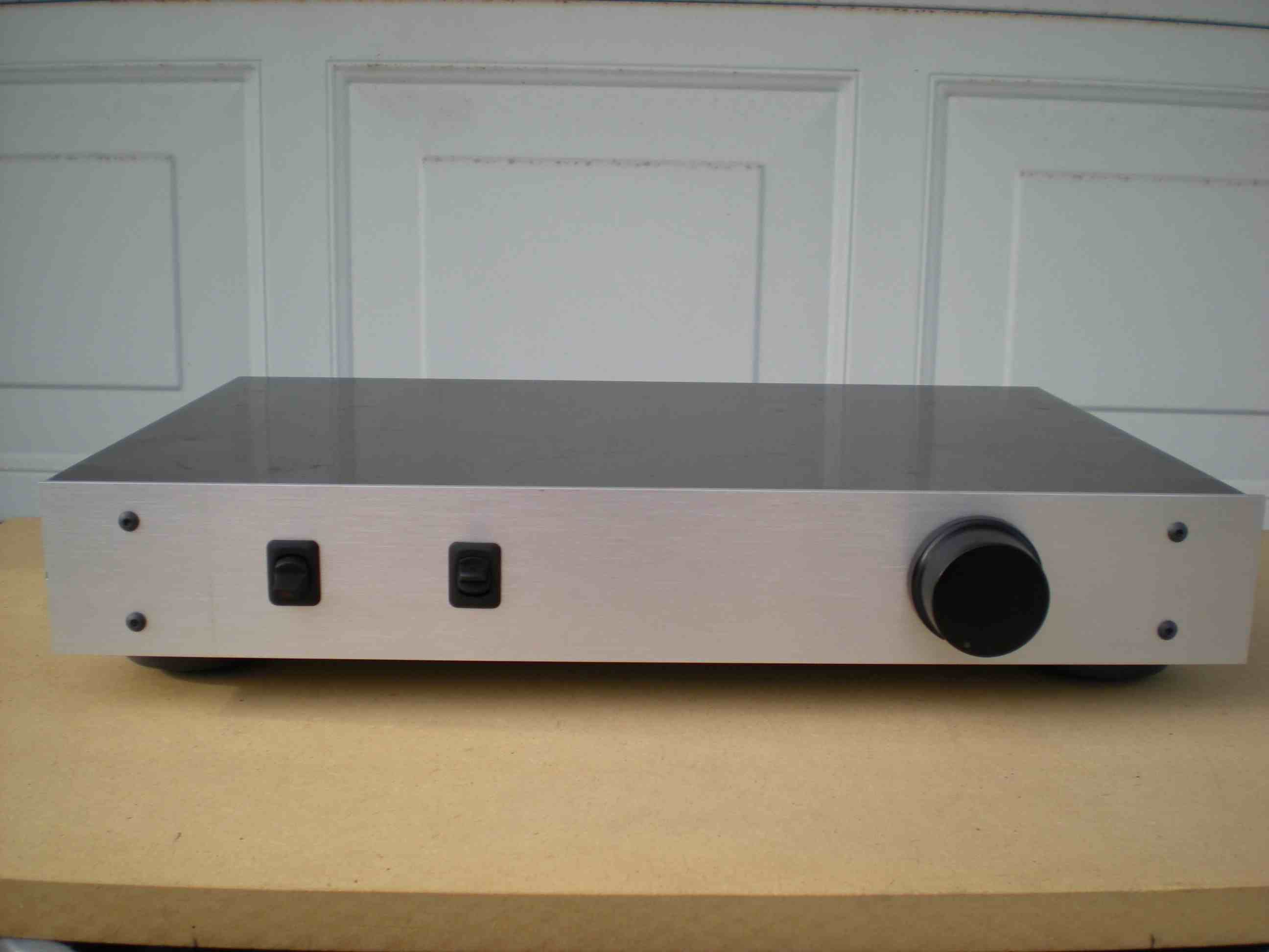

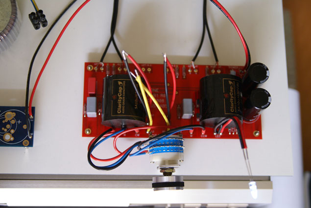

Finally acquired all the stuff to build the B1 - the chassis is on its way.
Went with Vishay CMF50 resistors, Jantzen Z 10uF caps, Vishay MKP 1uF caps, Alps pot, and neutrik NYS367 RCAs.
I finally settled on THIS hifi2000 chassis from audiophonics.fr.
For power I acquired some Dell sockets from ebay and I will use one of the many 19V Dell adapters I have kicking around.
I also went with NKK LED tipped switches - hopefully they end up as I envision.

Nice case would love to see more pictures 🙂 Keep us updated .
Nice chassis, got one problem, my caps are 45 mm alone.
I ordered the Slimline 02/230 silver front 10mm cover 3mm alu.

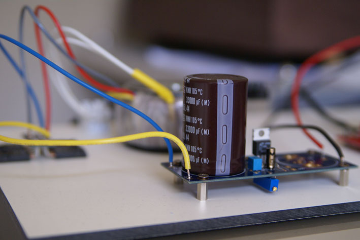

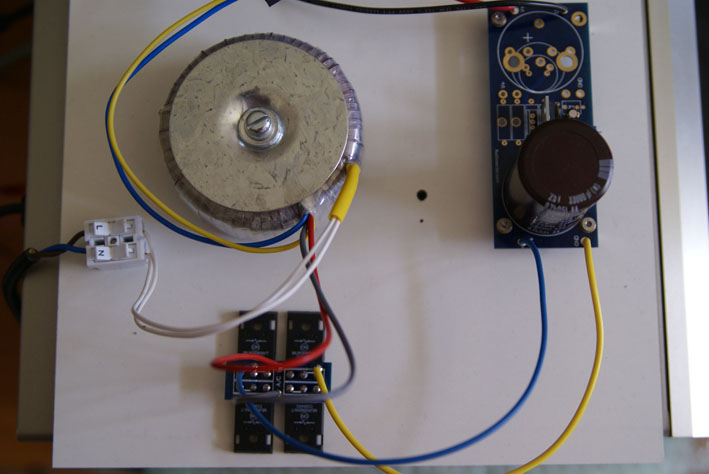

As promised some pic's of the psu.
The blue multi turn pot is a temp, I now know that I have to use a 1,58 K resistor to get a perfect 18 Volts. And again it is somewhat overkill.😉

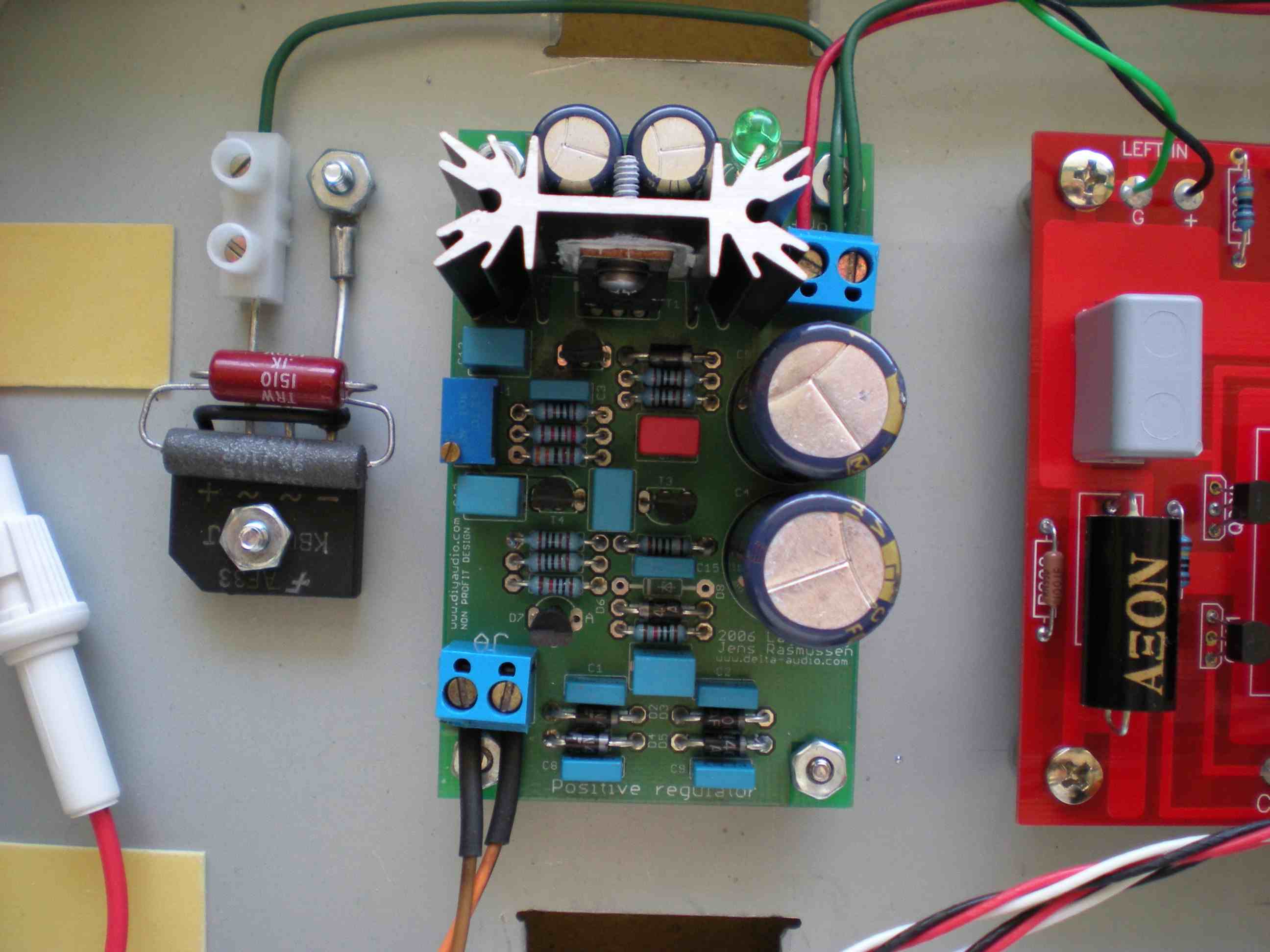

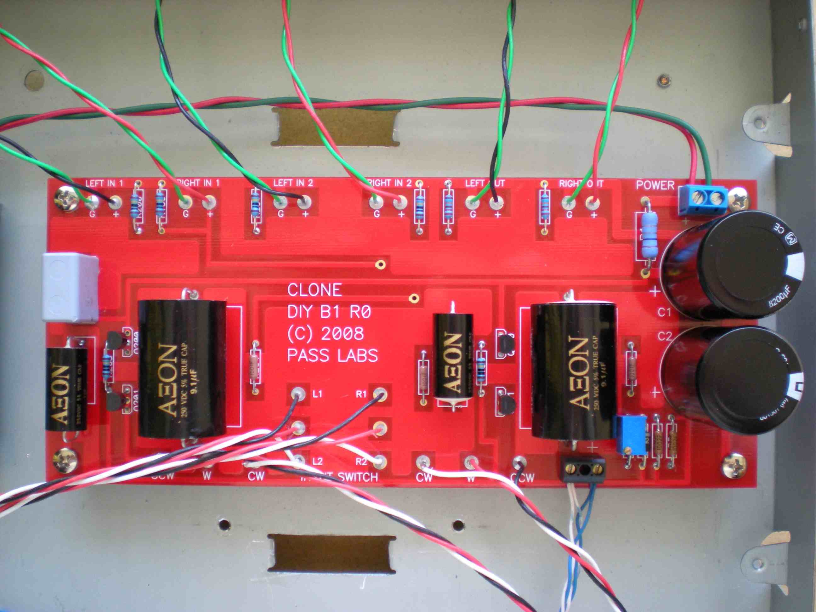

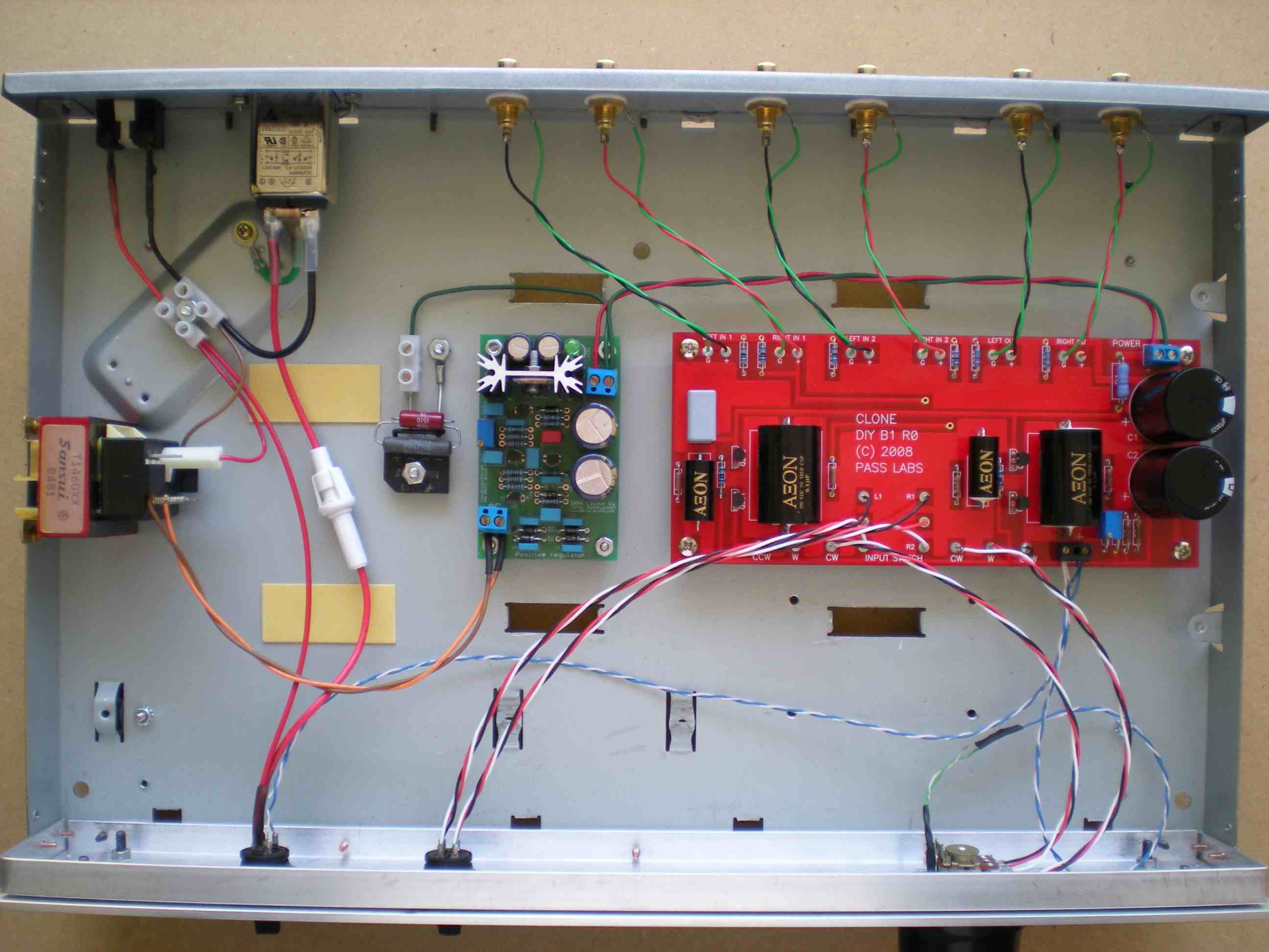

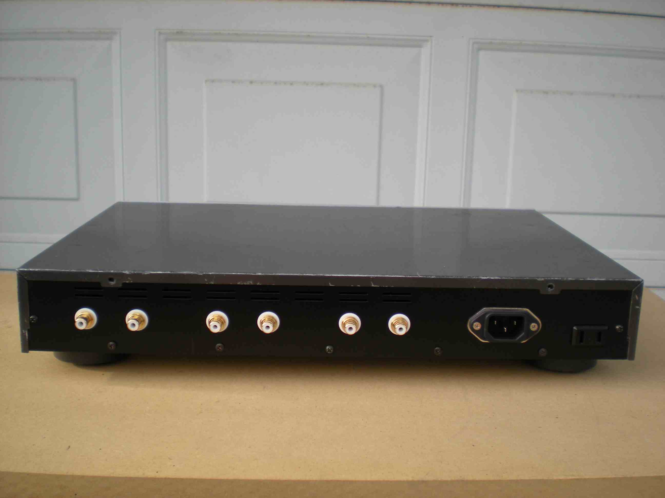

My B1 Buffer Preamp
Circuit running at 18v supply.
B1 board is from Sjostrom Audio, thanks Per-Anders.
Voltage Regulator board is from Delta Audio, thanks Rasmussen.
B1 Buffer Preamp is being used with the following:
Playstation One CD Player with output measured at 0.305 VAC rms.
Elliot Sound Products P101 Amplifier 40V rails with gain measured at 26db.
Proarc 2.5 clone speakers.
System is used in my living room, normal easy listening level is with volume knob at 1/4. Knob at 1/2 is loud.
I'm very pleased with buffer thank you Nelson.

Where did you buy the Regulator board ? Looks nice, nice clean simple layout 🙂
Might hear a difference if you change that pot to a nicer one ?
