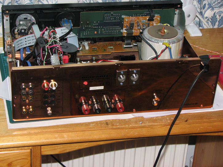

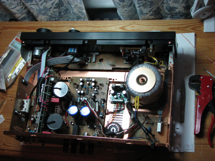

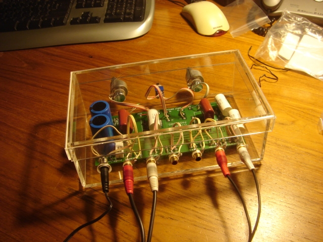

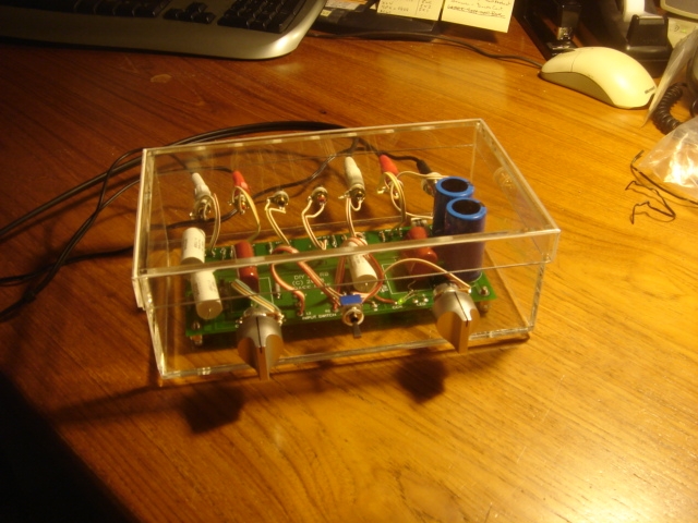

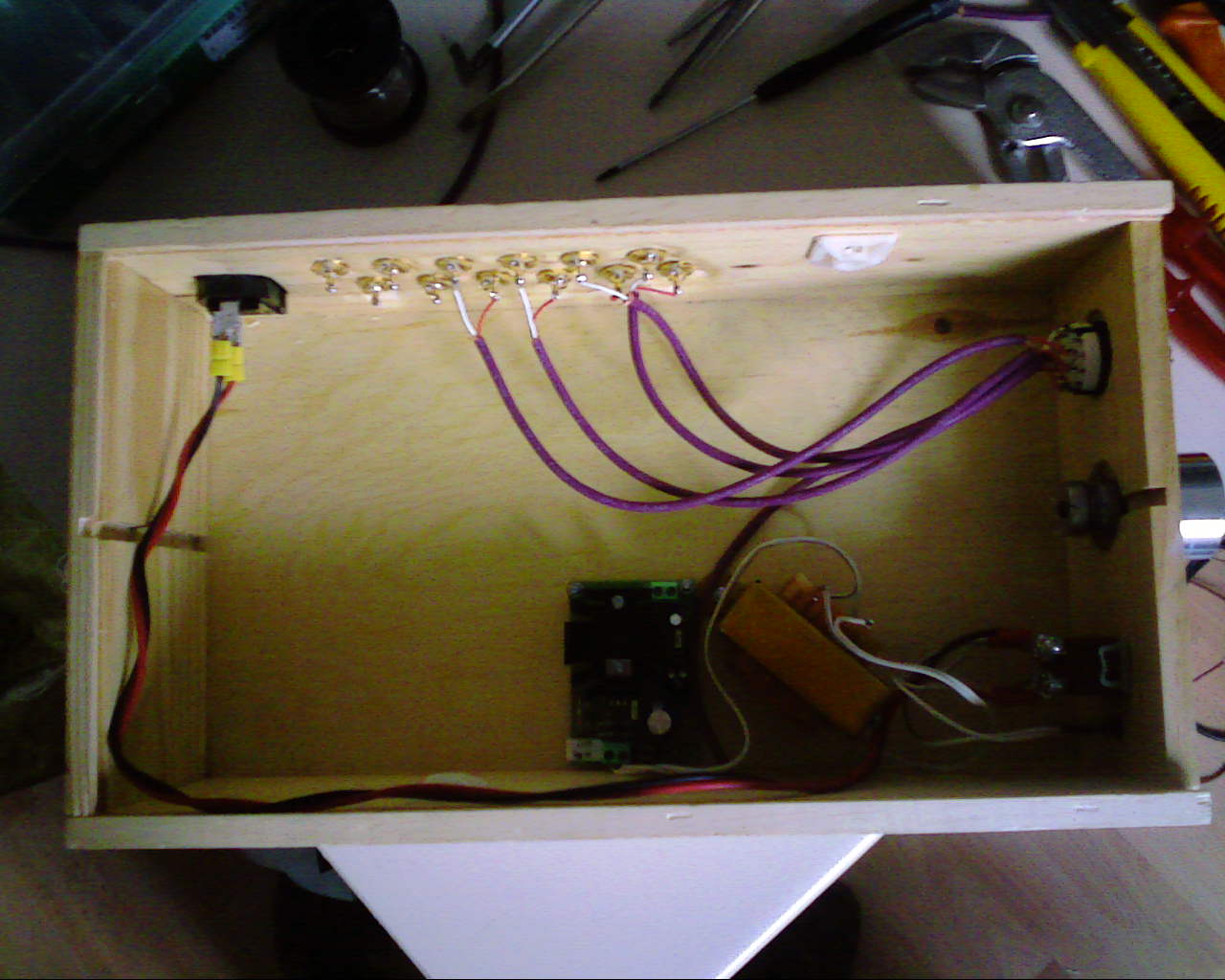

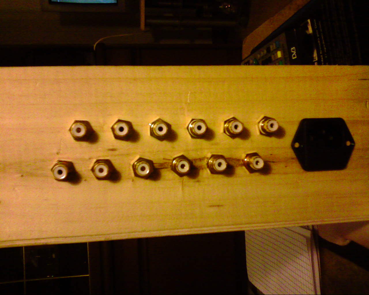

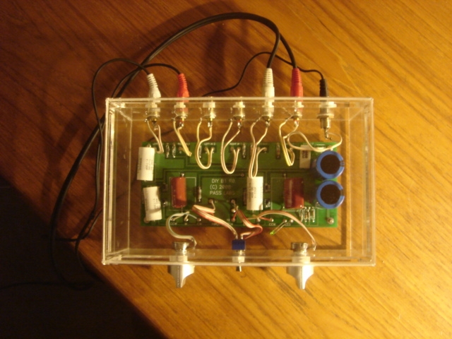

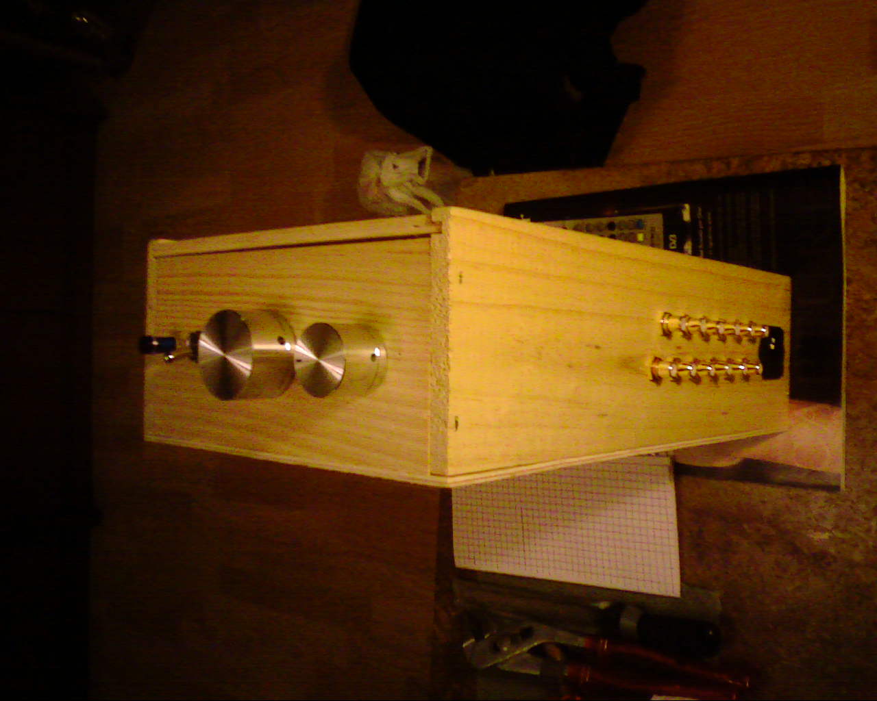

Marantzed B1!
I just finished my B1 using Nelson's boards. There are a few pics attached.
There were a couple of minor problems en route:
1) Several of the components were too large for the board. UK suppliers's problem perhaps? Anyway, it caused me to mount the big electrolytics on the back of the aluminium mounting plate, and set the whole thing vertical.
2) There was a typo in one of the documents (drain to source connection) which could have caused the JFets to reversed... spotted that one quickly.
Apart from that the whole thing was smooth. Using and internal regulated supply it all worked first time.... though I did have to upgrade to a toroidal transformer because of the buzzing from the first standard transformer.
The chassis problem was solved by my local HiFi shop saying they had some "unrepairable" insurance amps to throw away. All that was wrong were burnt out power transistors in the Marantz PM-66SE integrated amp. I took this for my chassis as a bonus got a good cabinet, complete switching, remote control volume and mute. All I had to do was fake the power transistors working so that the mute relay would work.. it was permanently protecting everything. Because of strange voltages (and many of them) used in the Marantz, I decided to leave the original transformer in place. It is vastly more than the amp needs, but it was the simplest approach.
So after all this the result? I have been comparing the buffer to my previous pre-amp, the Pass X2. Generally the sound is more open with better dynamics and somehow sounds cleaner. The detail and stage depth also seems improved. Although it has been excellent I am afraid the X2 is destined for eBay, together with its matching Aleph, as soon as the F5 is finished.
I owe Nelson a real vote of thanks for keeping this hobby going and making it so worthwhile
George

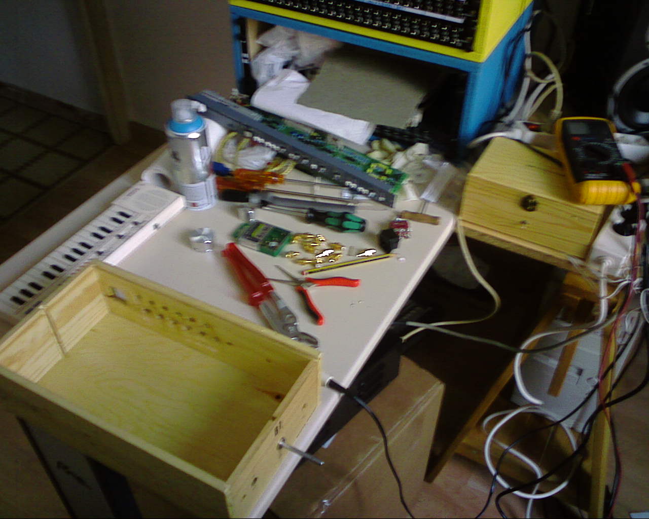

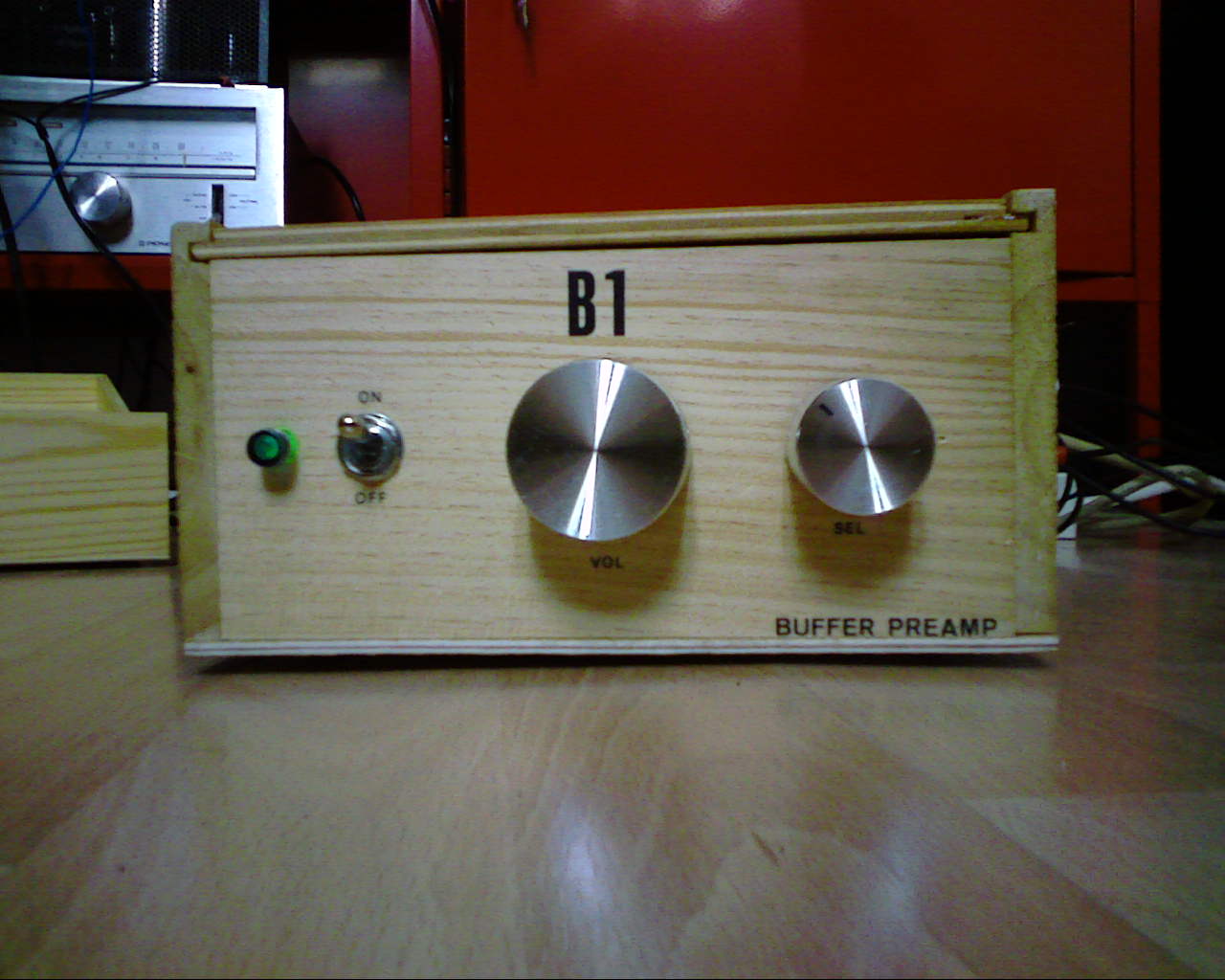

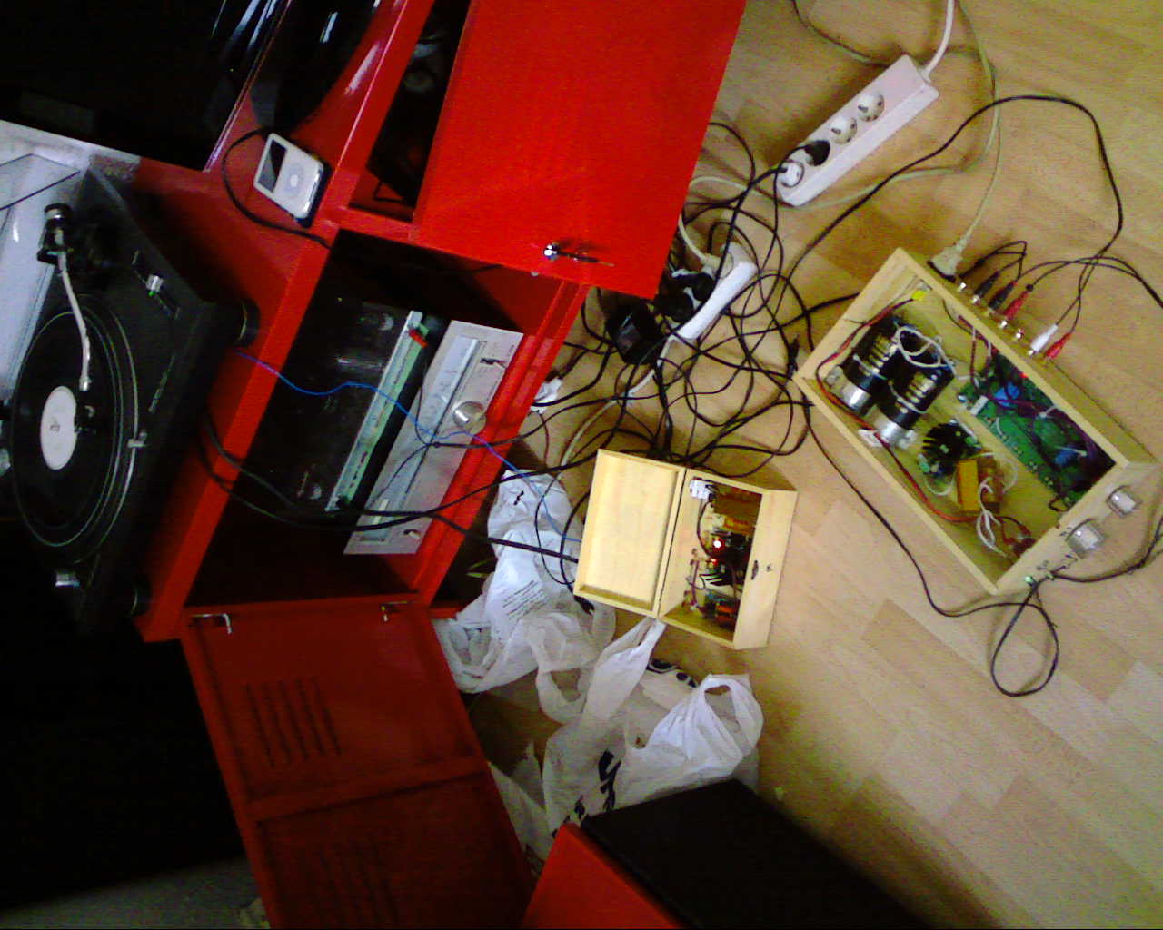

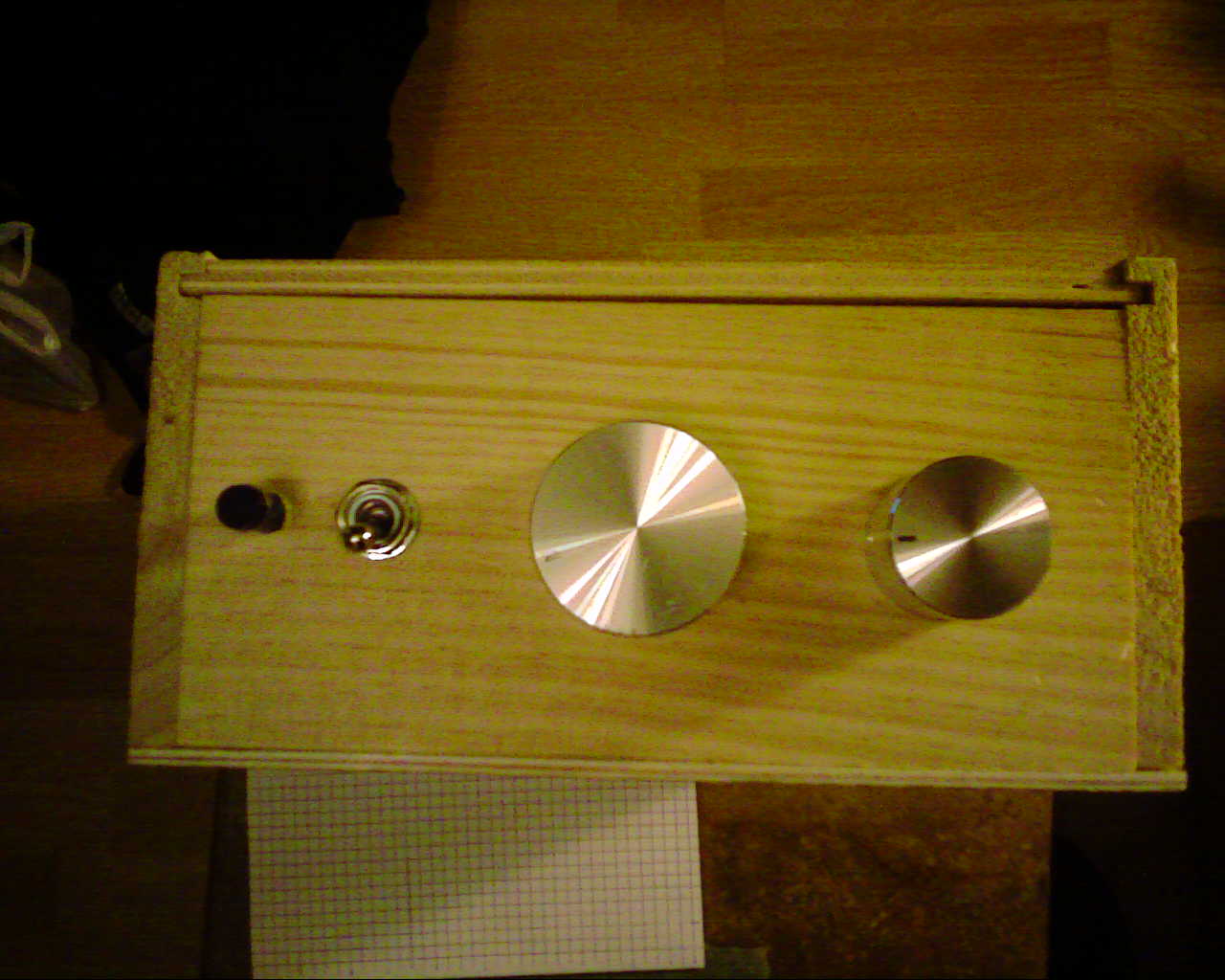

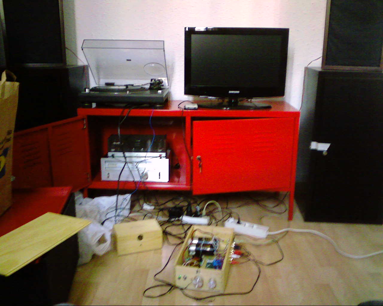

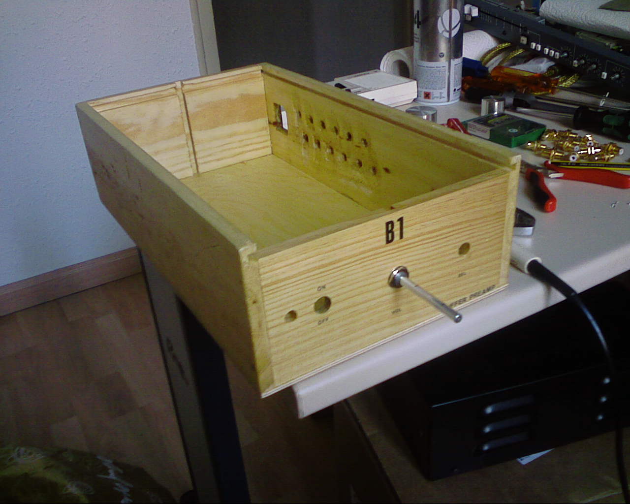

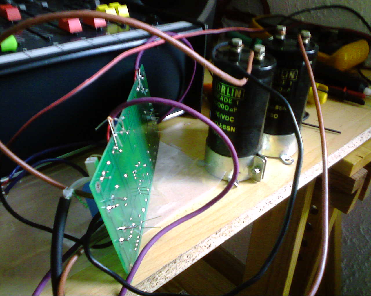

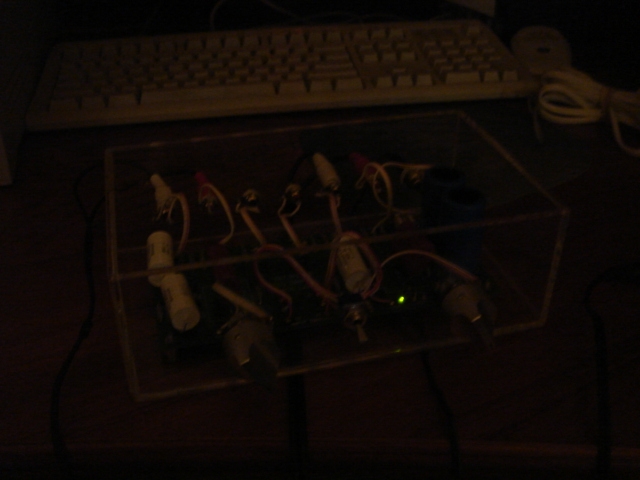

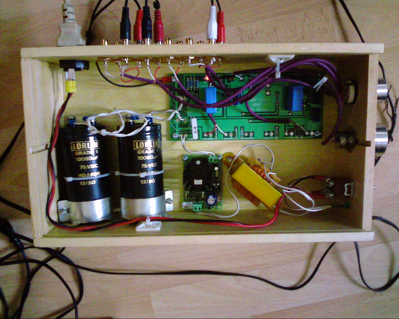

this is my recently built B1 buffer preamp:
