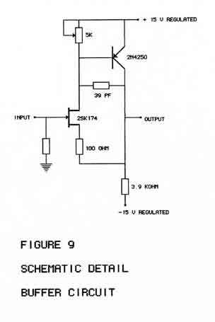

I guess most of you have read this allready :
http://www.borbelyaudio.com/adobe/ae699bor.pdf
but this, I give it once more... nice bedtime reading material..
