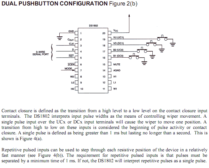

Here is an even easier way to do something similar and yet completely different. This, I think, is my afternoon project sometime in July after F5 and B1 are built.
Dual Audio Taper Potentiometer with Pushbutton Control
http://www.maxim-ic.com/quick_view2.cfm/qv_pk/2778
* Two digitally controlled, 65-position potentiometers

That is what Nelson Pass used in the integrated amp (INT-150).

Where I can find the "schematic" (application) ?
I want the simplest one !

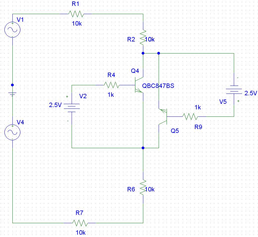

BJT switch attenuator
Hi Guys,
Here is my take on a BJT switch for a nice attenuator. It came to me this morning and i can't wait to wire it up tonight. It should have good BW and no DC offset, the only backside is that one needs two floating switch control voltages that are fairly well matched, the last bit of assymmetry can be trimmed away by adjusting individually for each switch R4 or R9.
